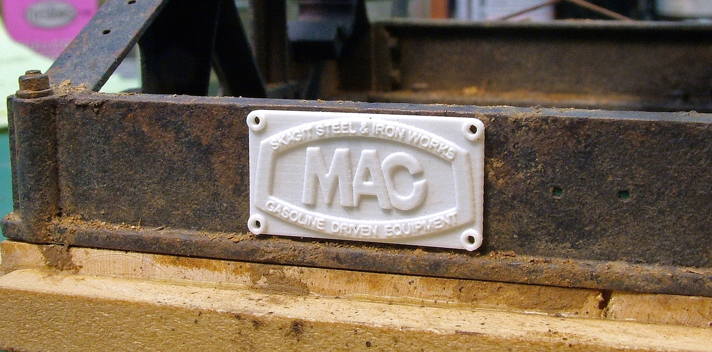

Builders plate fresh from the printer. 16 micron print layers. .375 x .75” (9.5 x 19mm) Letters are .028 high.  True size would be 6” x 12”   This is the same as Shapeways FXD, but this was not printed by them.

Hmm. It looks a little newer than the rest of the model ....
Enough of my nonsense. Do you think the lettering would have worked and looked clean had the height been more like .014-inch?
Posts: 2394
« Reply #127 on: July 22, 2017, 08:29:09 AM »
I did a smaller version, maybe .019 high. The letters were legible, but they were more blobby. The text tool in Solidworks doesn't allow kerning, so I can't adjust the space between letters. If I could it might be doable.

I don't know if you have Photoshop, Illustrator or something similar, but I have had success creating the graphic in one of those programs and importing into, in my case, SketchUp.
Greg Hile (new member, first post!)
Posts: 2394
« Reply #129 on: July 22, 2017, 10:59:55 PM »
Thanks Greg! And welcome!  I need to do some research to see what can be done for Solidworks. I'm sure there is something.

Chuck, is SolidWorks able to import dxf or dwg data? Illustrator exports those files. If you have any vector graphic file of the artwork (as pdf as well) I can export it for you.

Yes it can!. I did the artwork in SW based on a photo of the prototype. It should be possible to do in another program and bring it in.

Chuck, I've been trying out Inkscape, a free open-source vector program similar to Corel Draw. Its .SVG file worked well for getting custom decals with HO scale 2 inch letters printed.
