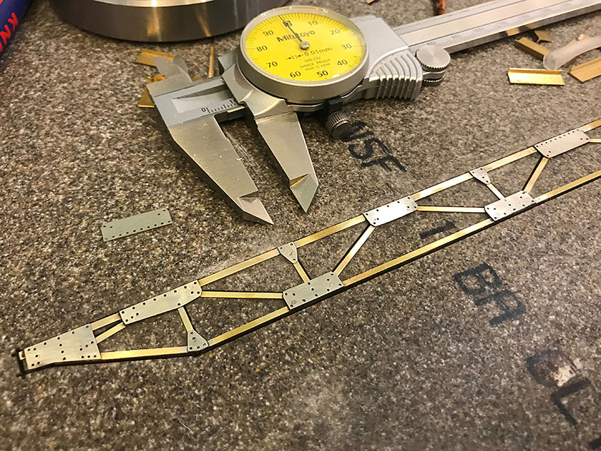

« Reply #71 on: October 23, 2019, 05:26:53 AM »
You  know you have been lazy when this pop up in your most active building thread:
"Warning: this topic has not been posted in for at least 120 days.
Unless you're sure you want to reply, please consider starting a new topic."
But finally an image of some real modelling progress:
This is a girder for the gantry crane. The connector plates are custom etched by PPD ltd in Scotland. I can not praise their etching service highly enough.

5thwheel
Posts: 341
« Reply #73 on: October 23, 2019, 12:24:15 PM »
Will you be soldering those plates w/ rivets in place? Will you be turning the heads with burr or will you have already made rivets? Looks like a lot of work ahead to assemble this.
Bill Hudson
Fall down nine times,
get up ten.
Posts: 885
« Reply #74 on: October 23, 2019, 04:09:43 PM »
Oh, yes there will be rivets!
I use turned brass rivets from several different sources (including Scale Hardware, me thinks). And it is really not that much work.
