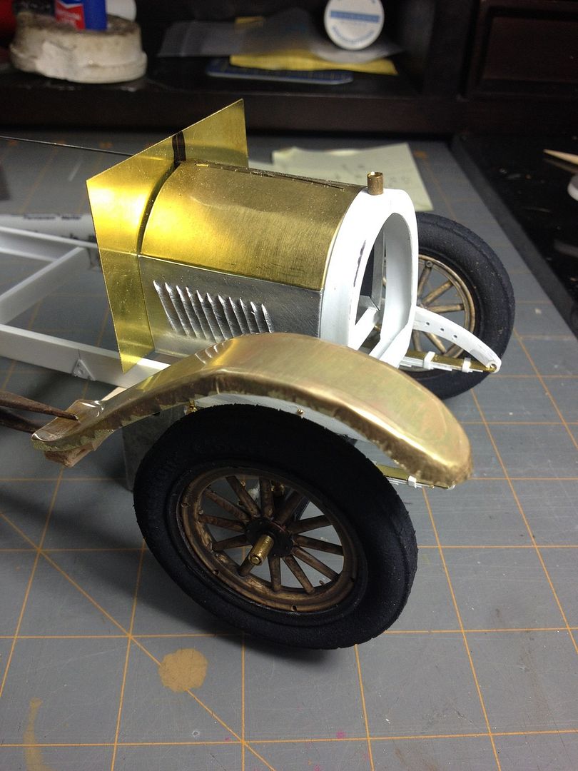

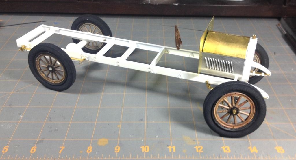

« Reply #17 on: May 03, 2016, 02:10:53 PM »
Moving at a breakneck speed (insert snail here).
I am making some progress.
Still lots to do. Wheels are barely set together just for a picture.
Hoping this will get me going.
I "had" been enjoying the pleasant weather happily making sawdust and shavings in the woodshop.
Summer sure has artived this week so more inside bench time will be happening.
Morr soon (hopefully!)

« Reply #18 on: May 03, 2016, 03:46:07 PM »
Looks good Mr. Jones.  But were does one sit?
Or is this a work in progress??

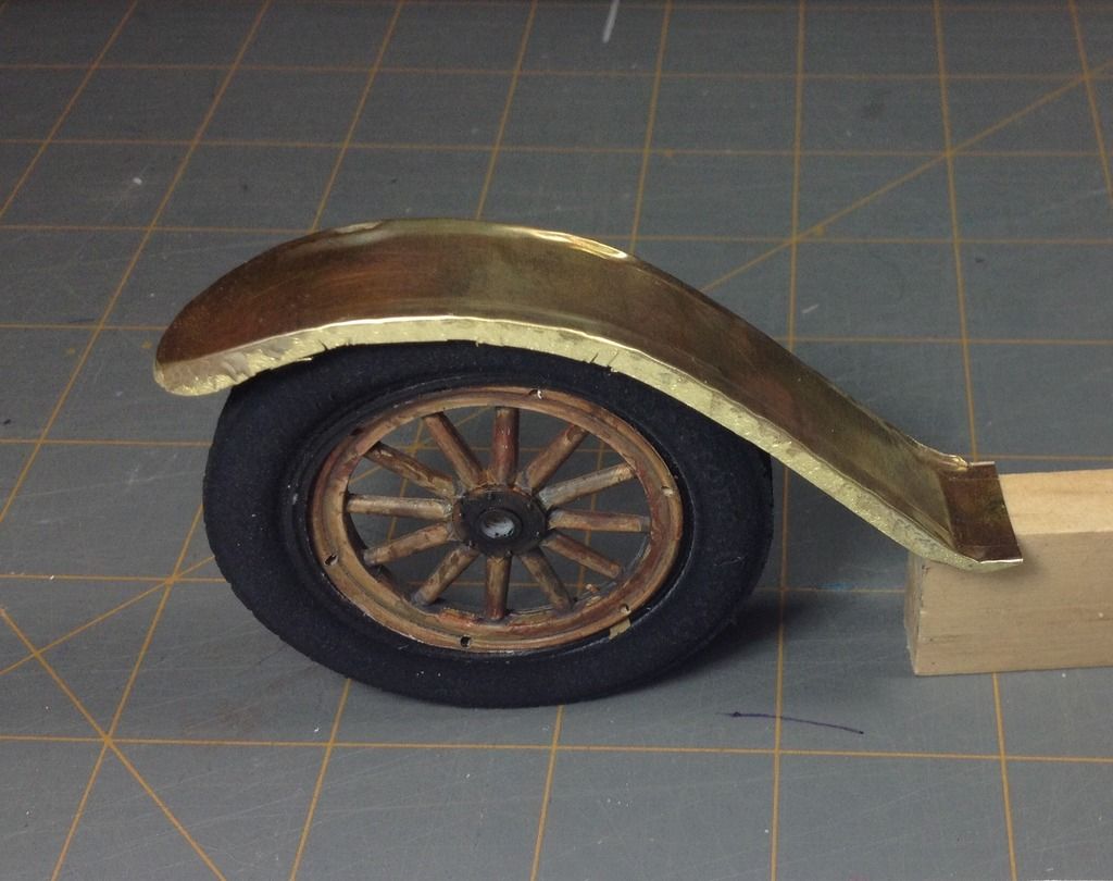

« Reply #23 on: May 15, 2016, 04:01:09 PM »
First try on a front fender:
Second try. Added some padding to the buck (wood form) .005 brass annealed before bending.
Im hoping some solder on the lip will behave like lead body filler.
Mj

« Reply #24 on: May 15, 2016, 07:54:44 PM »
Marty, Nice work!

« Reply #25 on: May 15, 2016, 10:02:05 PM »
That is tricky metalwork. I am impressed. Be sure to post a photo of the completed fender before you prime it. -- Russ

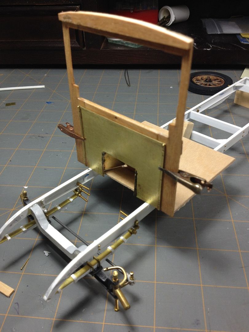

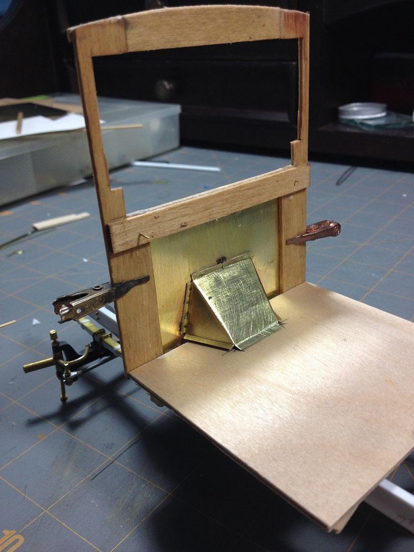

« Reply #27 on: May 22, 2016, 03:28:29 PM »
Thanks guys for the praise.
I'm working on the firewall and the front of the cab.
Lots of wood in old cars and trucks. The firewall and transmission tunnel are brass obviously.
I am having trouble "imagineering" the inner fenders. No good pictures in the net. Hopefully having the cab will help.
5thwheel
Posts: 344
« Reply #28 on: May 22, 2016, 05:15:40 PM »
Marty, I find using old manila file folder stock good for working out my metal designs.  It glues nicely with Elmer's.
