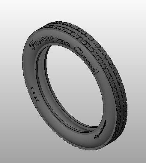

The tiers were too small so I reached out for help.
Volker came to my rescue and drew this;

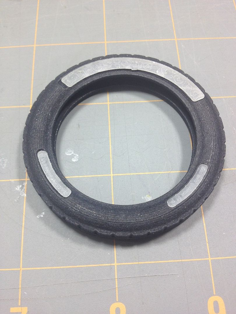

I had it printed in SBF but it was rough

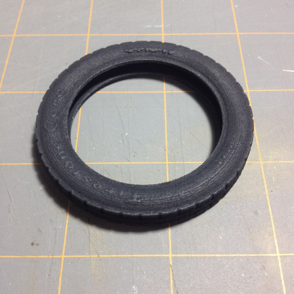

So Volker came up with a different version.
Unfortunately for me I think inserting the FED letters in the cut outs will not work out for me.
I'm hoping with some weathering I can improve the first versions look. After all they are 17 years old as modeled.

A good start, Marty! That first tire does look like it's been sitting out in the sun & weather for 17 years, and you didn't even have to pay/work extra for the effect. Chuck's axle is excellent, looks great in bronze.
