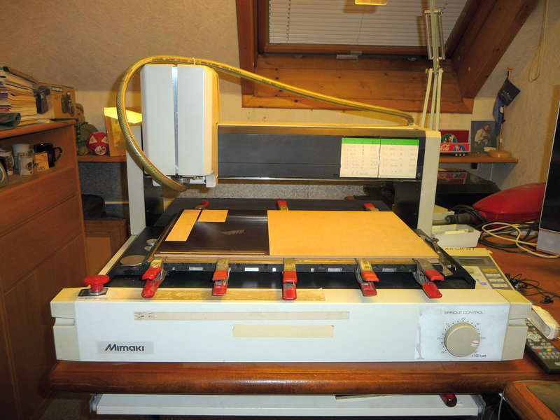

« Reply #11 on: September 02, 2015, 02:28:41 PM »
Hi Martin,
this is my milling cutter really only one engraving for signs that can only 2.5D.
But she is very precise in the CNC 2 dimensions.
Mimaki ME 500
As software I use EuroCut Professional with this software I can draw and going straight to the Mimaki as a plotter.
