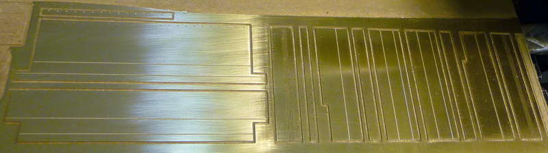

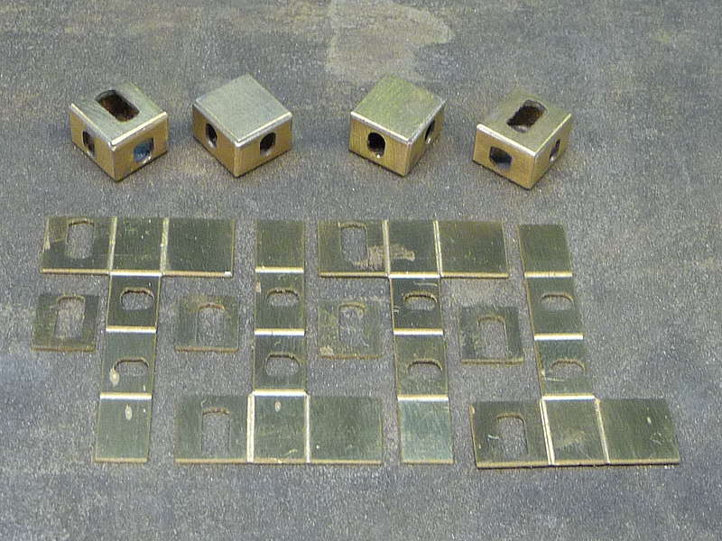

Hello to my project "Klosterstollen" I need a container intended as a section on my model.
The contours of the container corners, I have taken from the drawing and machined from 0.5 mm brass sheet.
The fold lines are milled with a engraver and the MS 58 was annealed before buckling, so that nothing breaks.

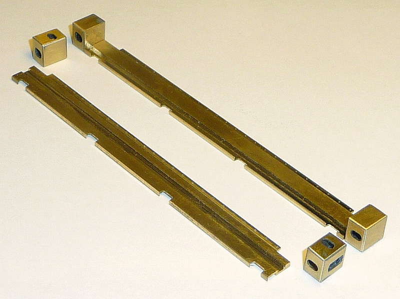

It is also able to produce my first vertical corner profile.
Since it was not possible for me to bend such a profile of sheet metal, I cut it from 2 sides of a 1.5 mm sheet.
Working with construction approximately 12 hours.
So I'm going to every part of what I can produce a milled prepared for my container on.

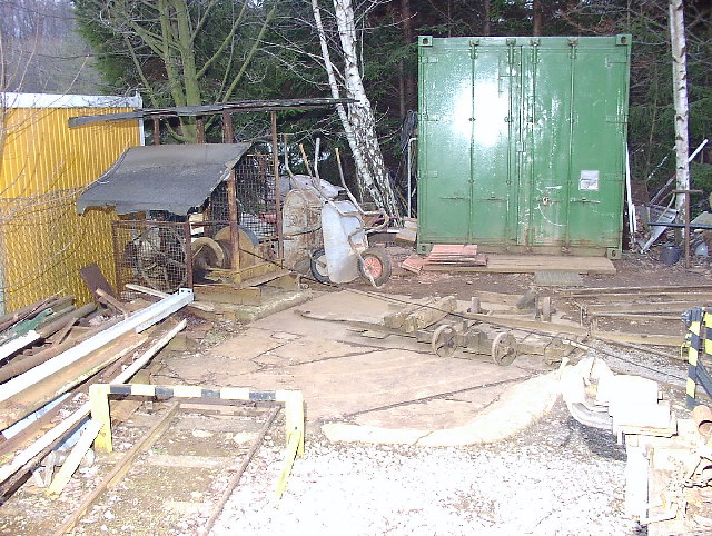

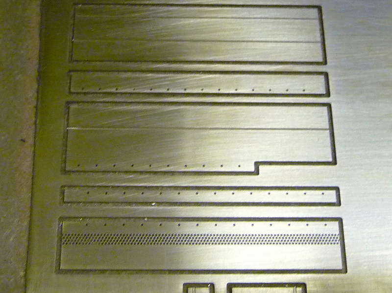

« Reply #7 on: August 31, 2015, 12:51:53 PM »
Hello there,
Unfortunately, my container, because but for a totally different look, nourish.
Luckily he still is so close to me and I can go remeasure him without problems.
Then I was able to construct more parts and mill already.
Everything milled from 0.3 mm brass.

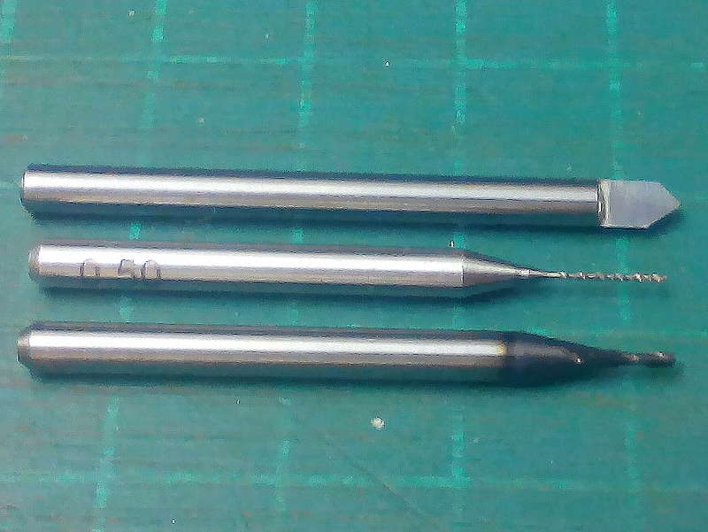

Overall, I already about 1000 pieces introduced my short piece of container 0.5 mm holes in the brass, with only a second-hand drill.
Here to see the use tools engraving tool with a point angle of 92 °, drill 0.5 mm and two milling discs 1 mm.
Now it is time once the missing pieces to construct the sidewalls.
After that, I want only the container assemble to then the doors to be able to build exactly fit to size.

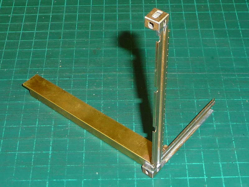

Hello there,
now I was able to turn parts and have soldered a corner to the sample.
Hi Russ, yes I love working with metal, for me there is no better material for model building.

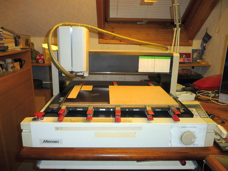

Hi Martin,
this is my milling cutter really only one engraving for signs that can only 2.5D.
But she is very precise in the CNC 2 dimensions.
Mimaki ME 500
As software I use EuroCut Professional with this software I can draw and going straight to the Mimaki as a plotter.

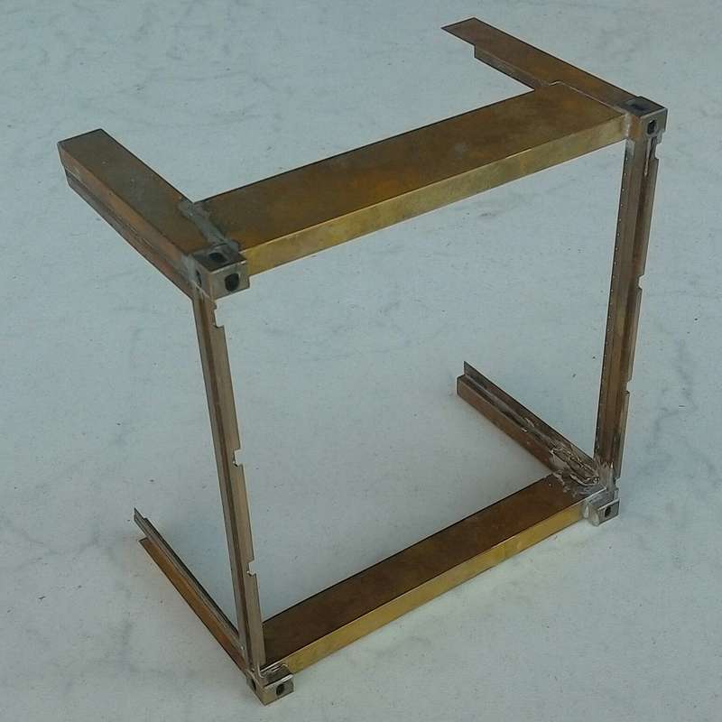

Hello there,
now I could solder the frame of the container together.
After soldering I can clean the frame only in the dishwasher, more will follow later but there also is pending a floor cross member, as a support for the wooden floor.
Wall, floor and ceiling are the prototype of a multi-layer wood panel, so I'm going to make these parts from 1 mm plywood.

No problem Bill, the dishwasher, the usual.
So little acid and as much water what should happen there.
