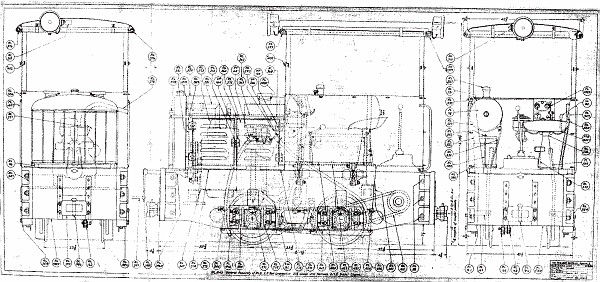

Hi Marty, Russ,
Is it a 7 or 8 ton model? I'm working on a freelance gas loco in 1:35 scale, inspired by the RLD 3.3 ton :
Do you think that it would be possible to print it in 1:35?
Franck

Ours is an 8 ton model, Franck. By the way, I think Chuck has drawn a Plymouth similar in appearance to the loco you posted.
As for printing, as I drew the loco I realized it has many parts too small or thin to print in 1:32 (or 1:35). That is why we have started this thread -- to learn what we can print, what we must scratchbuild, and what we must modify.

Mine was a different freelanced design, but Bill Gould has some gorgeous plans for this (or a similar) loco to the one in Francks plan:
http://www.gouldstudios.com/loco_PlymouthGas.html
If I could render like Bill or Wayne Rayner, I would probably give up real models altogether.

Chuck, if I'm not mistaken, you can buy the 3D drawing from Gould Studio...
http://www.turbosquid.com/3d-models/gas-mechanical-contractor-s-locomotive-3d-obj/542868
Franck
