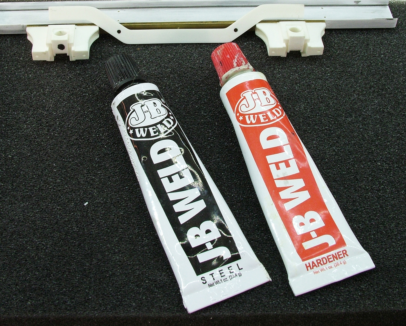

Wow. That's convincing. Do I get it right that seam diameter is approximately tubing diameter or a bit less?
Posts: 1081
« Reply #106 on: December 06, 2015, 06:29:07 AM »
Wow, guess that's why they'll call it "JB Weld(ing seam)" from now on.

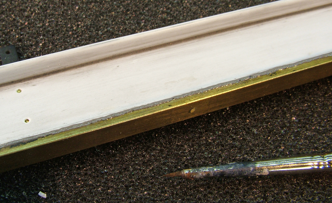

Simply unbelievable! For years the military modeller branch is discussing HOW to do realistic weld seams. And you are simply going to your work bench and are doing the most finest welds I've ever seen...

Awesome work, and a breathtaking realism! What type of JB Weld did you use? The steel reinforced expoy?

Thanks very much! It's pretty rare that something works without a lot more testing.
Here is the weld as it looks when first brushed on with a 5/0 brush. Plenty of time now to go run errands or what not.
This is the product. It is the original JB Weld, not the Quick Weld.
The tube I used for the tool was .046 inch diameter. The weld seam was about .03 inch wide.

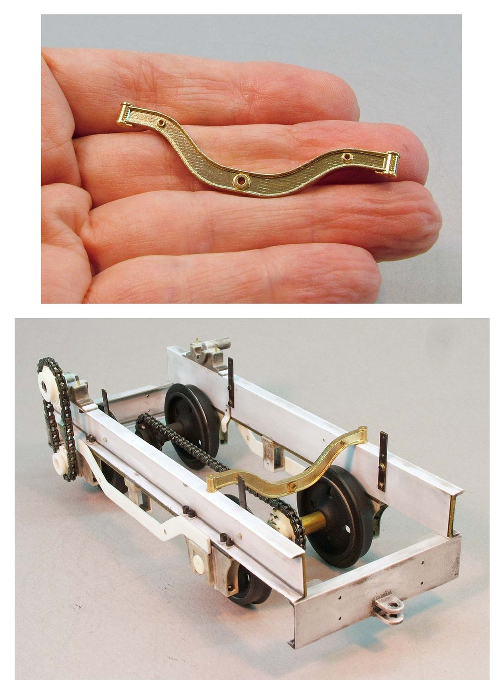

I thought this was kinda neat. The front of the Fordson tractor on my locomotive mounts to the frame using a modified dropped front axle. I needed something strong to support the heavy die-cast tractor, so I had a brass part "printed" by Shapeways. What they actually do is print a wax master from my model file, and then use that to make a lost wax casting. Cost about an hour of my computer time and 17 bucks. Not bad for a one-off custom brass casting. It has some minor layer lines that I will remove and then I will have my first structurally useful printed part!
In the meantime, I have been bogged down adding approx. 40 nuts and bolts to each frame side. Very boring, but I am almost ready to glue the frame together (it is just taped together for the pictures).

Yes, and wonderful, too. How will you remove the layer lines -- by sandblasting, filing, some kind of sandpaper, or what? -- Russ

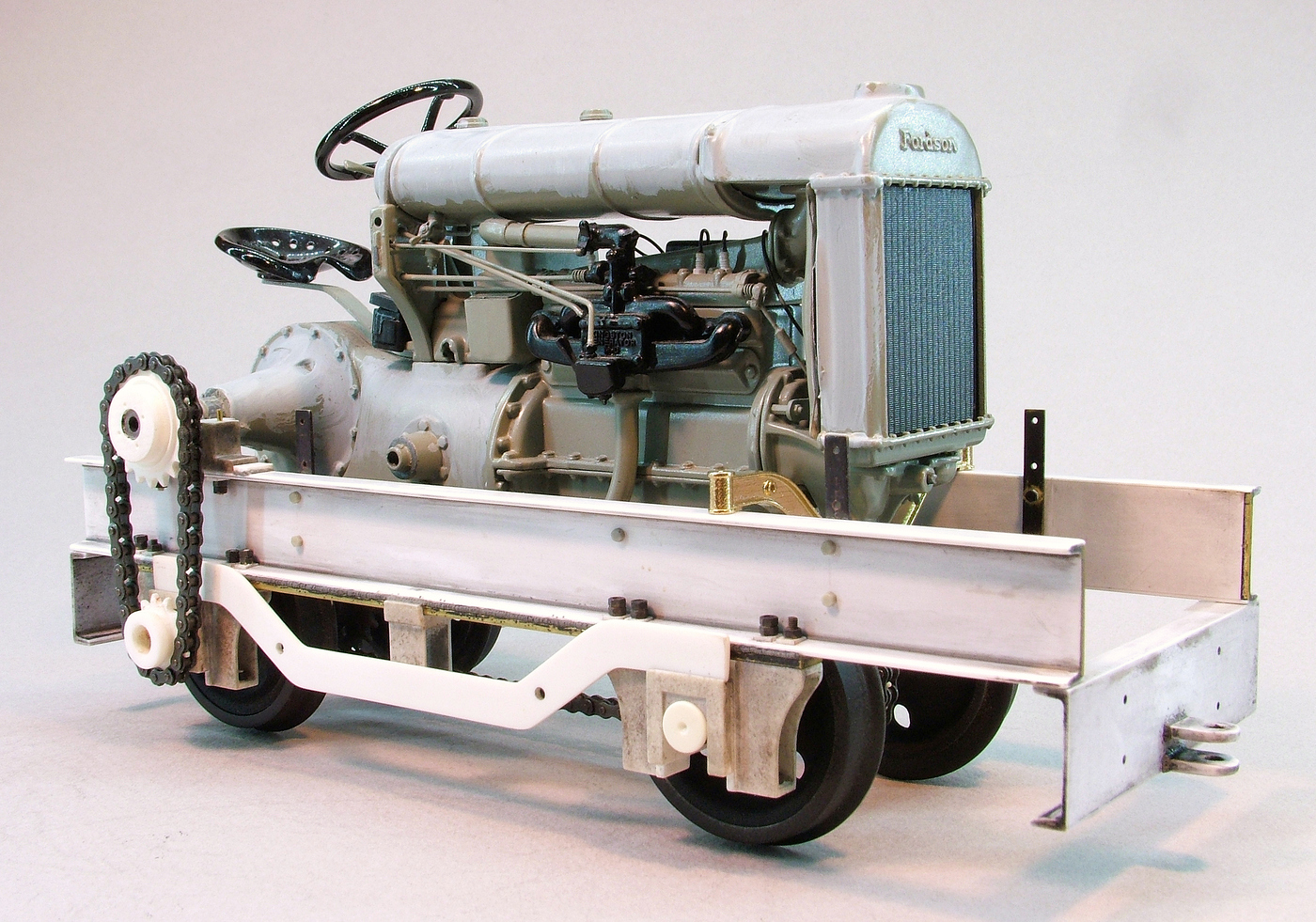

I found myself just once more the thread unfortunately seen by no detailed information about the roller chain, since the dimensions and the source would interest me closer again.

That brass casting looks good (and almost as strong as the toothpick posted previously). I'm curious too how you will clean it up.
Just to be clear about the cost - the computer time was yours? and the $17 covered the wax master and the lost wax casting by Shapeways? That sounds like a good deal.

Russ, I have already cleaned most of it; I used sandpaper and files. The lines are very shallow, but it does take a bit more effort than the FUD material .
Helmut, the chain is made by Kyosho for radio controlled motorcycles. It is 3mm pitch. I bought it on Amazon.
Bill, the 17 dollars is the cost from Shapeways less shipping. I think a very good deal for a single custom part. And they do it all, and the part is delivered in a little velvet pouch. I don't know what my computer time costs. I could never have fabricated a part for that cost, and it would not look as good.

Chuck; how do you attach the front dropped axle to the frame?.....Allan
