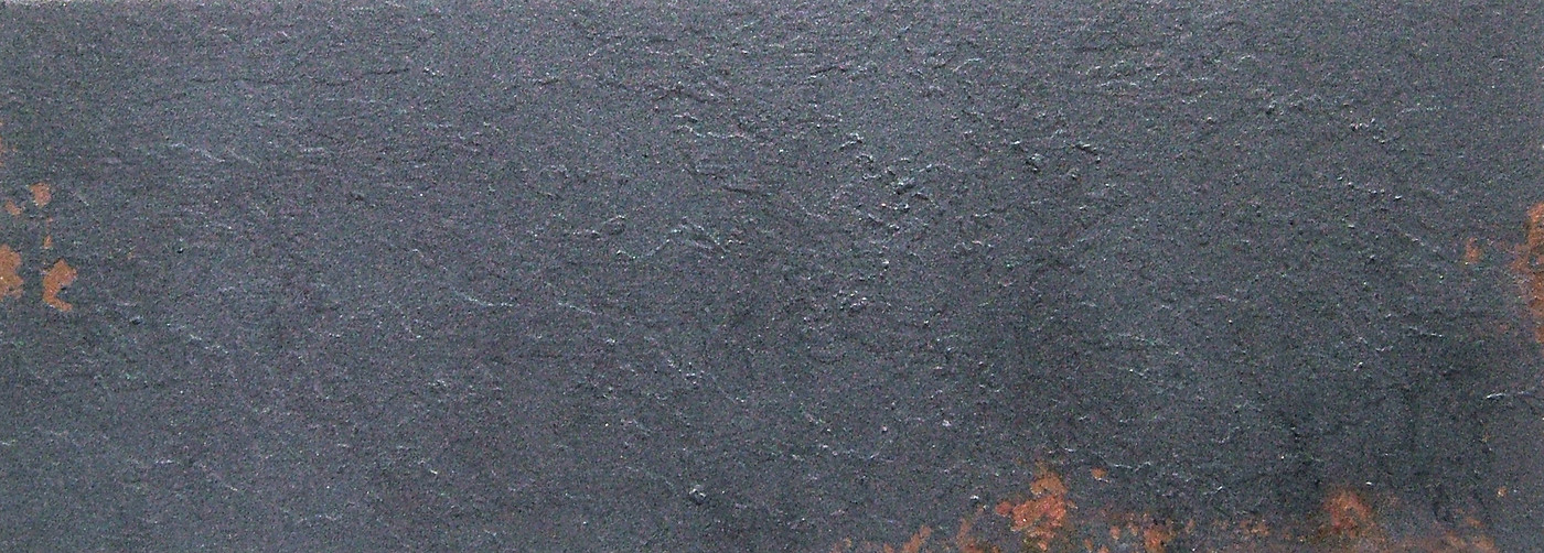

While researching railroad equipment for painting reference, I frequently came across examples of what I will call "topographic layering". This is when a previous paint job is poorly scraped or prepped before a new coat is applied. Often, several levels of paint can be seen under the top coat. There are often brush marks, contaminants and debris in the paint as well.
In the Spring 2010 issue of the Logging, Mining and Industrial Annual, there is a photo article of some small Plymouth diesels. From a distance they look to be in pretty good condition. But in the close-up views, it is clear that the freshest paint was applied hastily and not much time was spent on the prep. The visible layers tell a story of time (and poor workmanship!)
I am intrigued with the idea of doing a similar type of paint job on my tractor locomotive frame. I am experimenting with textures and chipping for now. Eventually I will start playing with colors, tones and additional weathering. I can't say for sure if I will do this, but it is fun to play around and try to copy the kinds of rough paint often found on industrial equipment.
The piece shown is approx. 5/8" (16mm) x 1 7/8" (48mm).  This scales to about 10" (254mm) high in real life, which is the height of my frame.
A bit closer view.
« Last Edit: April 19, 2016, 05:21:52 PM by Chuck Doan » Logged

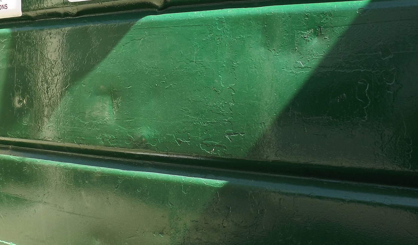

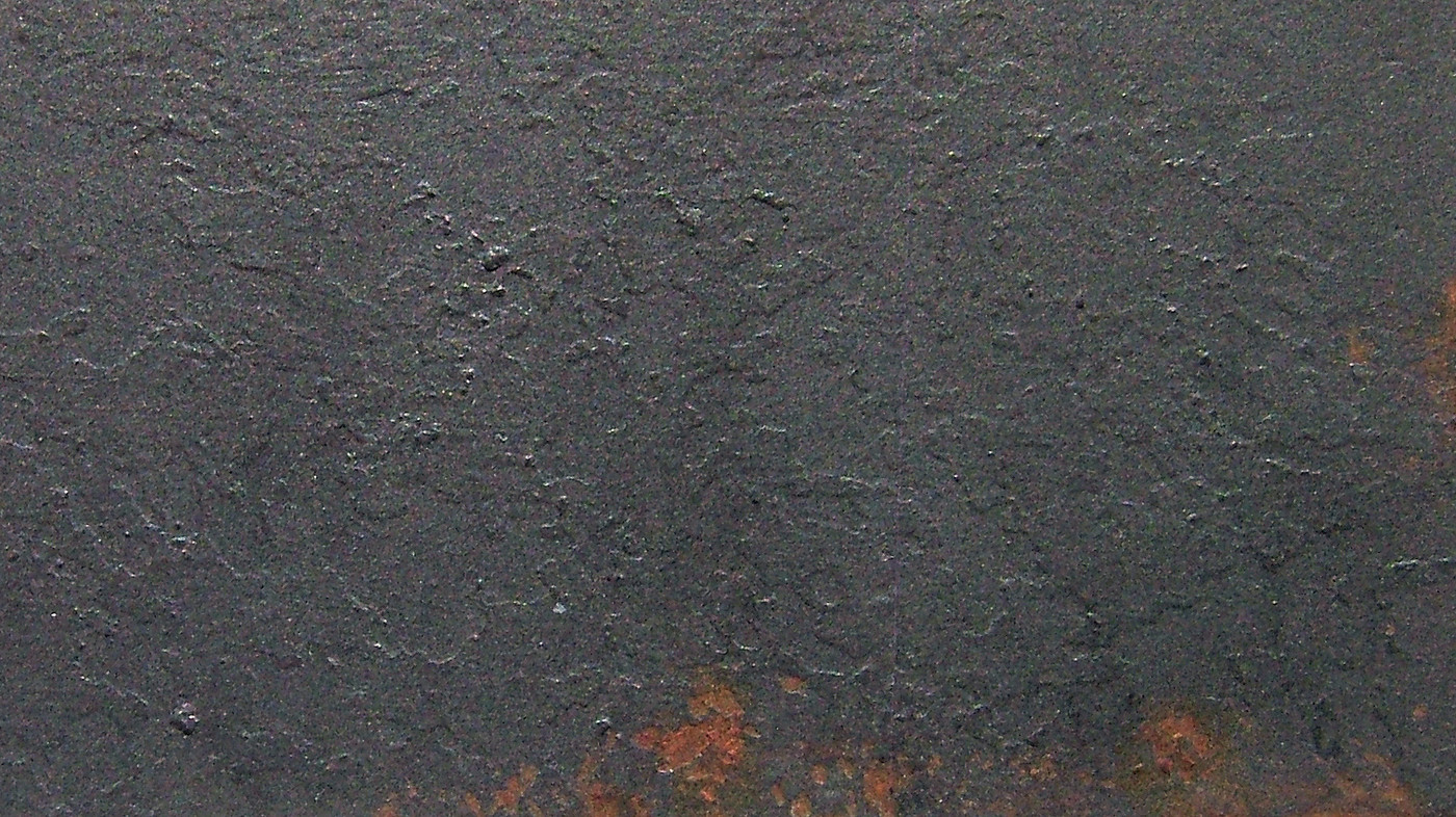

Thanks Dave! The technique so far: First, the Tamiya red brown as a base coat. Then hairspray followed by Dullcoat to seal it. Then light brushed coats of Polly Scale Tarnished Black, then chipped an hour or more later. Then another light coat of hairspray followed by an airbrushed coat of the same Polly Scale paint. I am going to try different shades of Black and grey soon, and some different paint combos. Mostly I have been trying to get the under chips to be visible through the over coat without looking too thick.
A current example:
« Last Edit: April 18, 2016, 10:00:15 PM by Chuck Doan » Logged
