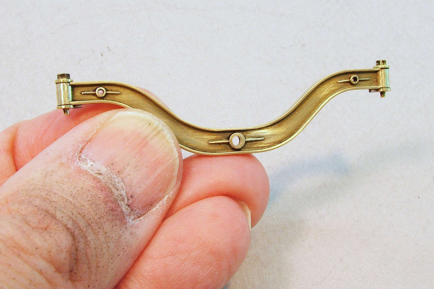

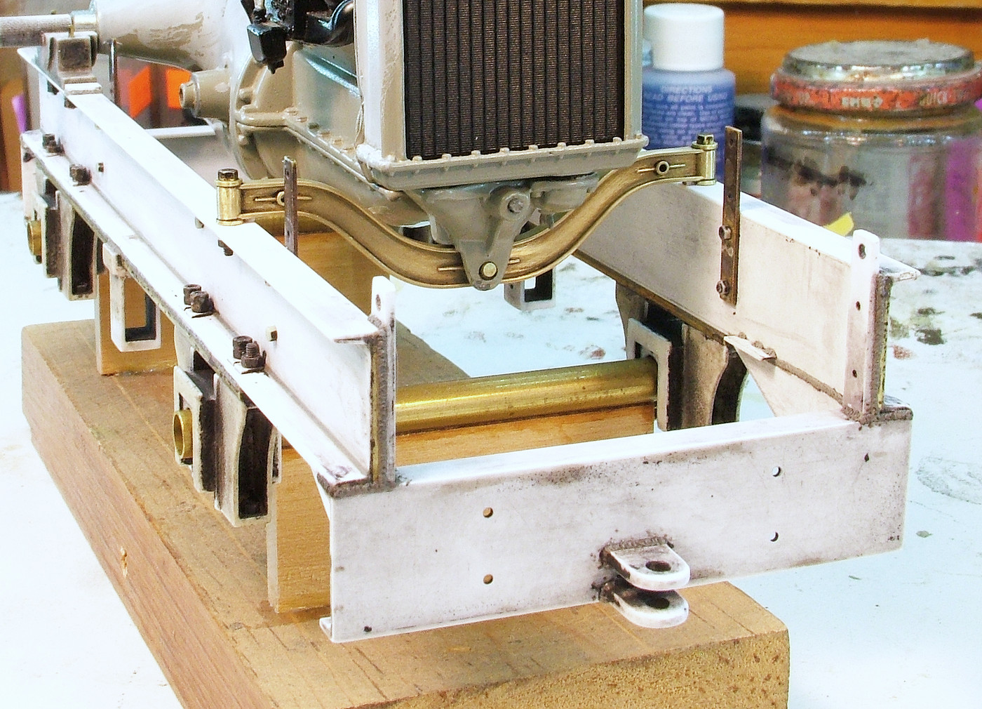

Front mount, part 2. When I had the first mount printed and cast, I omitted the little ribs that the Fordson axle had alongside each hole. This was because they were smaller than the minimum detail size. But after I saw how nicely it came out, I submitted a second model with the proper detail and crossed my fingers. This is how it looks after some sanding and a couple of test primer coats have been removed. I added a couple of 00-90 brass bolt heads to the top, and some pins to the bottom side that will key into my frame.

Wow, that looks fantastic!
Posts: 6221
« Reply #142 on: March 19, 2016, 11:12:23 PM »
I doubt anything could look any better. -- Russ
Posts: 1198
« Reply #143 on: March 20, 2016, 03:50:52 AM »
That turned out well. Nice to see that crossing your fingers is a viable aid for pushing the envelope on resolution Smiley

Thanks! I was pleased that the details printed, and survived casting. I didn't think to factor in any shrinkage, but it seems to fit.

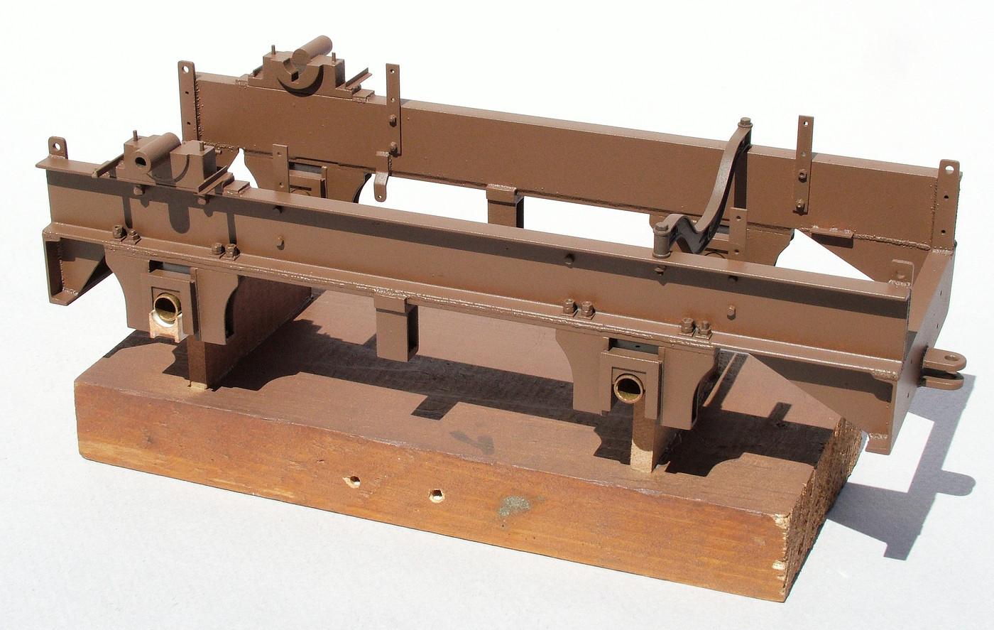

Beginning the scary part. I found time finally to get the base coat on my frame. I used Tamiya TS-1 Red Brown from the spray can. It goes on thin and smooth. From testing, I found that it is impervious to burn thorough from chipping techniques. I am currently testing different paints to use for the final coat.
I built a simple stand to hold the frame for painting and final weathering.

Hey that looks great Chuck!
