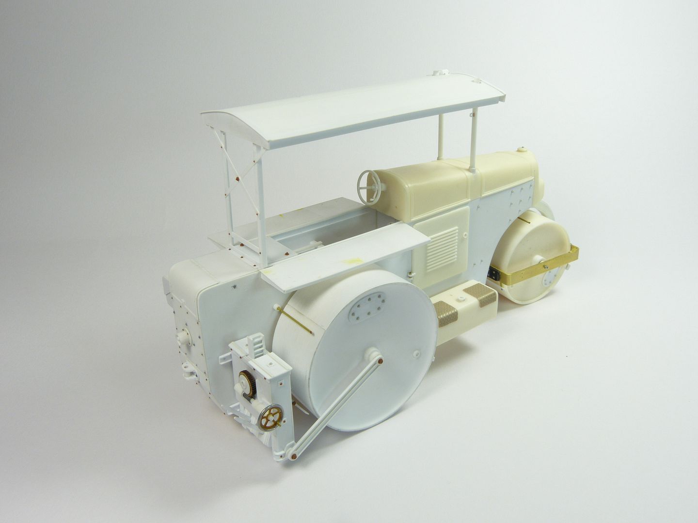

Back on my road roller kick, started this one couple of years ago....... Mind you all I actually did was build a master for one the rear wheels and one half of the front roller. So in response to my unspoken vow to complete a few of my unfinished builds I dug the bits out Jan 1st and got stuck in.

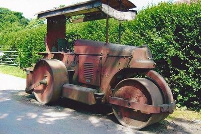

No plan, but some basic measurements are available along with a number of photos and manufacturer's leaflets
The manufacturer's leaflets have some good detail of specific parts of the roller and it's accessories

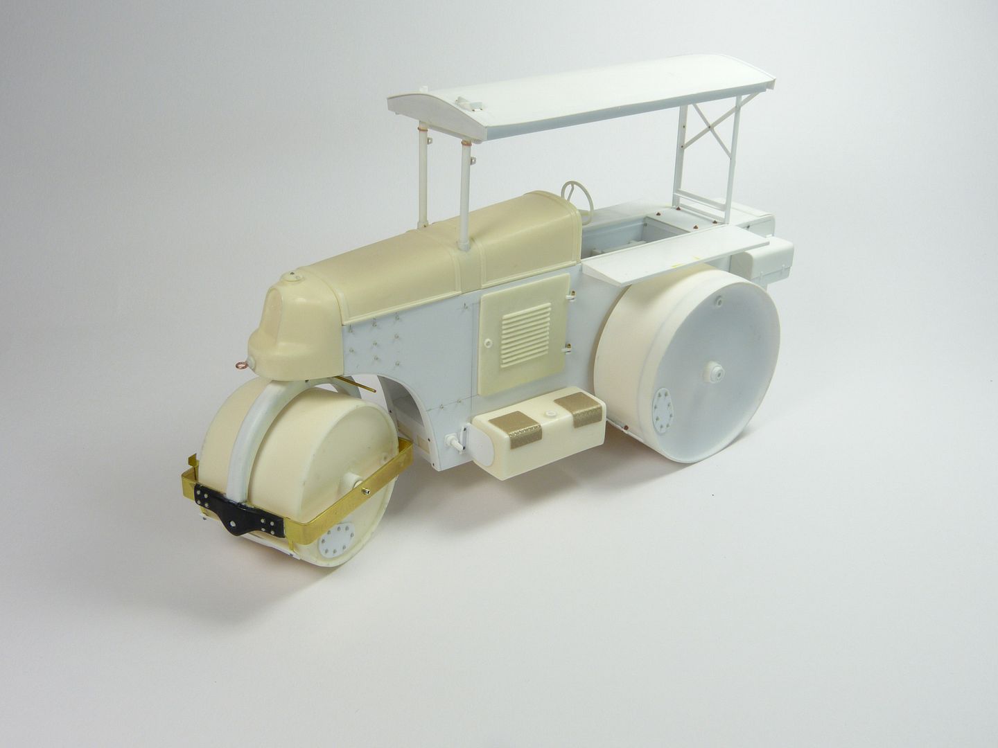

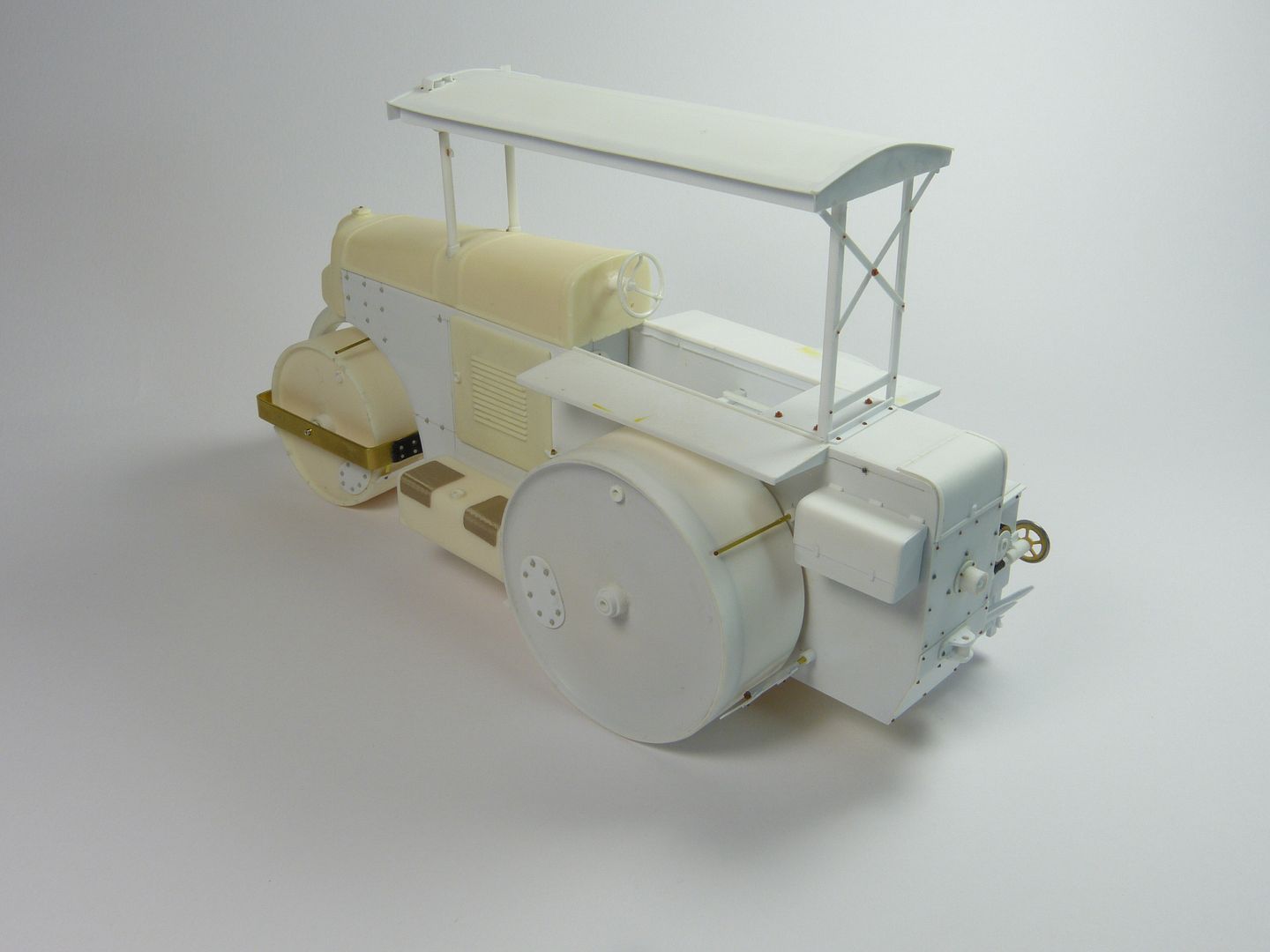

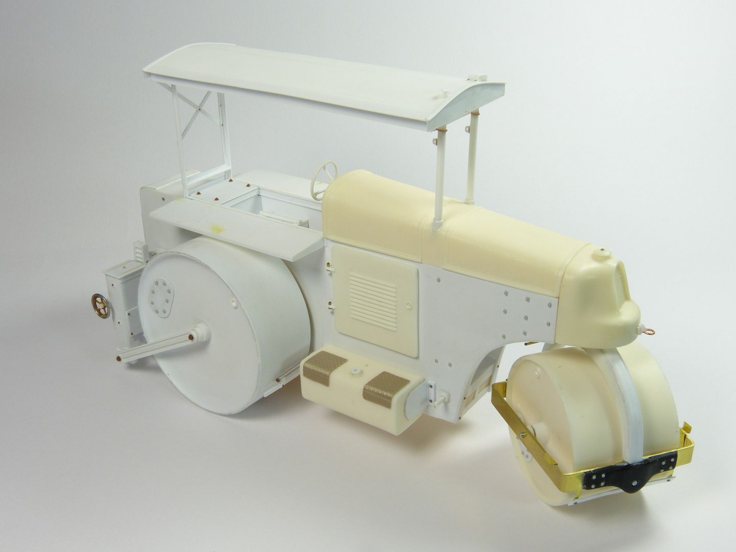

As I hoped to share some of the bits with fellow modellers who also fancied building a version of this I made masters of the wheels, bonnet (hood) and the front nose piece so I could cast copies of these in resin ....... Turned out that while I could cast the the central core of the rear wheels in resin, with my equipment  it did not prove possible to cast the outer rims , so these had to made up with 10 thou plastic card strips. Subsequently I decided to amend the rear wheels so that they had a concave inner surface ..... This was done in the same way as my last roller , a push mould heated plastic and then the plastic cut and trimmed to fit inside the rear wheel rims
So this is the completed build ...... In the raw as they say
As the drivers compartment is some what narrow, decided to build and paint the required bits  separately and add them in place at the end.
This is where I had got to a week or so ago, the models has now gone thro the stages of primer and initial undercoats so hopefully you should see the next stages of paint in a couple of days

Looking very good Gordon.
How did you manage the compound curves on the nose piece?
Rick

Helmut, I thought I had moved into the big league with this model and my "strip of brass"
Ray, "nose" is just flat plastic, some tube and a series of applications of Milliput smoothed with water and some careful sanding
