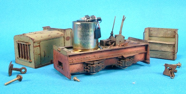

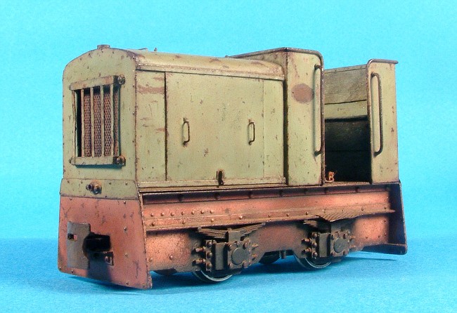

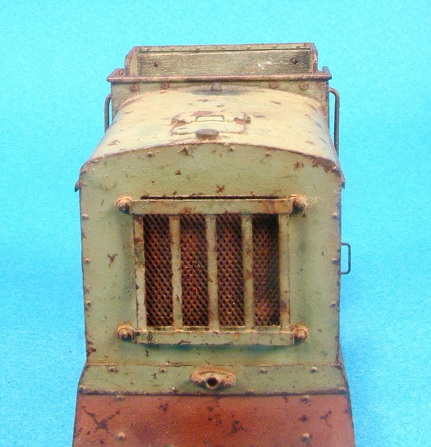

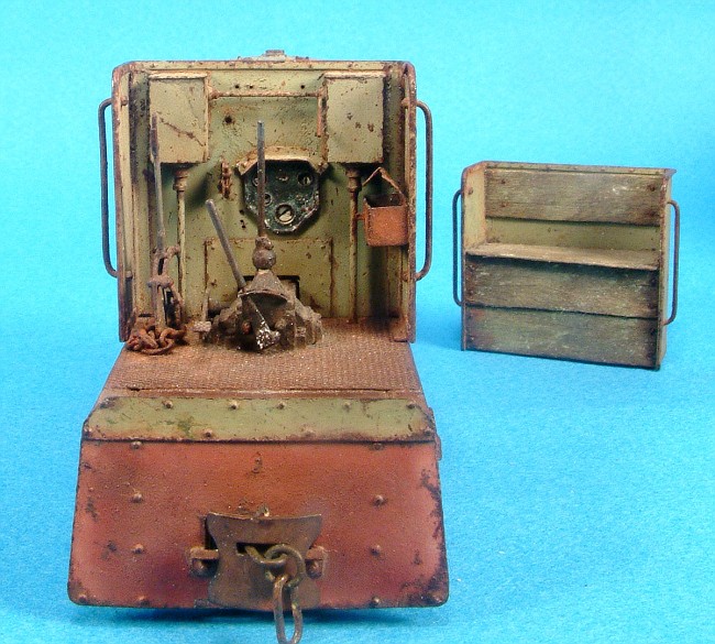

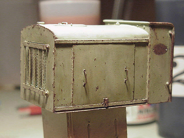

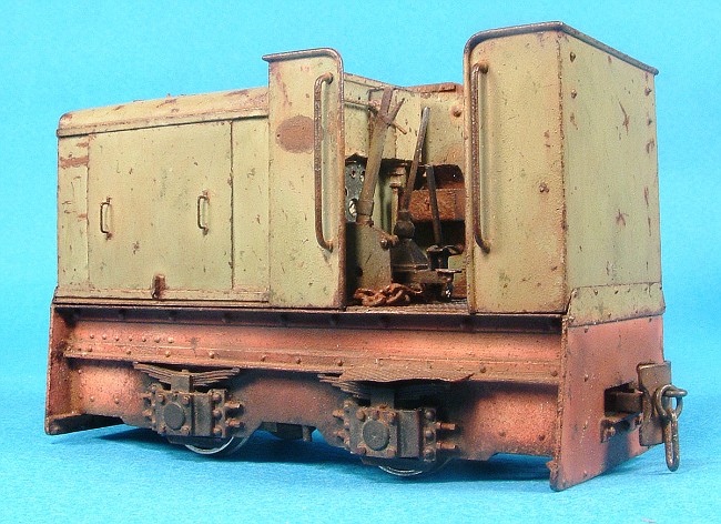

Kevin, you are right it's my Gmeinder!

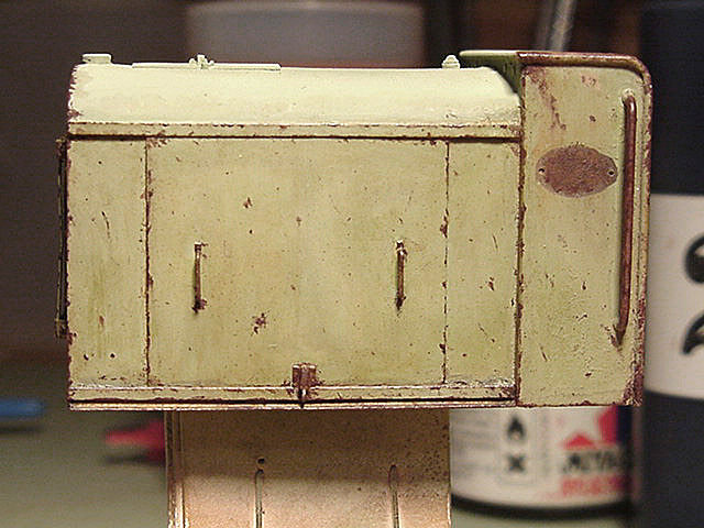

Marc, of course you can copying the idea of the missing builders plate! I would be very proud...And for you some old pics (sorry for poor quality) took during painting operations builders plate...

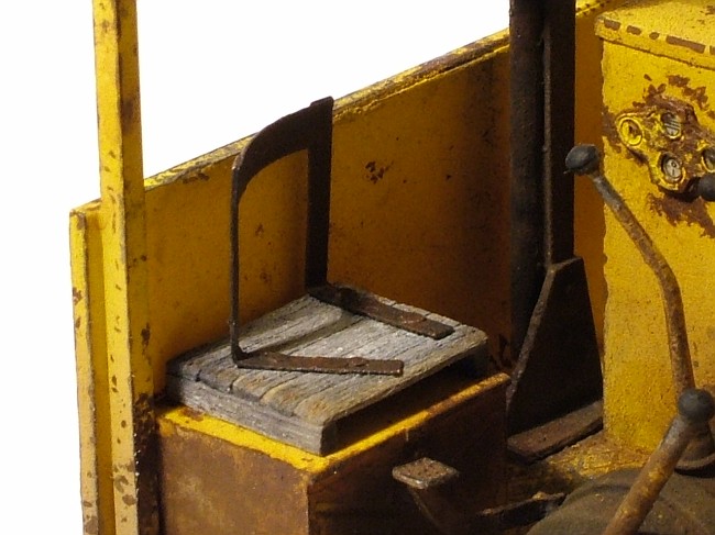

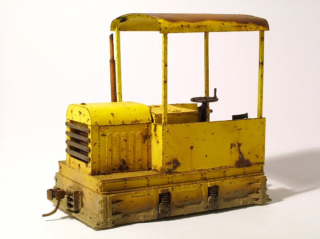

Since, I've done other gas loco in 1:35 scale  Wink, like this Smoky Bottom kit, my last model :
Philippe did a 1:35 version of the SBLC kit like yours Marc, and this kit was "perfect" for this scale...

wow; that seat must do some damage by the end of the shift!
beautiful work on both prime movers

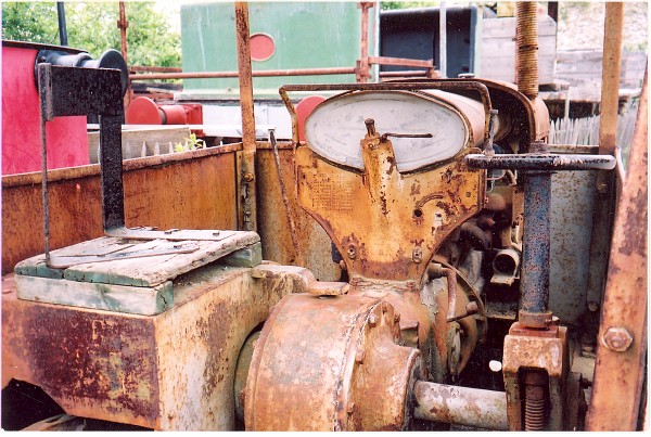

About the last gas loco, the seat is made from a real seat  Wink

Thanks for the pics of the beautiful Gmeinder......definiteley the quality/type of workmanship/finish I need to strive for.
The yellow engine is neat also...but for some reason it feels like a bit more of a "caricature".....not saying it's bad in any way...it's just not the Gmeinder  Wink Grin Grin....though the seat is cool. (thanks for the proto pic.)
Can you explain the process/technique you used to get the old wood finish on both of these locos? I'm most interested.

Hi Marc, thanks for the kind words!
About the yellow engine, I agree it's feel more of a caricature and yes it's not the Gmeinder, but it wasn't the same goal...For the Gmeinder, at that time I wanted a light weathered model, beacause narrow gauge model wasn't always a "rust heap"...For the yellow engine, I wanted to test some technics, and to have a model more weathered, because I found on the web some pics of more rusted models...I think too yellow paint had more effect regarding to rust....but also it's a color which is more difficult to treat in model weathered...
Wood tehnique : It's not a scoop, and the same technique like yours...I use always basswood for is fineness and sugar pine for ties...first, lightly I scored lines along the grain with a sharp X-Acto N?11. Then I add more grain with a steel wire soft brush, and sometimes with a light razor saw, but less and less with the saw because grain are often over scaled...After I add knot holes, and continue to distress and age the wood with my X-Acto knife N?11...Finally, light sand with 200-400 sand paper...I stained with ink / alcohol, or artist oil paint / "F" petrol (we find here in France diffrent type of petrol, A; C; F, etc...) never with turpentine because it left a brilliant or gloss effect sometimes, or 2 or 3 or more silverwood washes...And sometimes  I add weathering powders...
