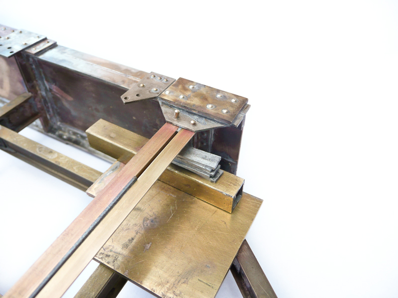

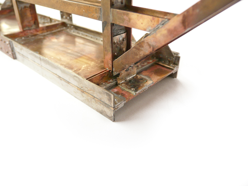

I started soldering both the preassembled parts in a piece of aluminum angle section. At one end of the bridge are no rivets in the longitudinal angle section's top side. So I was able to place that area flat to the aluminum without pushing rivets out during soldering.
This didn't work for the inner parts: I fixed those areas in the vise and soldered each segment bit by bit. Aluminum tubing helps to clamp within the gaps between the already rounded rivets and at at the same time reduces heat flux to the vise, but: After a few steps of soldering I noticed the aluminum tubing getting flattened and so changed to spring steel rods, which don't accept solder either. There's been no single rod popping or sliding out during the soldering process.
Next step was rounding all the rivets at the vertical surfaces, producing some chippings.
Mounting the opposite longitudinal parts followed the same principle, now using spring steel rods for rivet protection at the opposite side, too. Soldering now had to be done with all the rivets already rounded.
Together with the lower longitudinal part dogs were soldered to the 0.8 mm gaps I mentioned in the last post. Soldering needs to be done from both sides to have control of the amount of solder needed to shape the angle section's inner radius. The process wasn't finished, when I took the following picture. It still shows a gap at the very front of the longitudinal angle section.

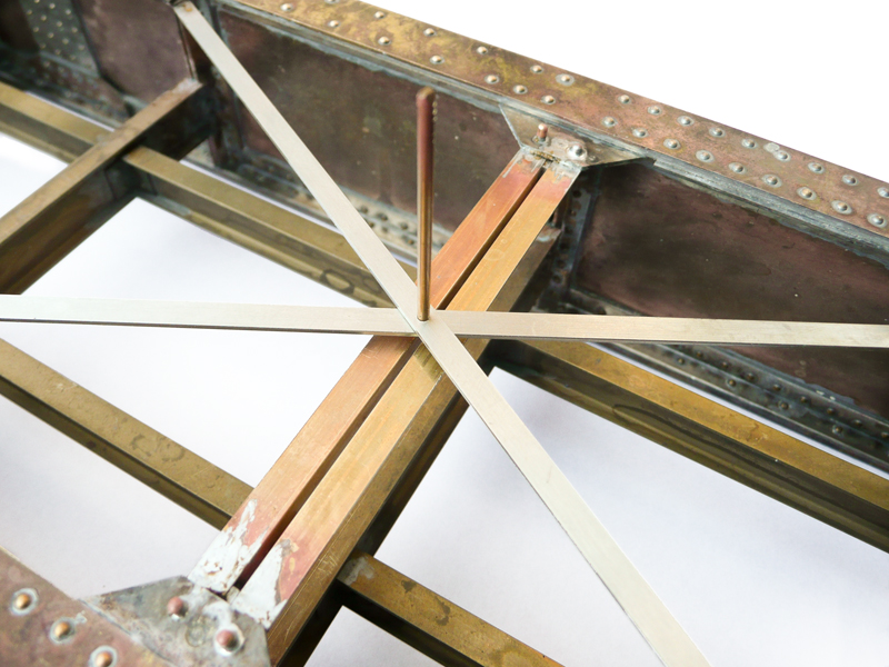

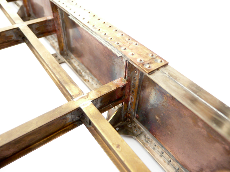

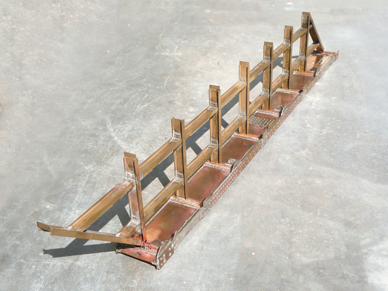

Connecting frame and shears was a task - by the way: I'd be happy to be corrected concerning those terms, if there's something wrong. I tried to do those parts with the resistance soldering unit, but there's a huge heat flow which lets the the unit go to the limits of it's capacity and so changed to the flambé torch again. The neighbouring solder joints had to be cooled with wet paper towels wrapped around them.
At both ends additional 0.5 mm nickle silver rivet plates had to be soldered into some rather difficultly accessable sections. The RSU worked for that.

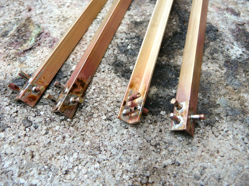

I was happy when frame and shears were connected without damage or alteration to the prepared parts, but now it would manifest if the parts were exactly enough to add the prepared connecting angle sections and cross beams. The dogs mentioned before had no bore holes, because the rivet heads would not be accessable with the bur (I learned a new word  Grin) later on. The connecting angle sections had to be equipped with 'rivets' before installing them. The single one would protrude through the prepared hole in the connecting plates and the pair being sanded down to back surface to touch the dogs.
This was where some inaccuracy occured: the dogs weren't exactly rectangular, which made it difficult to place the angle sections' rivets to the prepared holes and to keep them positioned for soldering. Some brass and final aluminum pieces clamped them in place. Again the RSU worked for that and when solder got to flow, everything plopped into right position.
Last step was adding the cross beams. For them I used prerounded rods, protruding a rivet heighth on the not accesaable side. Last step was to cut and round those rods on the bridge's underneath. This is when I broke the bur.
Next week an acquaintance from Buntbahn is going to have a look at the bridge to check if he may sand blast it at his company. Difficulty will be to remove excess solder at some rivets, but keeping the solder fillet alongside the longitudinal angle sections.
Unfortunately there are no color pics of the bridge at all and I have to puzzle over its color. In Germany usually you have a darker grey tone of micaecious iron oxide, a brighter grey or reseda green. Who knows.
