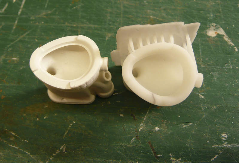

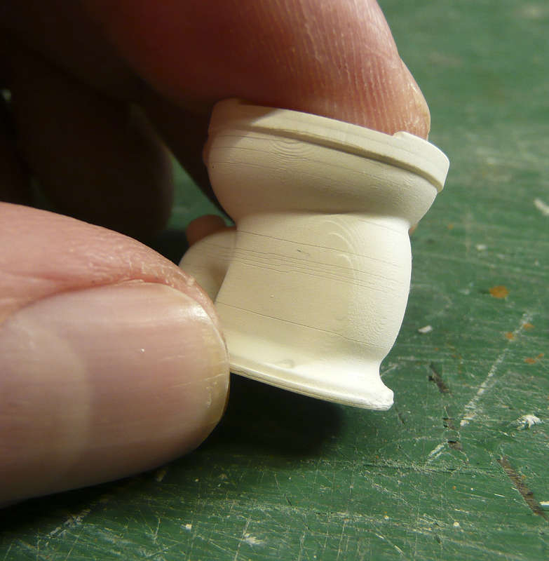

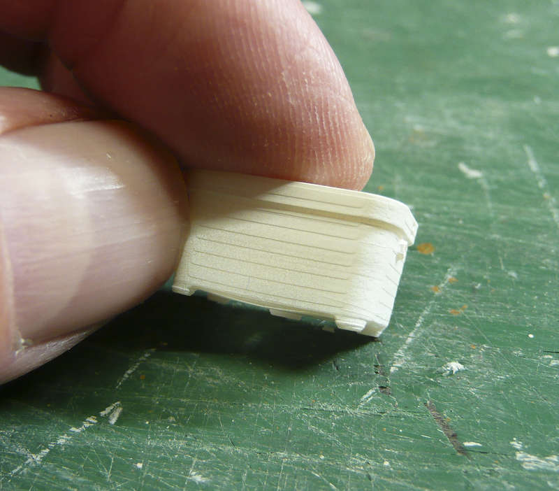

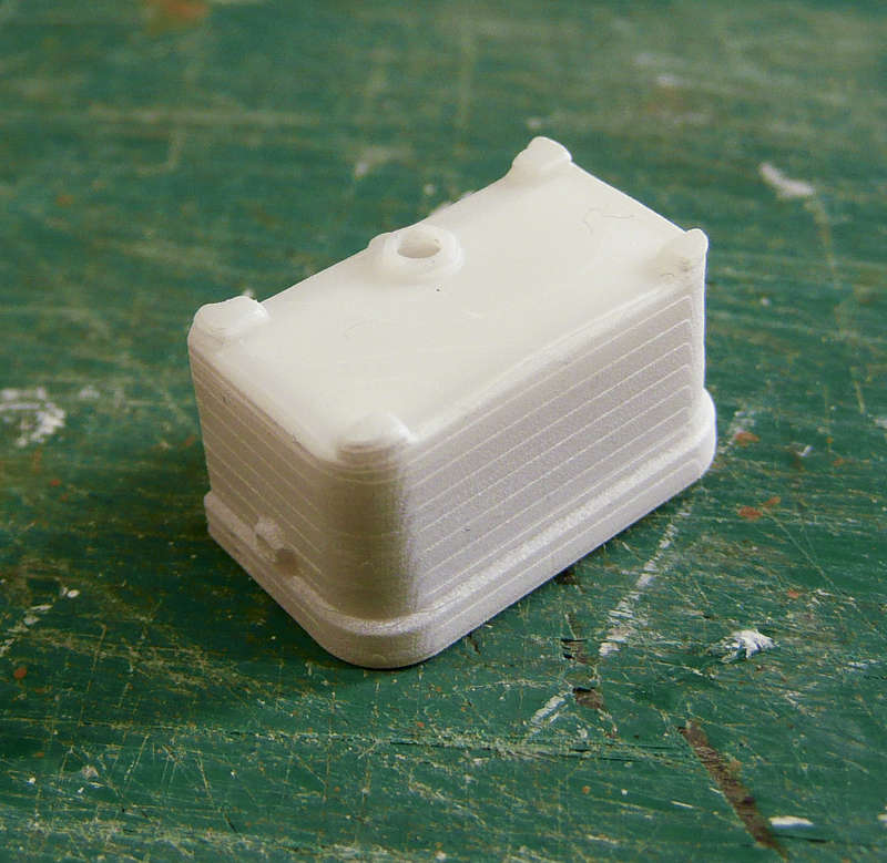

This is going to be the toilet tank. All sides are inclined at some 1 or 2 degrees. The item is printed straight to the base plate in upright position, starting with it's feet. There are no support structures to be removed, but we have clearly visible printing lines.
This toilet has been printed the same way: upright and straight to the base plate.

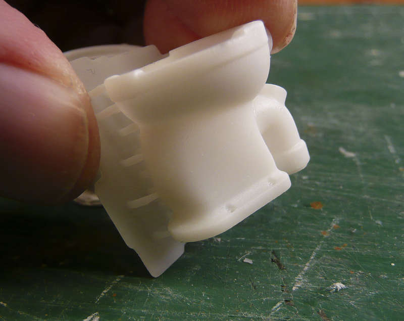

Same file with a reasonable printing orientation: Nearly invisible printing lines, but supporrt structures, that need to be removed.
Left hand the item 'straight from the base' and right hand the other example. Note the carves and especially the strange seam at the left toilet's inner edge and foot and the bore holes missing. The other print shows all details.
What I'm trying to say is that those tools can't perform miracles. It doesn't make sense to have a surface with a lot of detail, but the surface itself doesn't look right at all: Cleaning it up means to loose detail. For the dishes it was necessary to have them printed straight to the base because they are thus brittle and it would be impossible to remove support structures. This way their bigger surfaces get very smooth. For the much bigger toilet this doesn't work at all. Even at bigger dishes like coffee pots the lines are visible, too. It will take another long time until there's a 3D printer to print objects 'as they are', i.e. without support structures and visible printing lines. Compare that with the development at customer printers years ago: We just have left 'wire printer quality' and start with 'ink jet quality' and consider what even a 50,- $ printer can do nowadays! Howsoever this is a huge step forward for the end customer market.

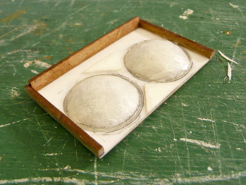

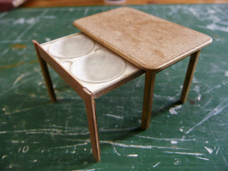

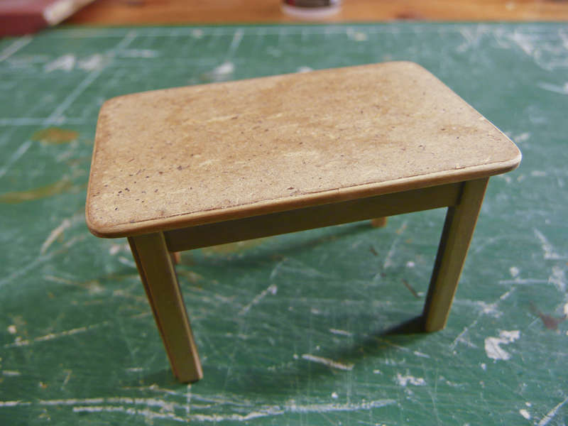

And now to something completely different. In our living community during studying we had an old wooden kitchen table with a somewhat corky surface. I wanted something like that for the model but unfortunately serendipity led me to a table with implemented sink. Well, that's it:
Tabletop with additional wooden edge:

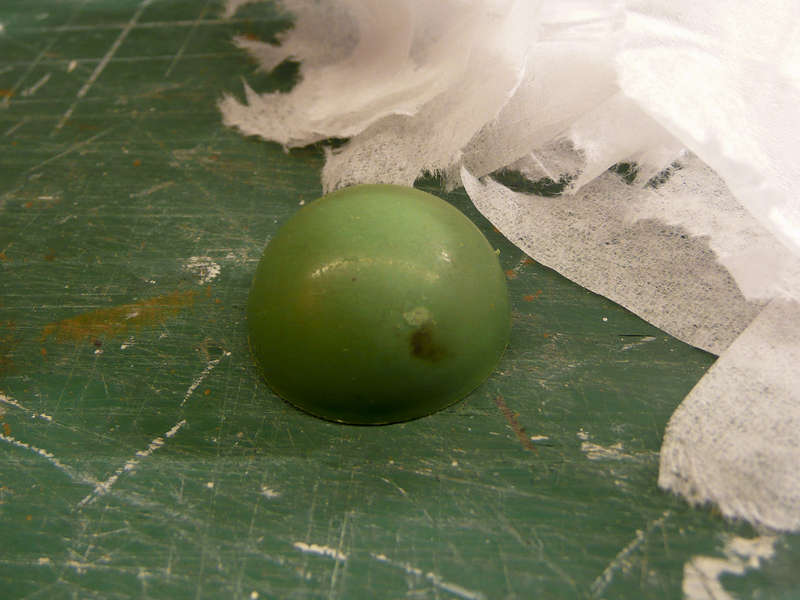

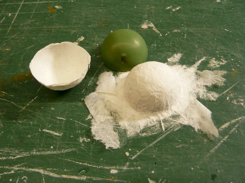

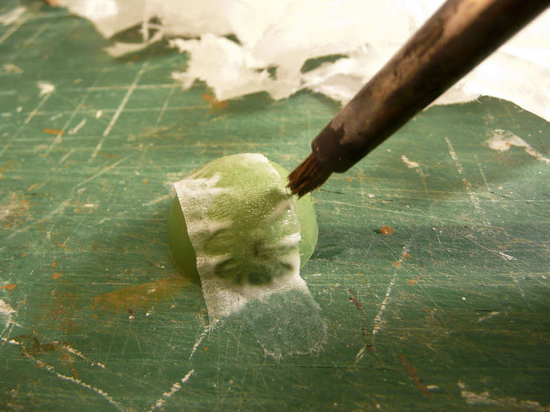

I wanted to do the enamel bowls without 3D, just out of paper. A firecracker residue serves as jig.

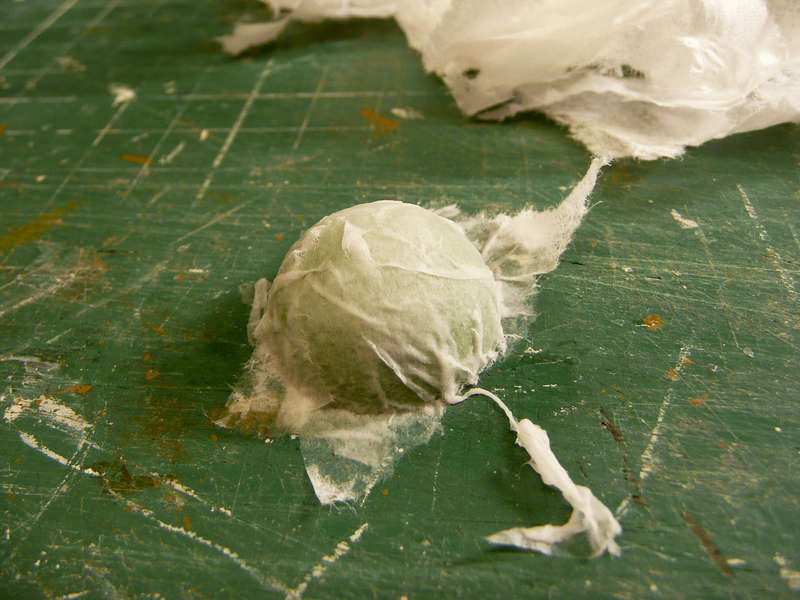

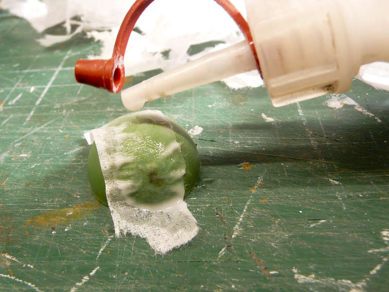

Small flakes of single handkerchief paper layers are glued to it with thinned Elmer's glue ...
... and pushed to the surface with a brush.
When dry the paper bowl can easily be removed from the plastic hemisphere.

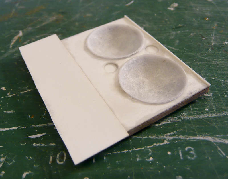

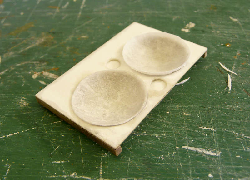

Cut out segments glued to the drawer:
The additional seams are made from paper, too, glueing a sheet with a tiny protrusion to the drawer and then cutting/sanding away the excess.
That's it. Condition before painting:

It would take me a dozen attempts to come up with two "bowls" and I probably would ruin one when I tried to trim the edge. Or maybe I'd fail to produce even one. To say I am impressed would be an understatement. -- Russ
It's not that difficult: I drenched the bowls with CA from the back side after removing from the hemisphere. When dry, insert the bowls to the cut out holes and draw a pencil line at the back around the protruding parts. Then cut some 1 or 2 mm a bit above with a nail scissor, glue to place with PVA and then sand down the protruding edge to the desired height. The result isn't as clean as a metal part (at least if I do it), but it works fairly well.

Volker, great work on that table!
Thanks, Ray, the tabletop is HDF 1.5mm and a strip of veneer glued around it, then drenched with CA and sanded. I didn't have the same veneer as the wood for the legs so I painted all wooden parts afterwards for an unifying look. Tabletop was finally treated with some brown shoe polish.
