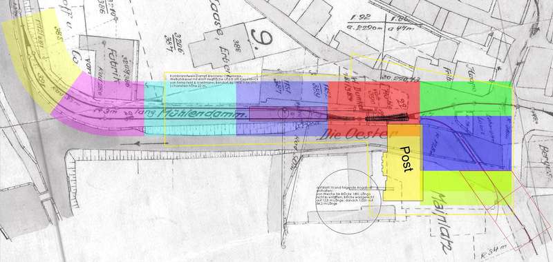

Russ, it doesn't relate to 'quiet earth' at all and so it is an independent project, but please let me cite a person beyond any doubt, a person with publicity that has given up everything his occupational life was about, retired from the world, forgotten by his friends: 'The model is about one-third to half complete, the third major structure for a [...] diorama I may never build.' When I was young (wait: that was only 4 or 5 years ago  Angry?)) I planned to build a huge segmental exhibition layout of a completely prototypical situation, which would be about 8.3 x 3.2 m:
Meanwhile I acquired a tiny weeny bit more adulthood and understood, that we don't know how much time we've got on earth - and that it may be a bit scarce in the light of my progresses' speed. Going to model shows isn't my main concern anymore - and I ain't got the space to erect and store all the parts at the moment at all. But: taking pictures, which became more important to me, is possible without having a completed layout. Nevertheless I can't stop following the initial idea and inspiration of that place and so I just started tinkering around with some parts. I'm quite sure to build at least the violet and upper green area, which containes the bridge as well as the building. As you can see, there isn't to much sense in it. But some hope - what a great prompting.
