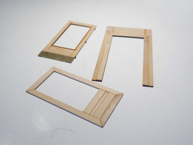

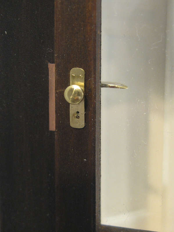

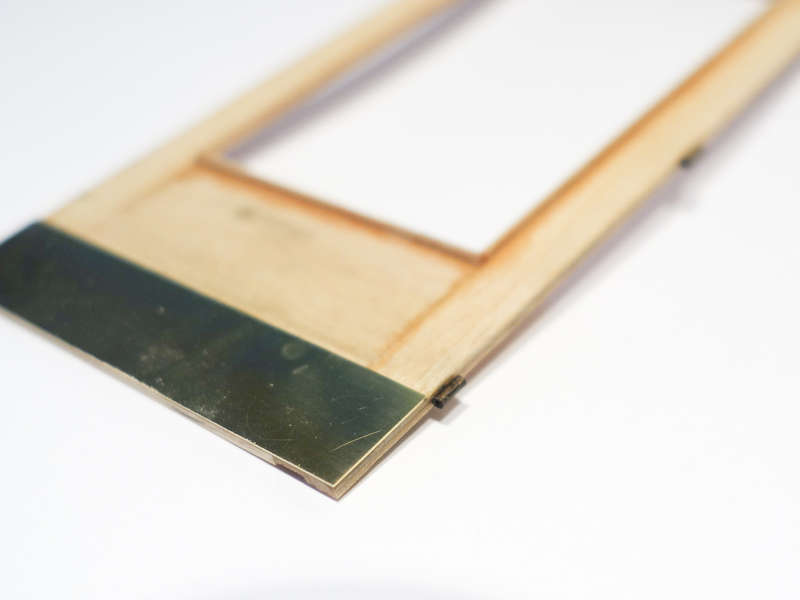

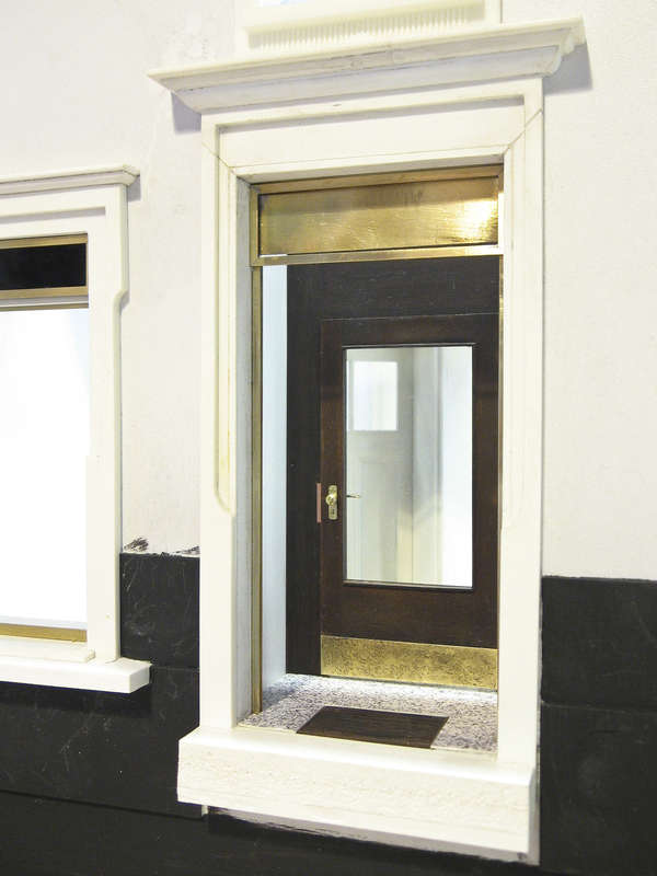

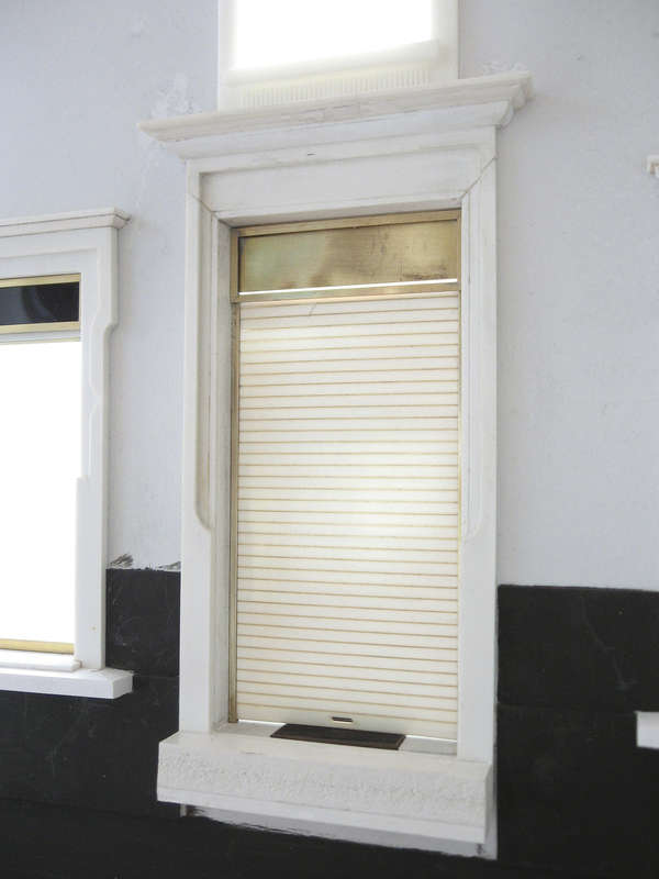

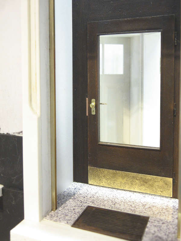

« Reply #219 on: December 29, 2017, 12:58:38 PM »

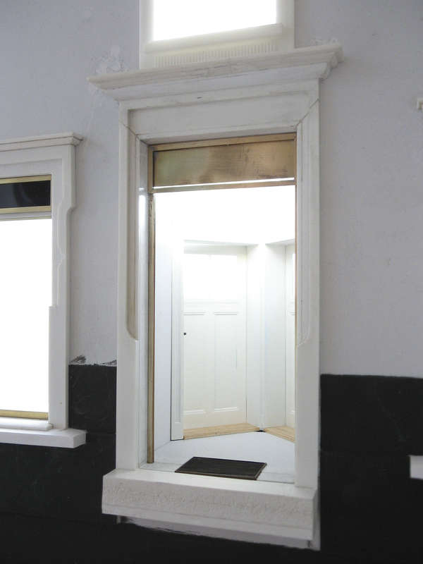

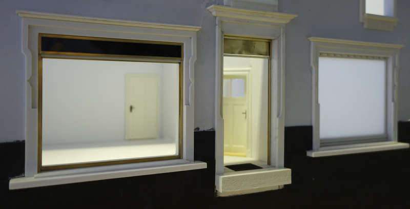

Good evening Ladies* and Gentlemen!
Added some parts. There's a blackened screen with the shop owner's cypher to come where there's a brass screen now:
When I closed the shutter ...
... and opened it afterwards there was an additional door and some trifles. Simply astonishing, but it happened. Must have been any christmas thingie.
A bit closer.
Another bit closer for some dust and fuzz. And for unmissable evidence of my decreasing eyesight according to the aperture's screws.
Door is made of veneer and CA.
There are show cases to come at both entrance's sides.

Wow! Great work! What is the shutter made of?
Posts: 683
« Reply #222 on: December 30, 2017, 07:44:40 AM »
The shutter is lasered (i. e. cut and engraved) cardboard of 0.5 mm diameter. I drenched it with spar varnish to have it a bit more stable. At the lowest lamella there's an additional piece of brass angle section over the complete width. It's able to roll it up and down a few times which is efficient to get to some different pictures later on. I don't need to have it 'working', but there'll be a hidden string to help closing it because it doesn't roll up to well because of it's stiffness.

« Reply #223 on: December 30, 2017, 11:02:53 AM »
So you are saying when the Christmas thingie opens a window, it closes a door? Smiley And and excellent looking door it is.
