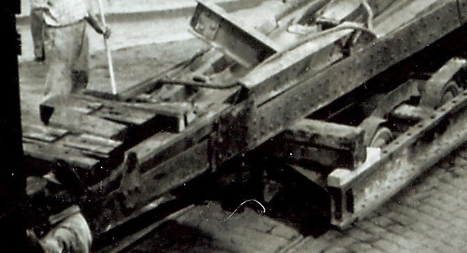

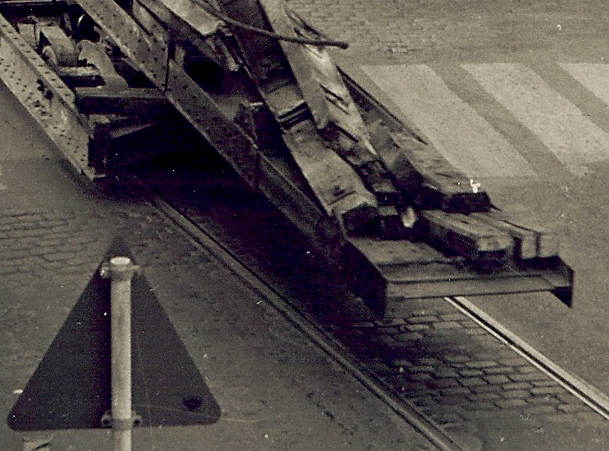

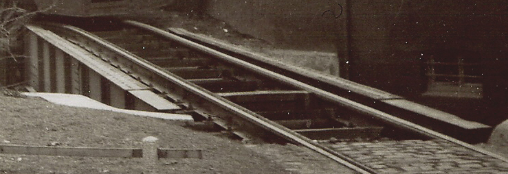

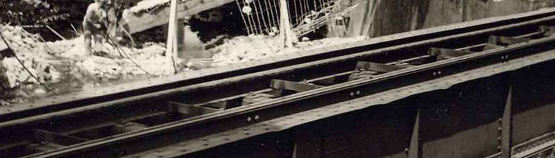

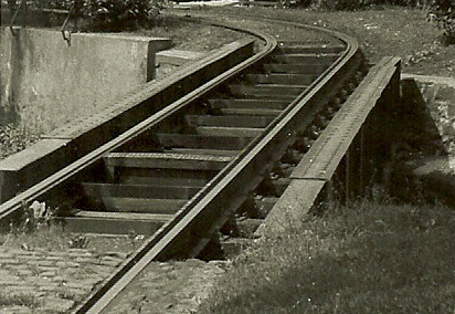

I feel the last picture shows the coloring and state of the sleeper I tried to achieve. They mustn't be too grey; I only know that greyish color from not or very seldom used tracks. Here are some prototype pics of the bridge. The sleepers had some constant dampness from the brook but must have dried fast on the upside.
The next out-take (transport of the dismantled bridge) shows those very slim bridge sleepers.
But I made a mistake: Most sleepers were thicker and carved below (see the cut pieces on the left) to fit the solebars (longitudinal bridge beams  Huh)...
... which you can see here:
Unfortunately there's always a gap between claim and reality; at least the CAD construction is completed, including the mostly incorrect sleepers. But I'm going to change that at the model.

Here a reference pic to show, what is to be understood by "sleeper". Even under the same conditions, colours vary a lot. Especially in my in my region (perhaps also in Volkers) with relatively a lot of humid weather, a darker appearance may be quite accurate.
