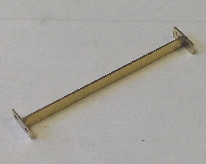

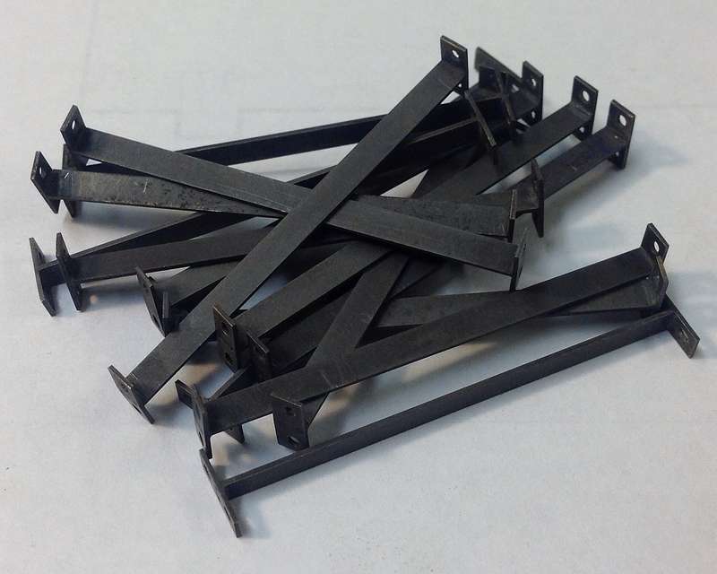

Some time ago I'd got a shipment by Helmut, whom I'd asked to mill the parts for the gauge bars.
What I got were the completely soldered and blackened items! Thank you very much, Helmut!
Some test mounting
including the drainage.
At least the drainage is built by myself from an etched part and cardboard. This will be completely visible including the pipe because it's positioned in the middle of the bridge. I think they did that to avoid ice building up in the grooves in winter time.
