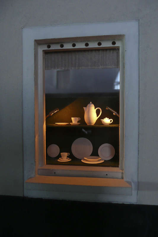

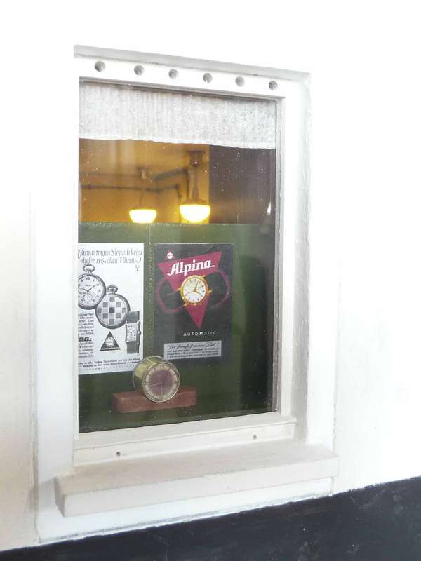

Added some spare items to one small shopwindow. Indeed this optician had dishes, radios, vases and so on on offer. I first had the window unlighted, but didn't like that at all.

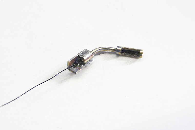

Some 0.8 and 1.5 mm tubing, some angle section, a file an some 0.8 mm diameter bulbs led to this:
The metal parts are one pole, a 0.15 mm enameled wire soldered to the bulb and passing through the tubing is the other one. A lathe would have been somewhat helpful to get cleaner results and to thin the wall of the lamp shade, but a Dremel suffices.
This is how the wiring is hidden: small slots in the walls' top side.

The window lighting looks fantastic!

Good decision to light the window. The rest of the work isn't bad, either. -- Russ

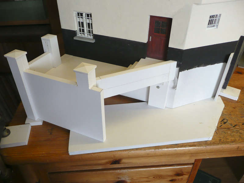

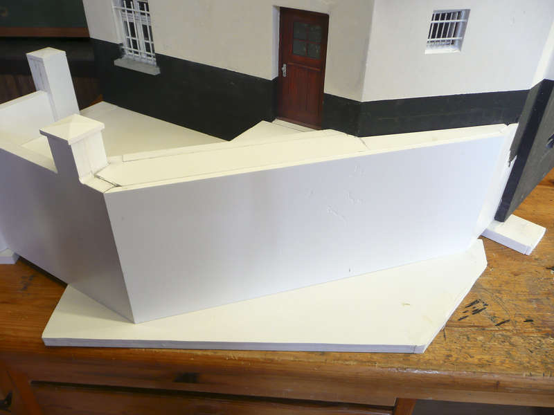

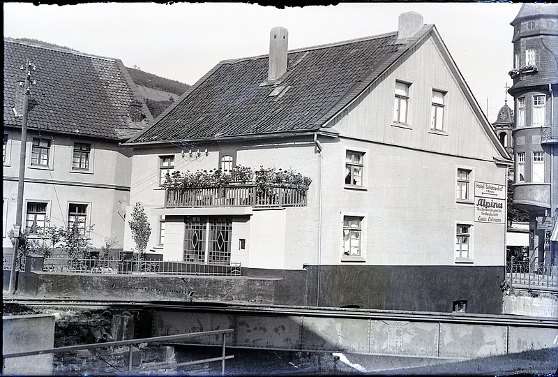

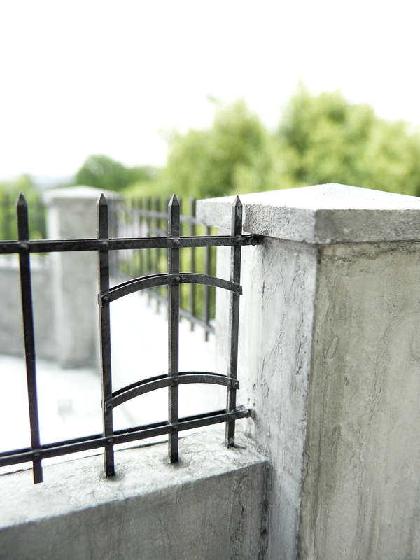

The Lohmann building had a small front (or back?) yard before the annex had been erected. There was a riveted fence running around it. The picture from in between 1904 und 1910 shows it.
Wolf Dietrich Groote collection

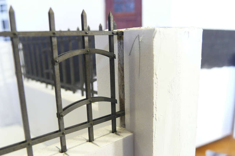

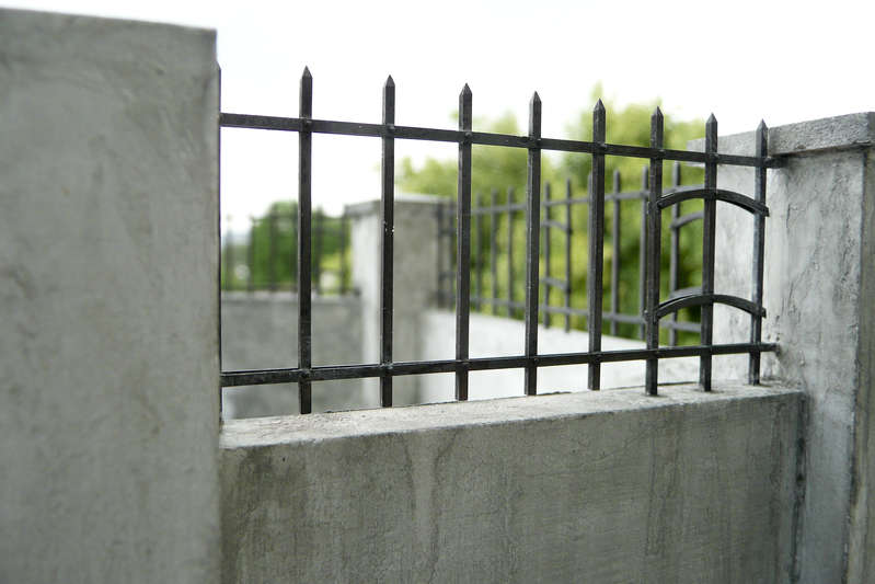

The annex destroyed some parts of the fence. The yard is made from milled and hand formed Forex (Sintra). The wall seems to have been strengthened after 1903, when there was a derailment on the bridge. There's a picture in the  Plettenberg Kleinbahn book (yes, that's covered advertising and I'm more than related to the guy, who did the book layout).

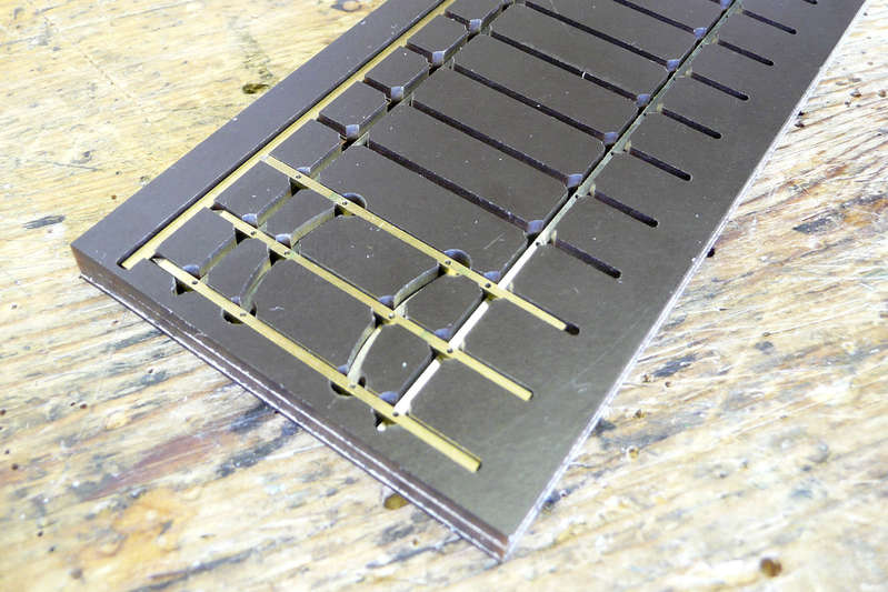

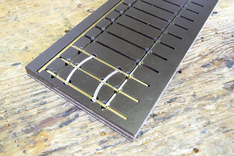

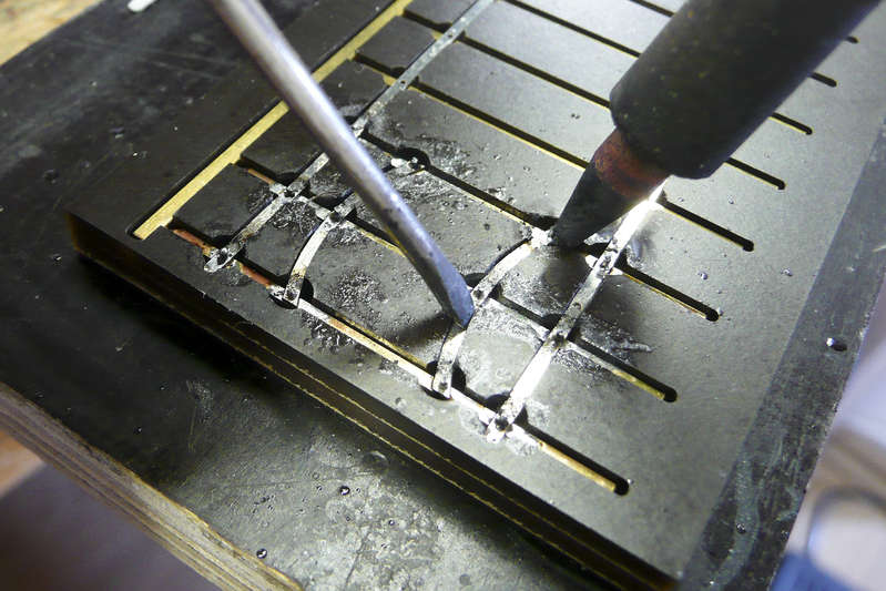

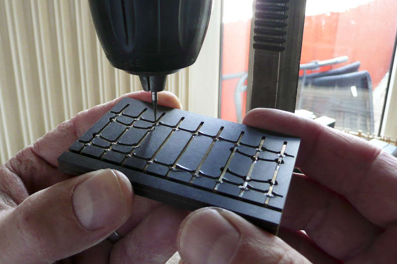

Frithjof milled the nickel silver and brass parts and a soldering gauge. It didn't work to press the rivets because the small strips changed length uncontrollable. So I decided to solder sprigs into bored holes and round them afterwards.
This works best at 100-150 rpm.

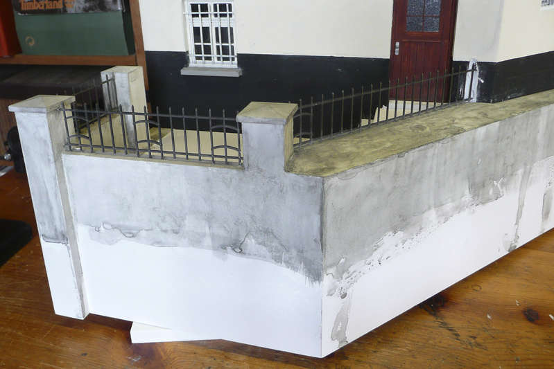

The fence was glued to bore holes in the Forex, which had to be spackled afterwards. The Forex plates got some plaster, too.
A first washing shows where to add more or varied texture. I'll do that, when the parts can be glued to the building, which may take some more of my and your precious time.

More impressive work, Volker. The fence is very nice and the texture and color of the concrete is just right.

great fence Volker..

The wall and fence look great, and the rivet detail is fantastic!

Good heavens! Very adequate! -- Russ

The lighting in the window and the fence both work so well. Very nice work indeed.

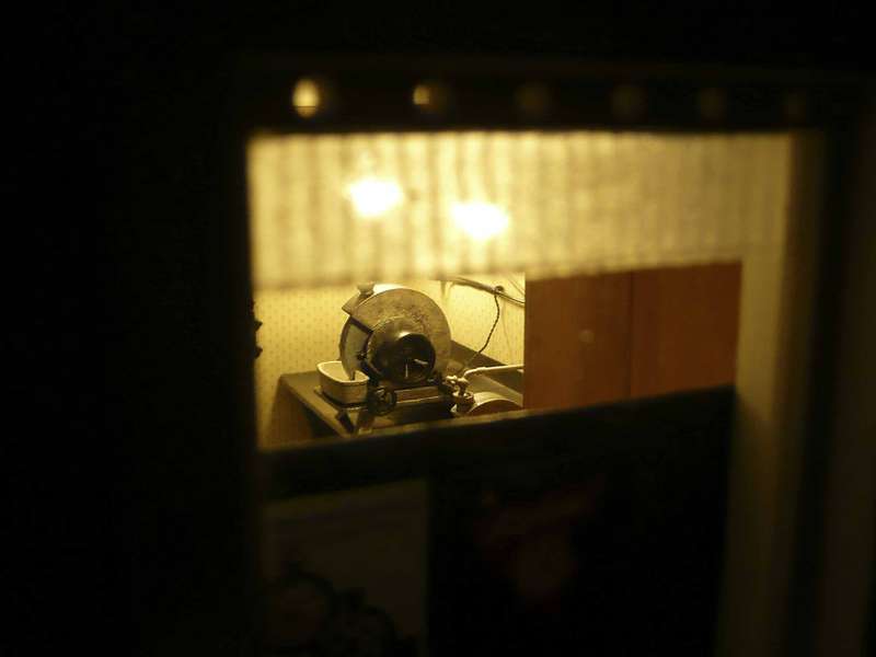

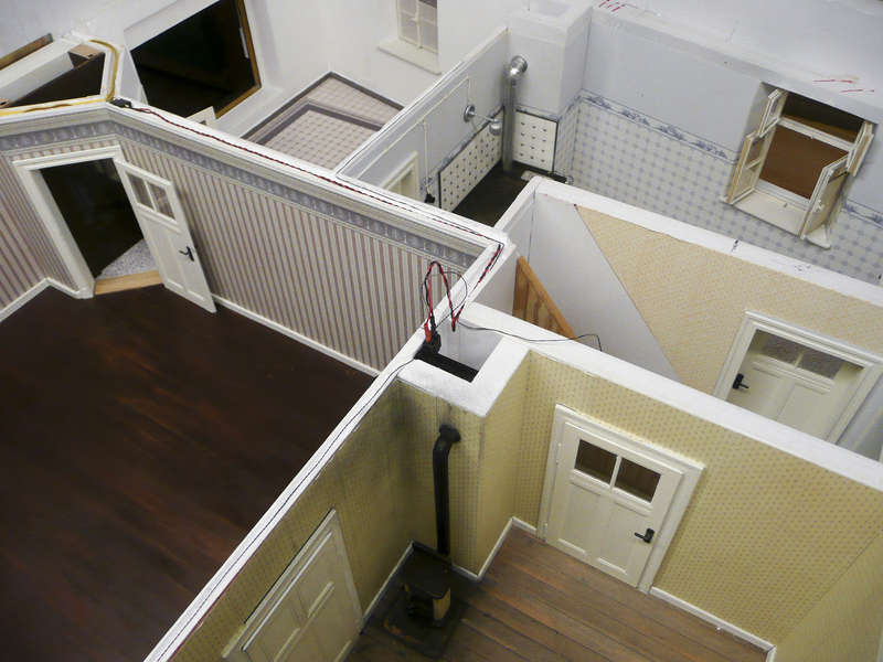

I added the second shopwindow's interior. This will have no own light.

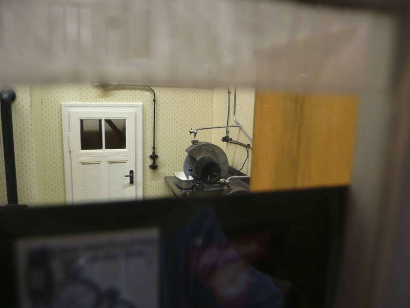

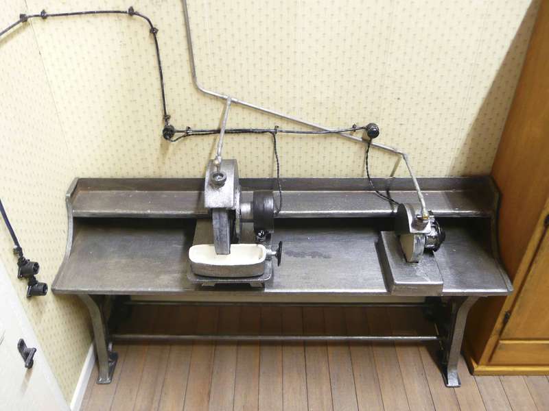

Right behind is the optician's workshop.
This overview isn't possible later on, only the glimpse over the shopwindow separation.

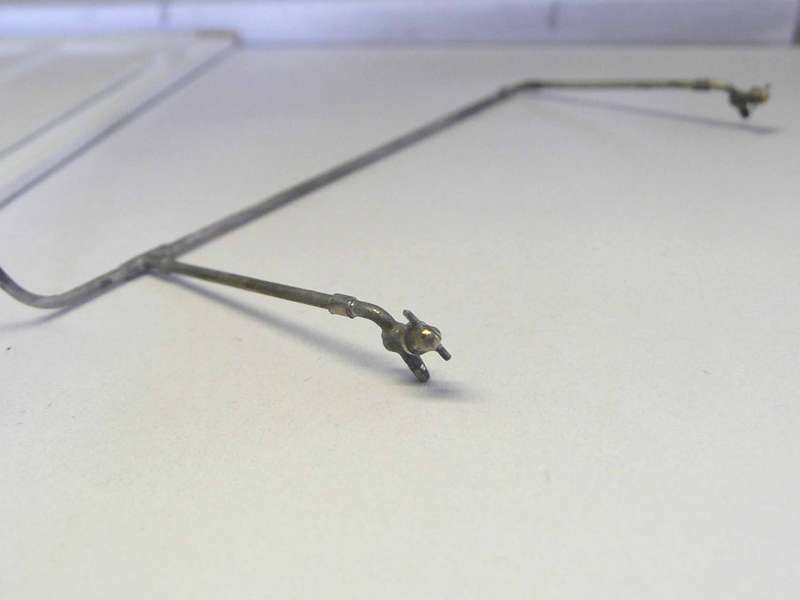

Plumbing is made from brass wire and tubes. I tinned it and then had it for some 20 Minutes in water with citric acid which gives that lead tone to the tin.

More good stuff. Glad you took photos now from angles that won't be visible later so we can see all the terrific details.

Doesn't it bother you to build something to such a high degree of excellence and then leave it only partly visible? Is there no way to allow access later? -- Russ

Perception, cognition to me is a more and more interesting aspect in modeling. How realistic is a model one can take in his hands and look at from all sides? What got this to do with perception of the prototype? Which indiscreet views do we have in strangers' private rooms (as long as they don't want us to have them? I'm afraid this is getting more and more weird, but concerning cognition it seems interesting to me to limit access to rooms or items whose existence is known to the beholders. Well, maybe it's just my inability to delimit a topic. Lacking any interior picture serendipity and online investigations of comparable situations leads to what I think might have been there. What bothers me is the sheer amount of items to be built for the big shop windows and showroom. But whenever I thought something couldn't be done this was a fallacy. Time is my friend. Still.
