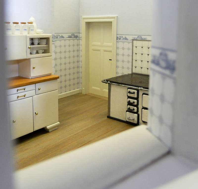

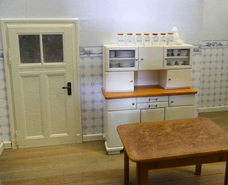

« Reply #349 on: May 17, 2019, 03:48:58 AM »
Some progress at the kitchen:
Posts: 992
« Reply #350 on: May 17, 2019, 05:16:48 AM »
That's a nice kitchen. I like all the components and details, especially the top of the table. The wear on it looks perfect.
Posts: 624
« Reply #351 on: May 17, 2019, 07:55:41 AM »
Nice composition.  The layout makes for a useful work space.  I am waiting for you to add the aroma of baking bread to the diorama Grin Grin.
Posts: 5716
« Reply #352 on: May 17, 2019, 11:43:27 AM »
More 3-D prints or did you build up the kitchen appliances from something else? Either way everything seems quite adequate. -- Russ
Posts: 4241
« Reply #353 on: May 19, 2019, 06:45:37 PM »
Wow!!!
Ray Dunakinís World

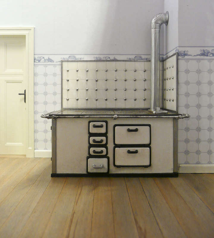

Posts: 724
« Reply #354 on: May 21, 2019, 12:09:29 AM »
Thanks Bill, Lawton, Russ and Ray,
the smell of baking bread ... that's something. Will be difficult, to keep it in the kitchen area  Grin
The pots (?) with the wooden covers are 3D-printed, but making them on a lathe would habe lead to better results. The signs are printed to cigarette paper ans 'glued' to the prints with clear matte lacquer. Decals would have worked for sure but it is a bit expensive for just one small item.
The tiles mirror is very fine grey lines printed to silk matte photo glossy paper, back drenched with CA, which makes it irregularly translucent, and then glued to some white cardstock with PVA. Frame is tinned brass angle section and the dots are tinned brass nails. At the oven handles, pipe elbow and sleeves are printed. Everything else is low tech.

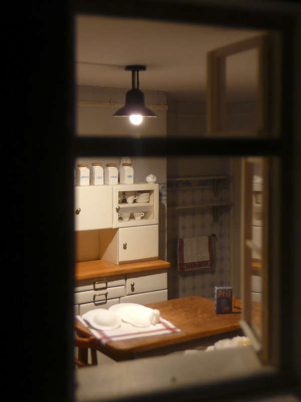

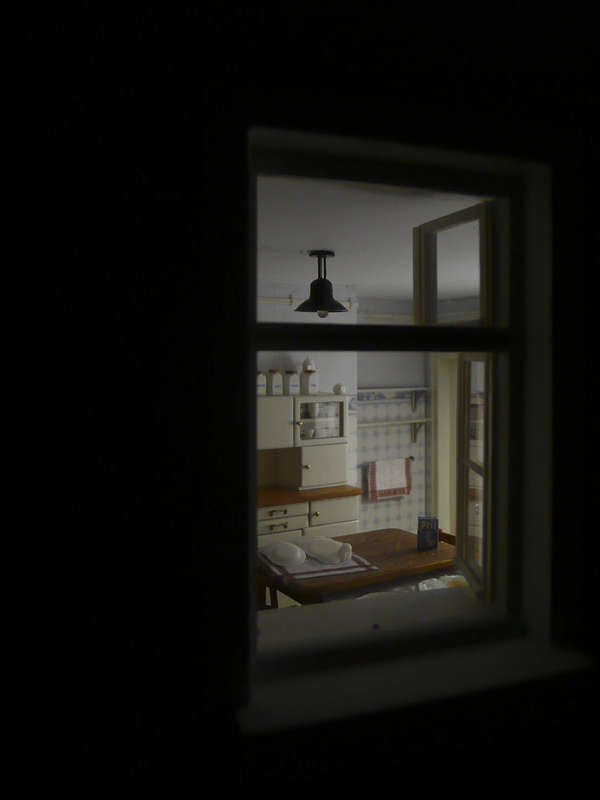

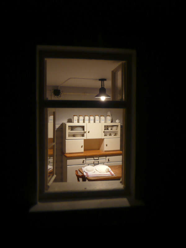

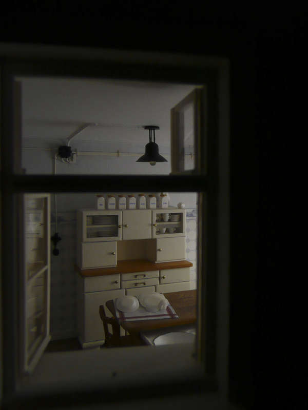

« Reply #355 on: June 06, 2019, 03:28:01 PM »
The kitchen is nearly done aside of some items for the shelves. There are two independent light sources.
Posts: 5716
« Reply #356 on: June 06, 2019, 09:56:33 PM »
Adequately superb. -- Russ
Posts: 783
Klosterstollen
« Reply #357 on: June 07, 2019, 04:01:05 AM »
Hello Volker,
please don't forget the oven sheet, because so falling embers would fall on the wooden floor, that was even then already regulation. There is also still a lack of fuel for heating the stove. This was now metered at an extremely high level, which would underline the already existing perfection.
Posts: 992
« Reply #358 on: June 07, 2019, 05:46:28 AM »
Very effective lighting. I like the conduit on the wall and ceiling.
Posts: 4241
« Reply #359 on: June 07, 2019, 08:56:08 PM »
Holy cow! Once again you've amazed me! Very fine work. I especially like the electrical conduits on the wall and ceiling.
