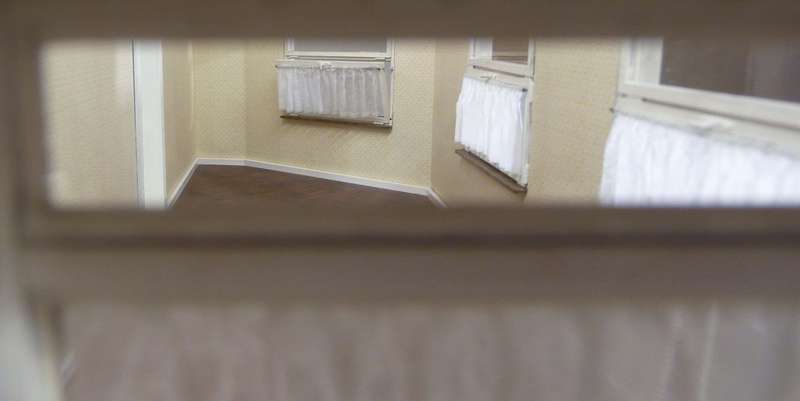

« Reply #295 on: January 06, 2019, 04:08:48 PM »
Carlo, Peter, Ray, Bill, Russ,

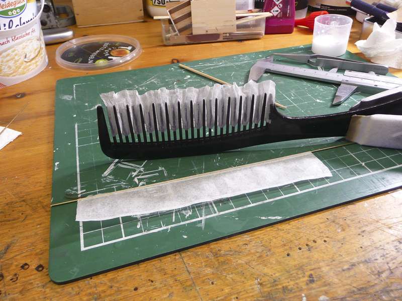

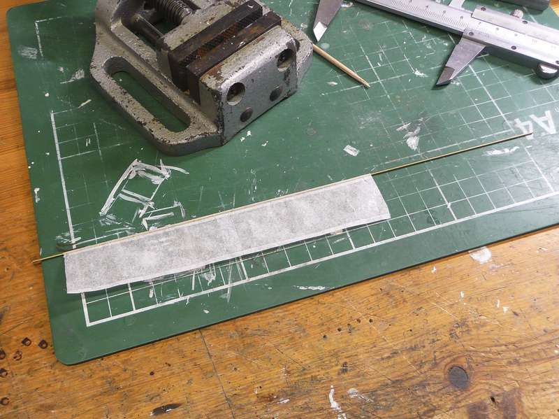

here we go: The tea bags were the way to go and I think the results come as close as possible (for me  Grin). Thank you for the valuable hints and ideas!
If you unfold a teabag, there are thiose tiny seams, where they are connected. They are easy to open. They serve as the lower curtain seam. At the upper end some 4 or 5 mm are wrapped around a brass rod. For the following steps it helps to glue both the seam and the wrap with thinned watertight pva (I didn't and had some fun  Angry).
When it's dry, start to push the paper together alongside the rod. The lower part will start to wrinkle somehow. To bring that into a convincing shape I threaded it through a comb's prongs. Unlike at the picture it proved better to do this with the rod inserted. It's a bit tricky, because you can't pull it through the comb, but rather have to thread it from the prongs' tip downwards.

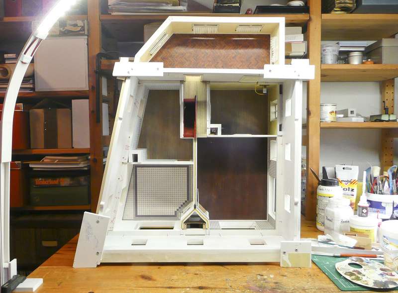

Some steel wire serves as cornice. If you push the curtain to it's desired density, it starts to swing outwards in a not prototypical manner. I fixed that by positioning some block alongside the curtain. Afetr one or two days the paper keeps the shape.

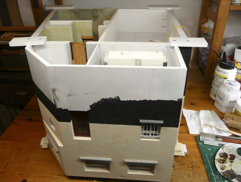

I often have to upend the building or put it to it's sides. Some distance plates screwed to the edges of the building prevent damage.

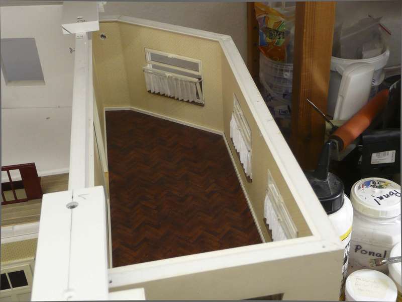

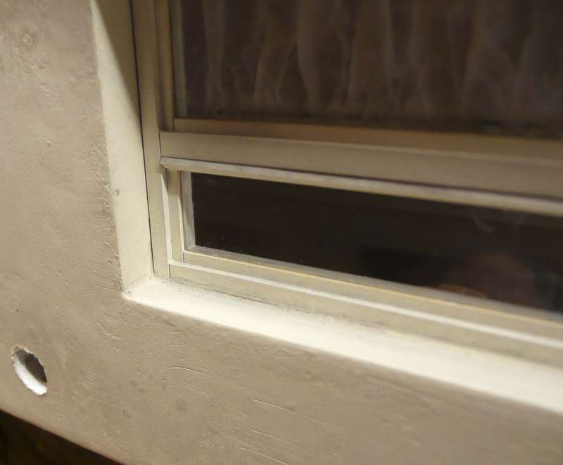

I use facade color mixed with pva and some very fine slate dust to "install" the windows. I think it makes a huge difference if the windows look that tightly connected to the building. And it is necessary to avoid light shining through any tiny chink. Filling the gaps with this color mix only works at horizontal edges: The vertical joint has to be filled after turning the building around again.

« Reply #296 on: January 06, 2019, 10:33:42 PM »
Excellent! I will have to give the teabags a try on one of my buildings.

I forgot something: if you've threaded the paper to the comb, drench it with thinned pva. At that step the curtain pole seams tend to open. Here the watertight pva may help, but I didn't try it.
