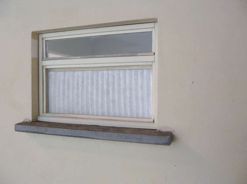

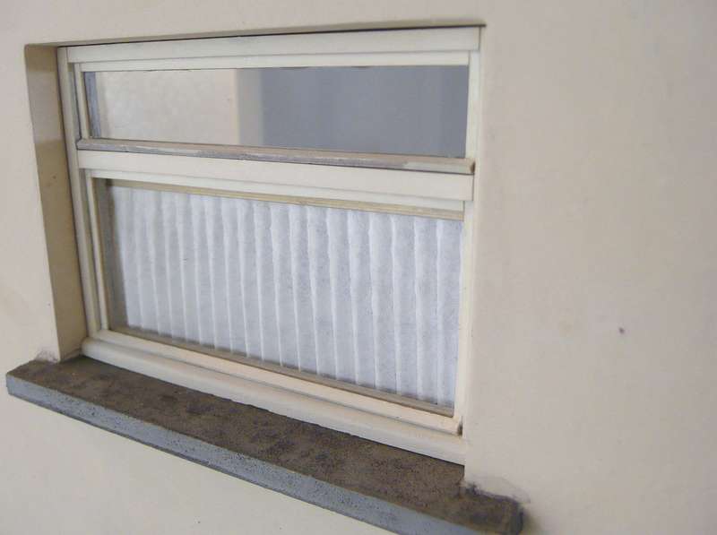

I'm in some trouble with modeling curtains. I want to achieve both the fabric appearance in texture and shape. I used paper muffin baking tins because I wasn't able to undulate paper without producing kinks. I think the shape has some potential, but I'm not to sure about the fabric appearance. To my eyes it looks to much like what it is: paper.
I'd be happy to get any ideas which material to use or hints to some good examples of modeled curtains.

As far as I can make out from your pictures there are two "problems" in your curtains.
First, the folds in the fabric become sharper downwards, but for curtains it's more the other way round - or not Huh- secondly, a (very, very) slight yellowish tint, and your curtains would look very realistic to me!
Cheers, Peter

good points. After Peter's hint I collected some more information about how curtains were made back then at our local petty wears shop. The shop owner is a doll house maker herself and we had some interesting talk about modeling techniques. Indeed the paper tins don't work because of the way they are folded and I think that's what Peter mentiond. Unwrapped it is a circle segment, but the curtain has to be a rectangle, which means, that it is closer and tight folded at the upper end and free falling downwards. The linen handkerchiefs Lawton mentioned are even for 1-22.5 scale a bit to strong textured, but it gave an good idea for the right direction. I bought 3 strips of white satin to test, which is even more dense. Let's see, what it is going to look like. Helmut pointed me to a rotary cutter, which will be very helpful with those small patches of satin.

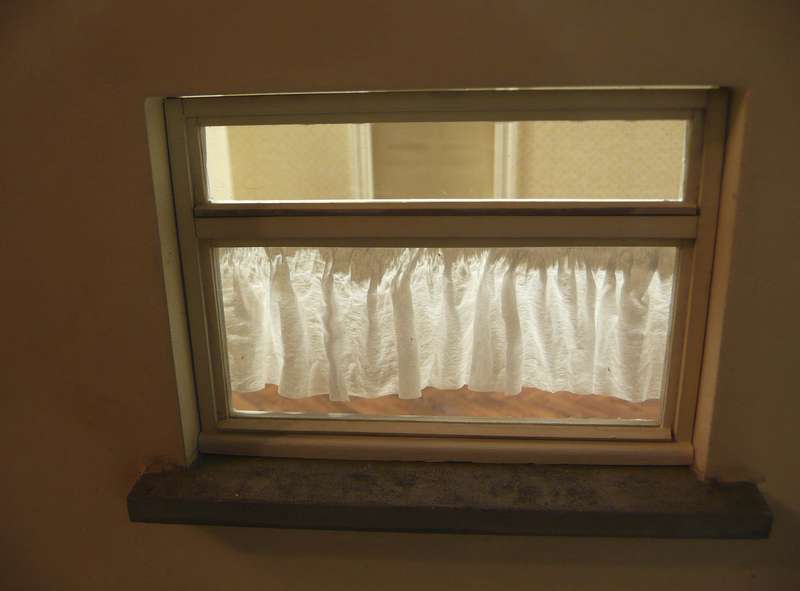

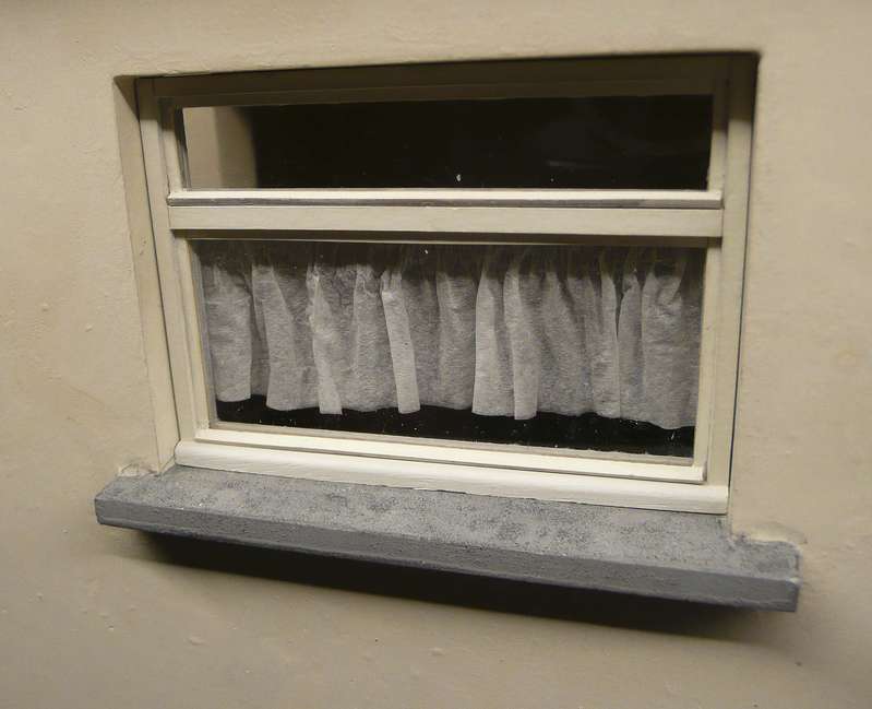

« Reply #282 on: December 28, 2018, 04:14:13 PM »
Some results with a single layer of paper handkerchief, folded around a brass rod (= resulting double layer), drenched with thinned elmer's glue, pushed together and shaped with a toothpick.
I'm not to sure.  Angry Huh

The paper handkerchief and the irregular folds look a lot closer to what you want.
a couple thoughts:
Peter wondered about all the tucks in the top hem compared to fewer folds for the body of the curtain. If the top inside of the curtain is visible from some viewing angle, you could cut a long, thin strip of the paper the height of the top hem and fold many many tiny accordion pleats in it, then glue it to the many body of the curtain.
The texture of the paper handkerchief looks like curtains that have been washed, but not ironed, perhaps not a characteristic of some households.
Some people have used paper teabags for fabric. If the overall size of a teabag is big enough, that might provide you with a curtain that will have the gentle folds in it, but not look wrinkled.
