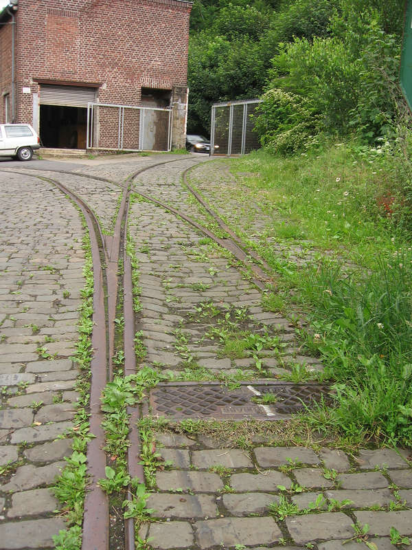

Let's have a look at the switch leading to the bridge.
Foto: Albert Middermann, Slg. W. Groote
Fortunately there's a very similar "Bochumer Verein" switch at the Sauerländer Kleinbahn, which came to the museum from the former "Hohenlimburger Kleinbahn".
Foto: Wolf Dietrich Groote 2012

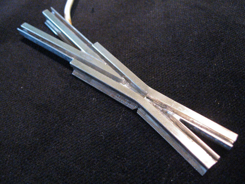

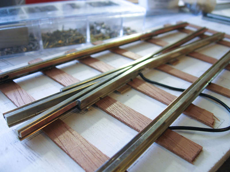

So the plywood is the basis for the switch and my workplace for soldering and mounting the parts. Don't mind the "sleepers". They will not be visable later on. Here you can see the combination of Peco code 250 and angle section 3 x 3 mm to form the grooved rail.
Fixing the parts for soldering on a piece of aluminium.

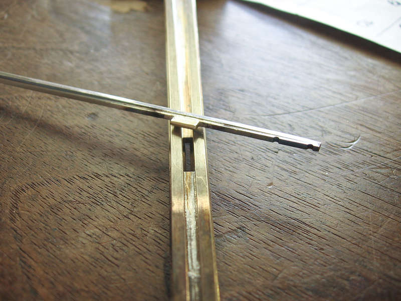

If you look carefully at the prototype picture, you can see a completely visible piece of rail at the setting lever. To imitate that I sanded down the rail base and soldered a piece of angle section in place.

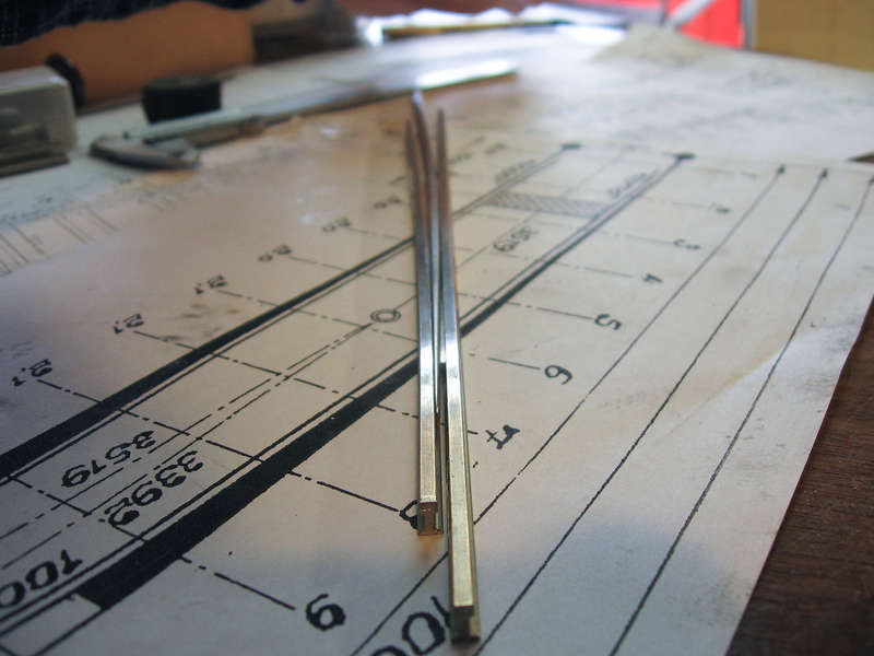

Making the switch blades:
A bit burnishing:
Detailing the blade:
The insulation is cardboard, drenched with CA. At the prototype there's a joint so I insulated all rails wether necessary or not.

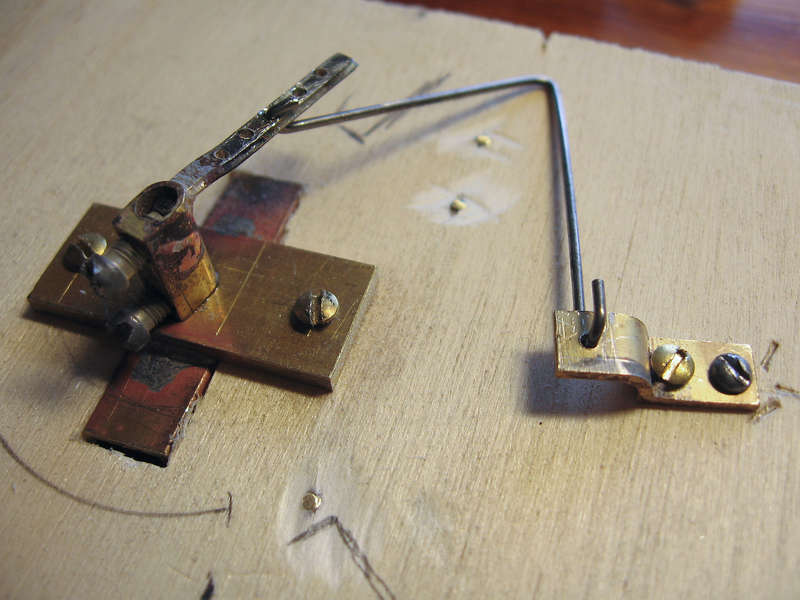

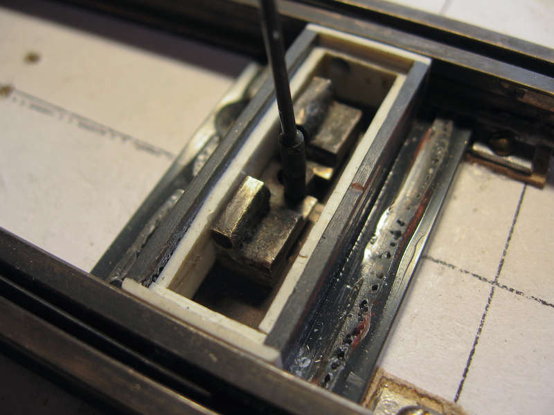

This is the inside of the switch mechanism. A spring and a switch for frog polarisation are still missing.
The prototype of the second switch was made by Both & Tilmann. This company used another mechanism to move the blades. The prototype of the switch is from Hohenlimburg (another town - another railway), where I could take some photos during research in a company's archive to find drawings of Plettenberg Rollwagen (yes - we did. Just for teasing you a bit  Roll Eyes). I liked it and so now it's placed in Plettenberg. Call it artistic freedom.
Those switches are set turning around a key instead of shifting a lever.
So I needed a key.
I hope the pictures do explain how I made it. I found a steel piece of an old micro tool with inside thread that i filed square. The piece was in the vice and I used the drill chuck to move the file up and down.
The male part was made by file too.
That's it. The parts are brazed.
That's the inlet. I made the crankshaft from a steel shaft and a brass part brazed to it. Then I filed the gap.
I hope you can see the principle in spite of the poor pic.
And now a quick look underground: A bit weird but full functional :lol: .
