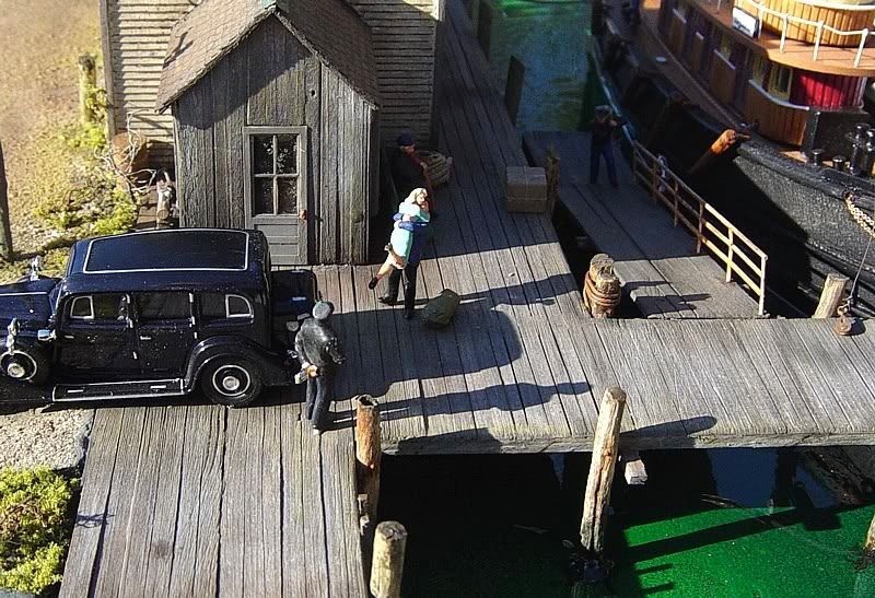

  My own favorite happens to be clear vertical grained white pine that I cut up here in the shop. My treatment is a very simple one for just plain weathered planking. I do all of my distressing with a file card and exacto. I then put a wash of an acrylic dark gray and try to raise the grain for even more texture. When dry, I dry brush the high spots with a very light gray and white. And a final shot with some powders to accent wear marks etc. in olive green and tan. This may not be the most effective but I'm able to achieve acceptable results consistently. I should mention that I only model in 1/87 to date.
Posts: 1359
« Reply #8 on: May 22, 2008, 03:50:18 PM »
Chester
Nice color but I really like the way the grain of the wood looks.  Would be nice to see the whole scene, very nice job.
