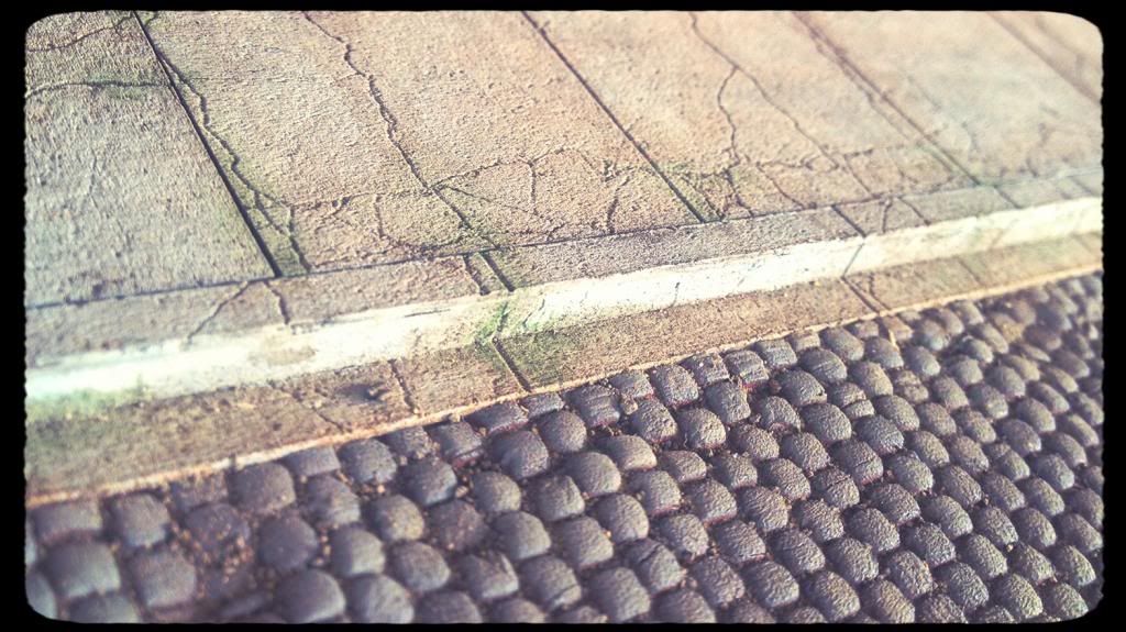

« Reply #64 on: October 22, 2013, 06:01:39 PM »
Hey Dan --
I'm reviewing your progress here (which looks great!) ... and wondering about a couple of things:
-- Did you make the curbs by joining the flat laser-cut sidewalk pieces at an angle and then sanding edges?
-- Any recollection of what you did on coloring the sidewalk pieces?  (Looks good!)
Thanks in advance!
Posts: 487
« Reply #65 on: October 23, 2013, 02:25:54 PM »
Hi Dallas,
Hmmm, time for a memory test.  Better pic first without as much fancy filter stuff...
For the shaping of the curb, I mounted the vertical face in first, then butted in the base of the gutter (knowing the join would be covered by a bit of dust and debris).  The top lip of the gutter overlapped the vertical face, with the join filled with Tamiya putty, sanded, and a bit of shaving of some worn edges with a blade.
Colouring was a base of Woodlands "Top Coat" Concrete, first coat a general wash, followed by a bit of a stippled coat to get some variance.  Once dry, used an AK dark wash in a similar manor (general coat, followed by some spotted highlights).  Used AK streaking grime as small pin washes into some of the laser cut cracks, and then a few spots of the AK slime around some wet cracks and corners.  I think that was about it.  Will still eventually come back to this with some weeds, leaves and gutter rubbish.
Posts: 1544
« Reply #66 on: October 23, 2013, 03:24:33 PM »
Thank you!  Seeing as you've got it right, that info just might reduce the missteps on this end! -- Dallas
