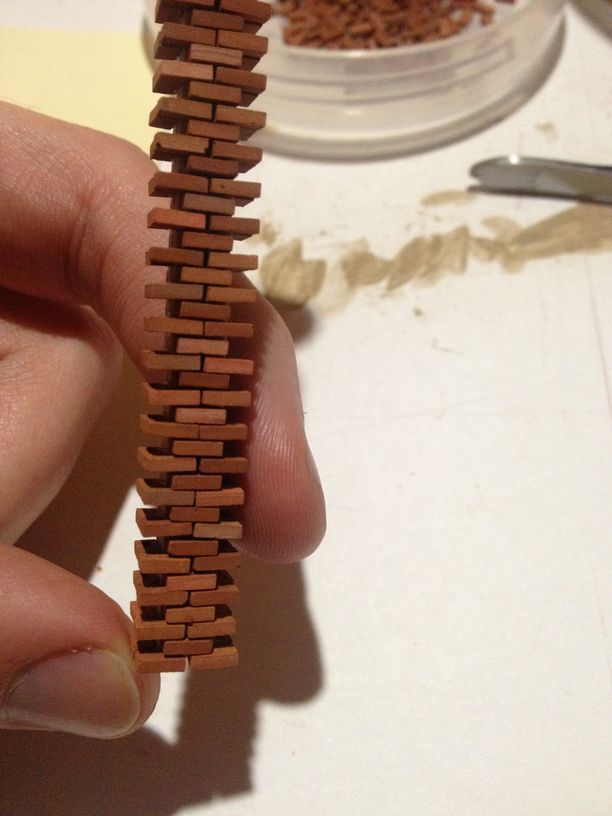

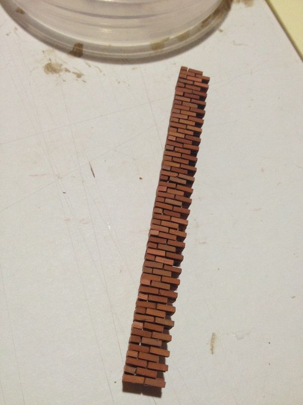

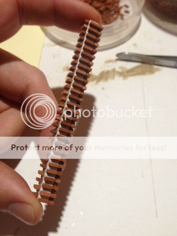

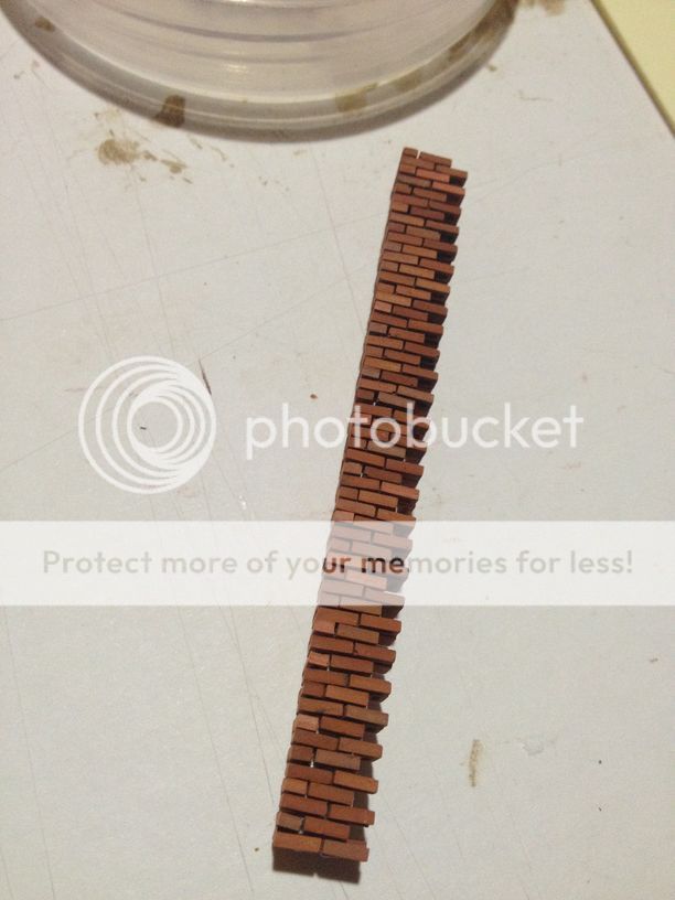

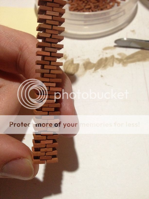

Hi Franck,

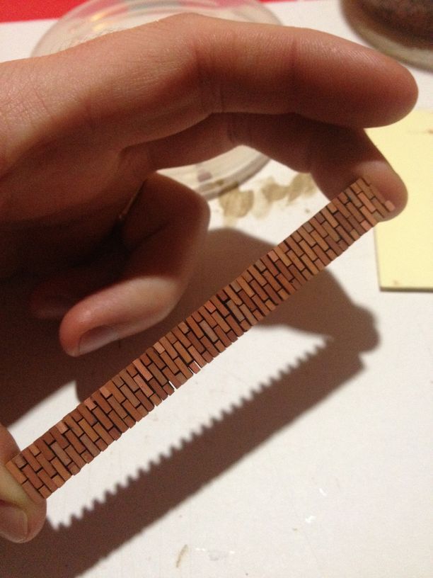

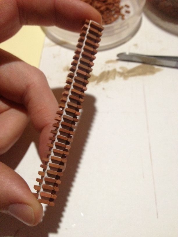

It's a Flemish bond pattern, in a slightly rustic fashion.  Have actually restarted the build for this wall.  Got to about 18 courses high, and was experiencing some noticeable sag in the wall, especially where the wall met the pillar.  Not all is lost though, as I was able to run a blade between some courses and salvage the current wall as a lower garden fence for a future project.  I have not printed out some paper template sheets to build the wall over again.  It will still be two sided, but the header bricks will be halves on each side of the paper print, instead of running right through the wall.  The pillars are being built around a timber centre.

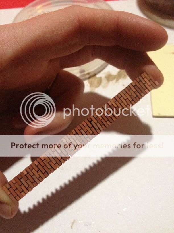

The sag could be caused by the glue soaking through the paper templates you are using as mortar courses. Try using pieces of throwaway styrene such as butter or yoghurt containers. I print the wall (brick pattern) onto address label and stick it onto a piece of scrap PVC foam board (available from outdoor sign makers). This is relatively waterproof. Building the wall both sides of this piece of plastic creates a rigid and waterproof model. Using plastics as a mortar course will also reduce the whole wall from changing shape when you add the mortar or spray it with varnish etc. I use a printed template (lines spaced 2.5mm apart and the length of the wall) for creating mortar courses that fit without being seen after the wall is finished.

There were sags and twists happening in a few different directions.  Glue was minimal, but may have contributed.  I think trying to build the without really using much form work was pushing things a bit (and wasn't using formwork just because it would have been too difficult to actual assemble the bricks into the wall I wanted, so pillar was twisting and leaning, and wall was sagging, which might have looked right for lots of the aged walls I have seen, but looked wrong in this instance).  I had some time on my break at work tonight to start gluing up the brickwork on the timber spine of the gate pillars with the paper template attached.  That went together much quicker and straighter than the previous attempt.  Don't need to put mortar spacers in doing it this way either, because the edge face of the brick is the part that is glued, not the top/bottoms.  My bricks are about 1.4mm thick, so my template spacing is 1.75mm, which is...about an inch-ish of mortar between courses  Smiley

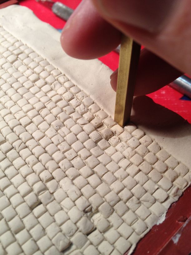

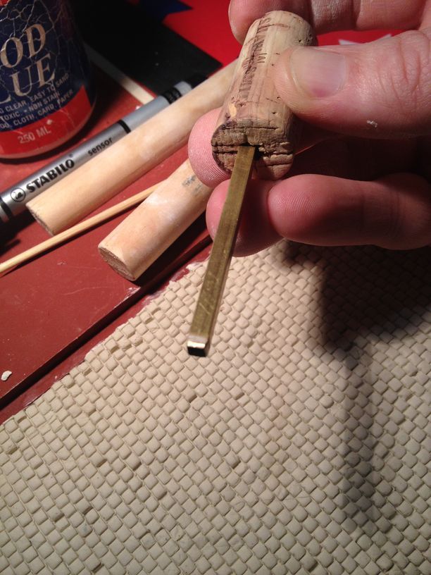

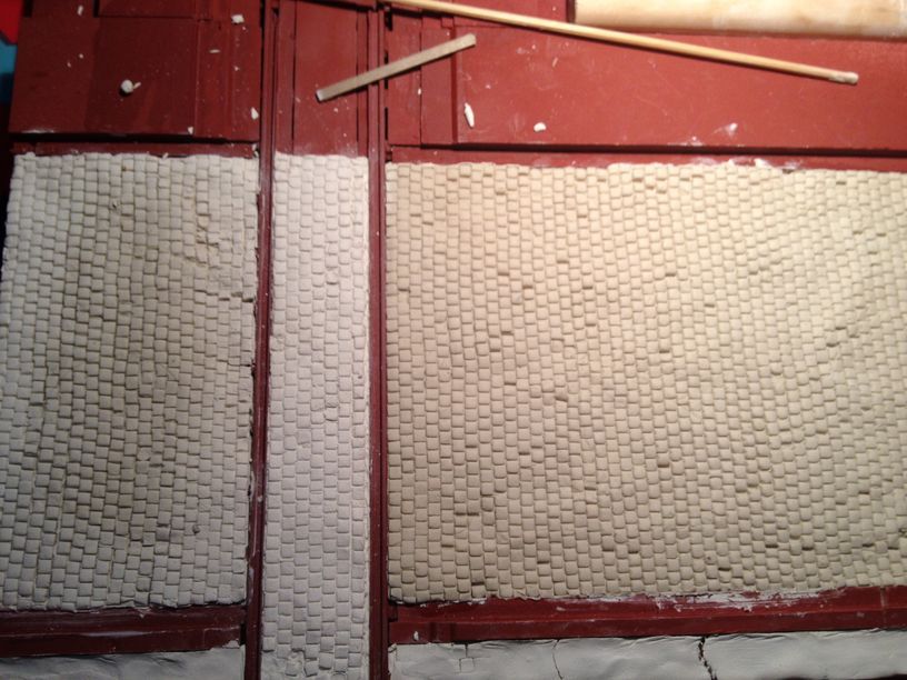

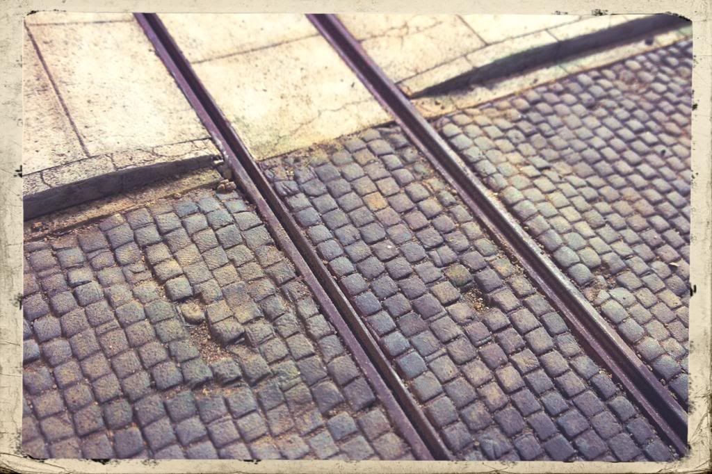

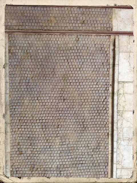

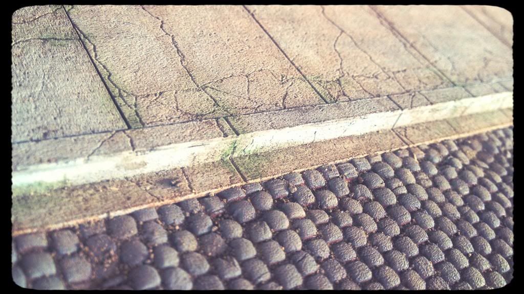

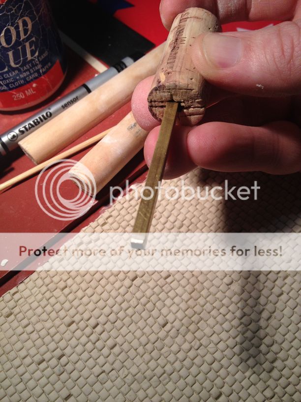

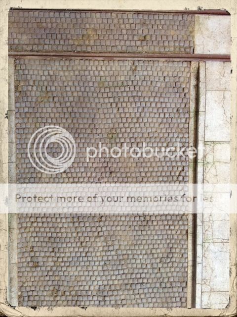

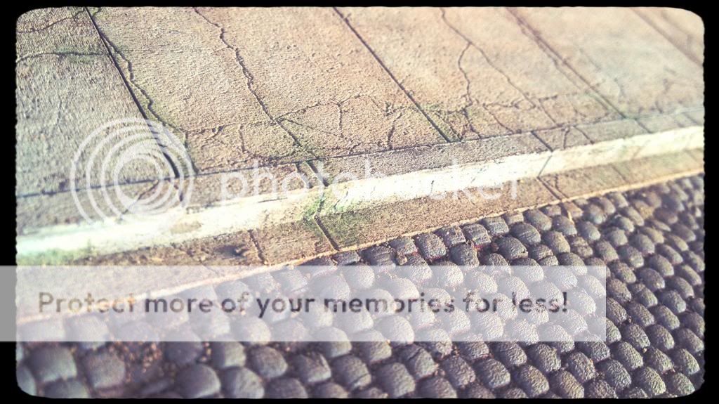

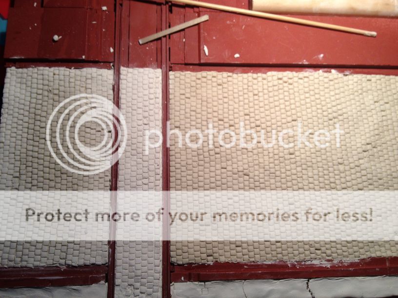

Should update where this one is at.  Cobblestone road has been pressed in.  DAS clay roughly squashed onto the road surface, and then stamped with a square brass tube stamping tool thingy.  Primed, painted, given a few different washes and highlights, then dusted and glued in some fine dirt to fill the gaps.  Still need to come back over this with leaf debris and perhaps  some small rubbish scraps collected in the gutters.  The concrete sidewalk and gutters have been done using Monster Modelworks cracked concrete laser cut sheets.  They are actually HO, but I think the cracks scale out better in O.  Once cut to shape, they have been given a couple of washes of some of the AK gear.  Again, still a bit of surface detail to go in once the wall joins up with the path.
Here are a couple of quick shots of the changes made with the brick construction as well.  Ended up using a thin styrene sheet to mount the wall onto (just means header bricks need to be cut instead of just being placed across the wall).  The gate columns have been built around a timber centre.  I printed out paper templates with guidelines on them for the brick course spacing, and glued these to the styrene and timber first, before gluing on the bricks.  Building up the columns was much quicker (about 1 hour per column), and was a matter of glue up in face, and then rotate the column to keep filling up the gaps in the jigsaw.  Much straighter and stronger results.

Nice stuff! I especially like the cracked sidewalk, really looks terrific!
Posts: 2487
« Reply #57 on: September 14, 2013, 01:45:53 PM »
Those cobblestones look great! Gad, I can't imagine pressing all those in.

i really like the concrete curb and gutter,there is something about the cobble stones a bit like bread in a bakery that throws my eye out.great job with the bricks.

I think some spots on the cobblestones, the stamp was staring to clog a bit, which resulted in a bit of a rounded top on the stones.  I've certainly seen cobbles that are a bit rounded from wear, but some of these do a that slight not quite right look.  I intend to come back over the road with a second layer of fine dirt filler, and some of the spots (like the one framed perfectly in that photo  Angry ) will probably get some of the leaf debris over to mask any issues.
