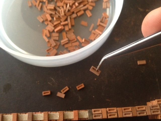

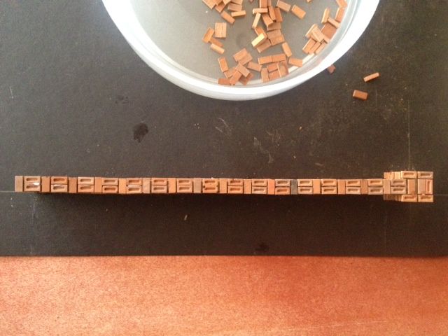

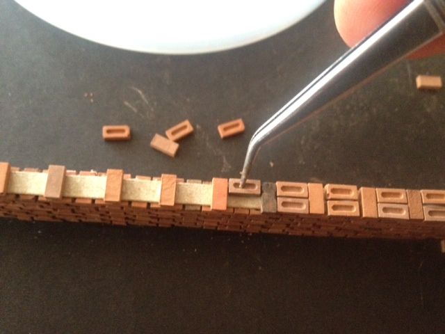

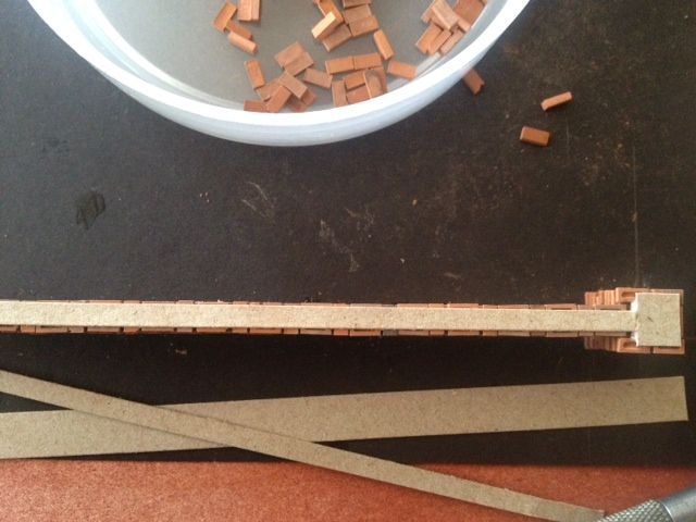

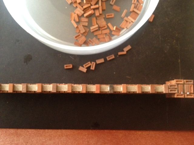

Few more courses up this morning. Just using regular PVA glue to bond it all (seems to be holding well enough, and the polly filler mortar later on will also add some more strength).
So the card layer that forms the space for the mortar join later on.
Followed by the spacing out of the header bricks, as well as the end pillar that will be for the gate and overhead sign.
Then carefully pinch the bricks by the frog (indent, and on the mould about half the bricks are solid, the other half have the frog detail, so using solids for the headers which don't need to be picked up on the corner for glueing), and fill in the stretcher bricks between the headers.
And that completes another course of the wall. I leave this about 5 minutes for the glue to have some reasonable grab, before glueing on the next card spacer and starting the process again. More coffee...
