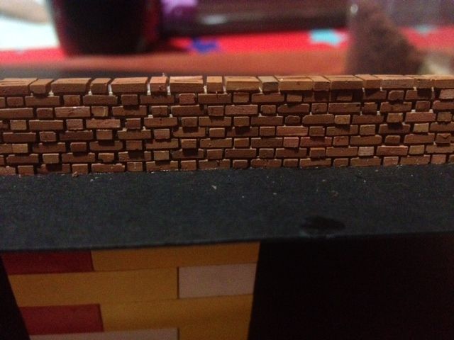

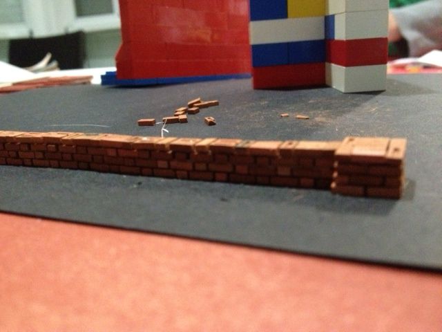

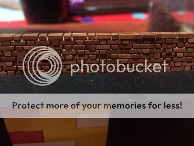

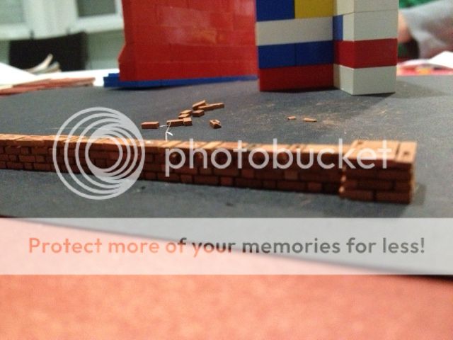

Got a couple of thousand bricks cast up now, so thought it was time to put them to use, and made a start on the main wall for the diorama.  Flemish bond since this is an English diorama  Wink , with each course of bricks separated by some 0.6mm card to space for the mortar filling.  Surprised this isn't as mind numbing as I thought it would be and got the first 2' of a about a 10' fence laid up in a couple of hours.  A whole day of bricklaying might be a different thing though!  So far, it's felt quite therapeutic...
