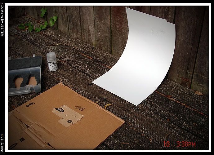

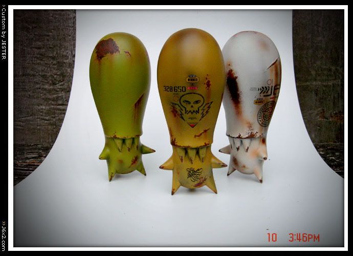

« Reply #20 on: November 24, 2010, 09:57:30 PM »
What I needed was a small cove that I could easily fit into the only uncluttered space on my work surface
Great Idea! For pics needing a white BG I use a piece of white styrene and just lean it up against the fence and deck.
I set this up on an overcast day. I clean them up a bit in photoshop as needed.
