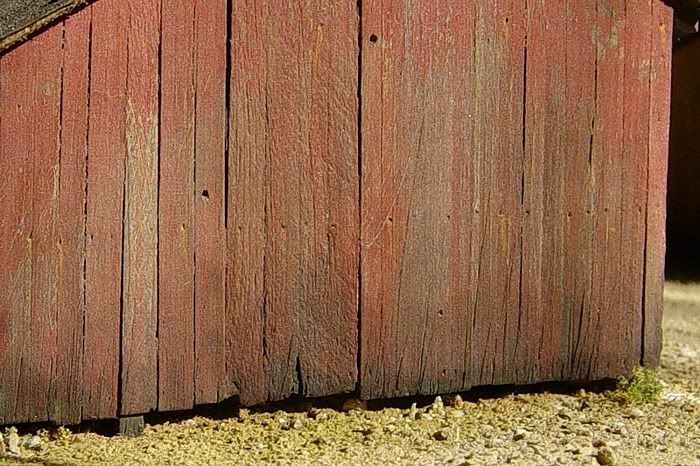

My first post here. I recognize quite a few names of a prestigious nature and feel somewhat intimidated but I thought this product might be of interest. I build reproduction furniture and have been using a powdered paint that is referred to as buttermilk paint (  http://www.vandykes.com/product/02228618/  ) to achieve my milk paint finishes. I've been modeling in 1/87 scale for many years but it never occurred to use them for my hobby. The photo below is of a board on board structure that I stained with a driftwood oil based wood stain similar to what you might buy from outfits like Minwax. I don't let the stain completely dry out and then I mix the milk paint quite thin (about 1 tsp. to a pint) and paint it on. Allow this to completely dry and then you can manipulate it with steel wool or what I prefer, a buffing pad. Just a little work with some artists chalks gave me the results you see below. Please advise if I have not posted the photo properly.

Interesting idea, and nice effect. Once dry does the B-M paint stay "cured", or is it like Egg-Tempra, and reactivates when it gets wetted again later with water?

The "milk" paint and "lime" paints are available in Europe. They are true original "old world" paints.  In the past we have ordered "lime" paints from Holland or France. We used them to paint (whitewash) a couple of old period homes we were restoring/renovating at the time. We wanted the paint to wear and fade and "age" due to the elements, just like their European prototypes.
Not relative to the milk paint, bt FWIW, we also used a technique on an English "Cotswold" manor style house, of mixing coffee grounds  into the natural gray plaster during application, this would then cause staining, leaching marks and runs....over a period of time, mimmicking the dirt/grime, water and mold staining found on original examples.
