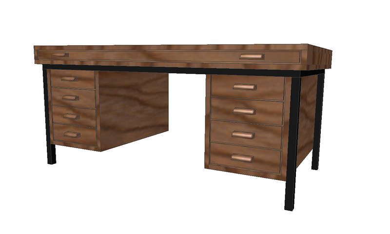

The other, more difficult point is that my consulting former Kuhlmann engineer, Mr. Wackerfuss, told me of special desks for larger offices, which could be aligned right behind the next drafting table. They had clearance for the neighbour's drafting table's weight, some drawers and a larger shelf for the biggest drawings. I made a cad drawing according to some measurements I got from him, but there's no picture available at all. I'm a bit hesitant to model those because in my estimation their design looks rather like late 1960s or even 1070s, which doesn't match my 1950s era - but I'm not sure about it. Maybe some of you guys might add some information to that? That's what they seem to have looked like:

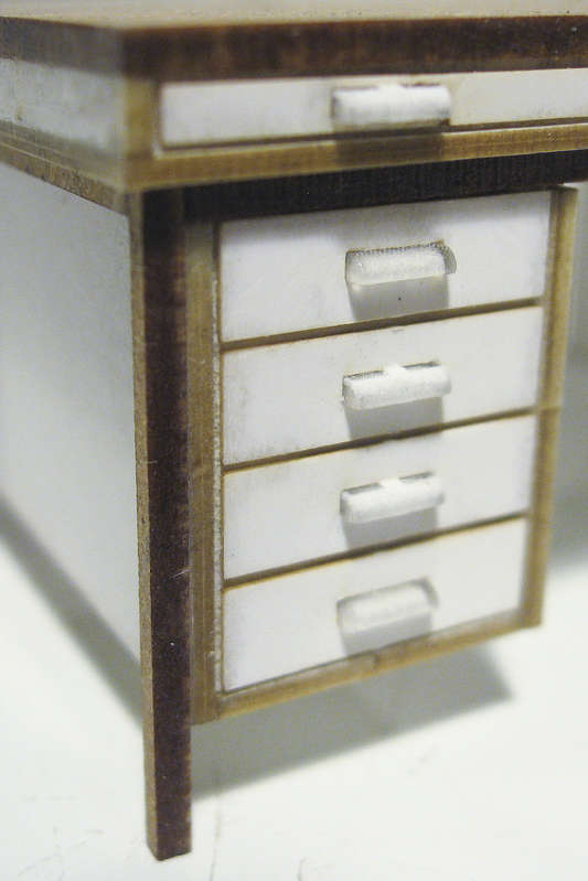

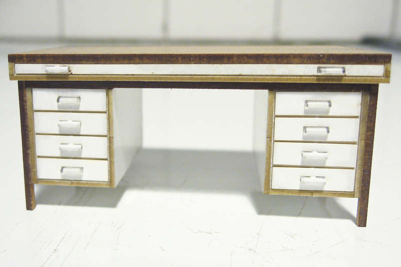

When I had the opportunity to lasercut all the windows' parts for the other project there was some sheet area available which I didn't want to have unused. I wanted to have the desks as simply manufactured as possible, but didn't want to omit any detail. The drawer handles are 3D-printed. All other parts are lasered from 1 and 0.5 mm cardboard, the steel frame and legs from 1.5 mm MDF. Drawer layers have square cutouts to house the handles and to ease mounting and aligning. I used aluminum angle section and blocks for rectangular results. After glueing all parts to the first desk I realized that first coloring wooden and metal part before glueing makes things much easier.
For sure using square brass rod would lead to a more even surface, but as said before I wanted to keep it simply.

Boxes are glued with Elmer's Glue, drawer parts with very thin CA. Edges and low sides of the upper desk part were sanded rectangular afterwards.
I'm going to color them the same way as tables in the drawing office were done (scroll down a few posts).
