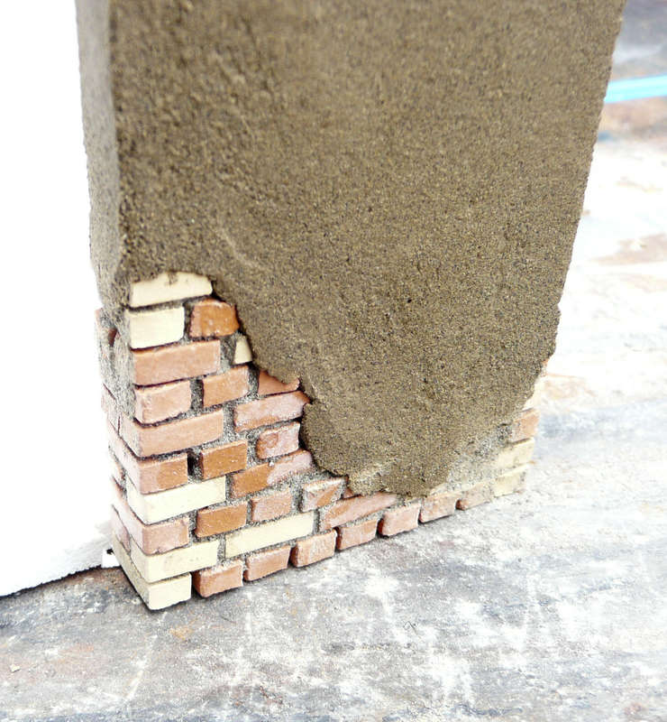

Fantastic work. Have you described your concrete and tarpaper techniques earlier in the thread?

Russ, Ray, Hauk, Bill,
thank you.
No, I didn't - thanks for asking!
Here we go:

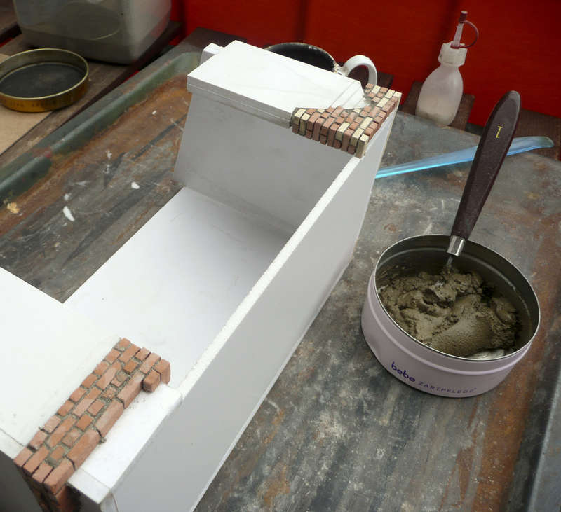

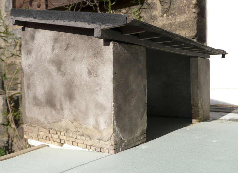

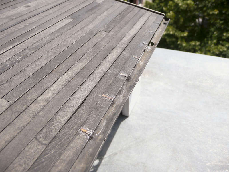

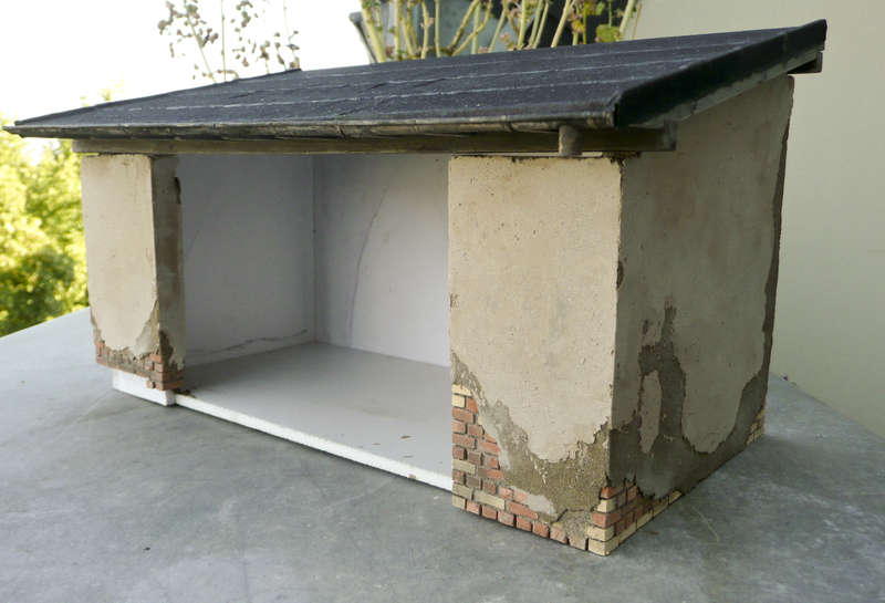

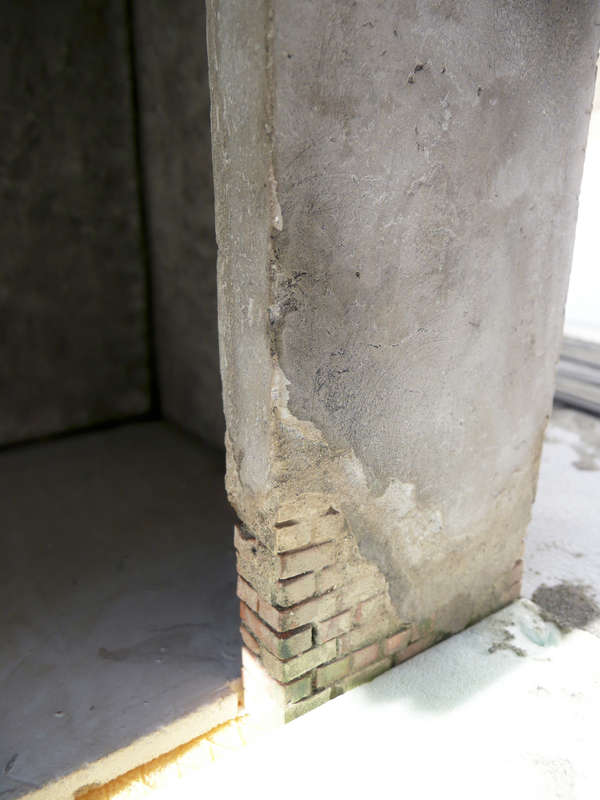

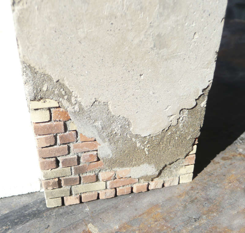

I tried some materials for the tarpaper like sandpaper or handkerchiefs but nothing worked for me: the first being to stiff (even after an hour of boiling it in water), the other with a lack of texture and so I made my own tarpaper. Base is a blotting paper sheet from an exercise book. Some strong permanent spray mount serves to fix silicon carbide, not sure which exact grid it was, maybe F 150. Once dried I used some lightly diluted black acrylic color to paint it from both sides. I found that color in a supermarket sale for 1,- €. It smells a bit like gasoil (yes, it does  Shocked). Then I'd cut the sheet to strips and take some diluted PVA to mount them to the roof. If you don't want folds/wrinkles you need to moisten the strips' back side beforehand. If you want the wrinkles go straight ahead: the strips start to wrinkle as soon as they get in touch with the diluted PVA. There's some time to correct it a bit if the effect is to strong. I didn't apply glue to the overlap and so later on I glued it with that undiluted black acrylic, mixed with some PVA for strength, to the lower strip, squeezing out the color a bit from the overlap - just as it is with tar mounted tarpaper roofs. It takes some time to adhere (My conclusion is that misleading modeling takes the same time as building the real thing, which makes it obscene in some viewers' eyes). There's a layer of planks under the tarpaper and the blotting paper aligns perfectly and that clean, that you can see the board gaps depending on incidence of light.
Plaster:
First step is to glue bricks to the areas, where they are going to be visible later on, and to grout them. First layer is a mixture of melaphyre dust, a bit yellow clay dust found in the woods, diluted PVA and some pigments, applied with a spatula.
Once dried there's a second layer of clay dust with just a bit of very fine melaphyre powder (30 years ago I took two buckets of dust home from a quarry, occasionally sifting it out to different grids. Seems to be enough for a lifetime).
The clay tends to form cracks during drying. I applied several thin layers until cracks seemed believable to me.
Next step was blending bricks and plaster by some extremely thinned clay plaster.
Last steps were sanding the surface to get rid of a few bigger grits and unevenness from working with the spatula and then applying several washes of blackish/brownish/yellowish gouache.
