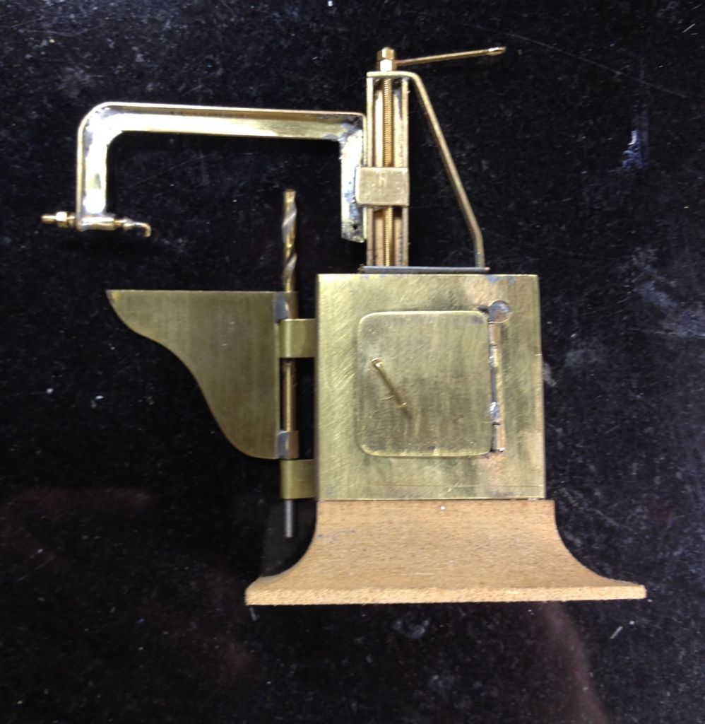

The feed raises and lowers the saw,
just like its supposed to.
Mj
Posts: 2517
« Reply #33 on: November 15, 2012, 06:06:37 PM »
it's neat to see how this worked-I had never considered it.
Posts: 1544
« Reply #34 on: November 16, 2012, 12:30:34 PM »
Well, crap, that's nifty, clever & nutty all together!  Wink  -- Dallas
SandiaPaul
Posts: 345
« Reply #35 on: November 17, 2012, 07:26:58 AM »
Hey and it's an upside down drill press too! Wink
Nice metal work!
« Reply #36 on: November 17, 2012, 05:00:57 PM »
Lol
I wondered who was gonna mention my drill
Or my prescision 9/32 pin.

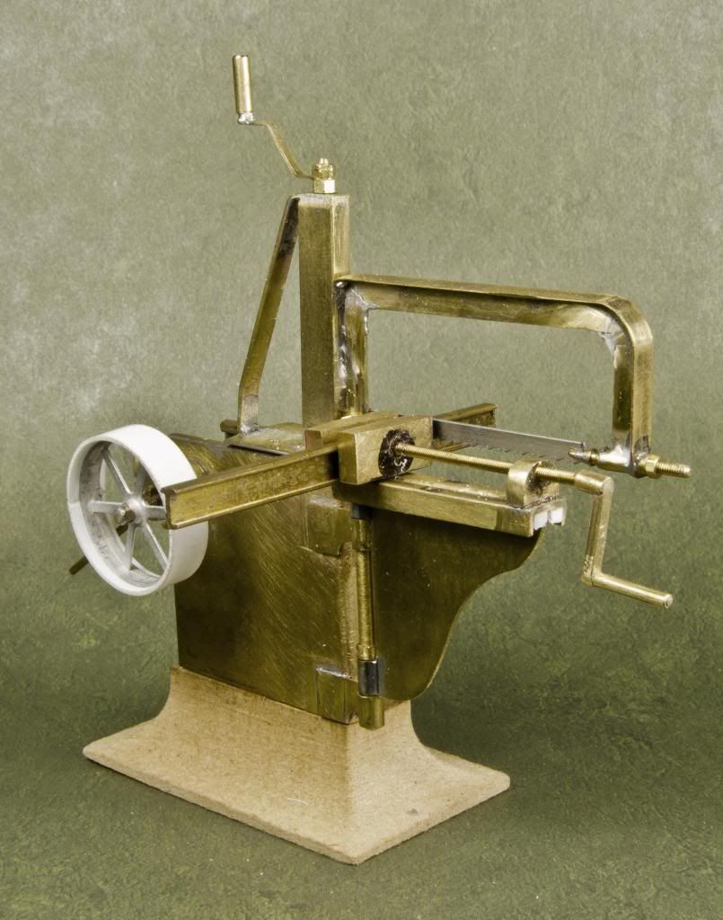

« Reply #39 on: November 23, 2012, 12:41:27 PM »
Thanks Russ,
You had some great tools!
I just recently obtained a No. 0 hand operated
drill press. In the process of restoring it.
I would loce to have a few flat belt machines (1:1) someday.
Someday.....

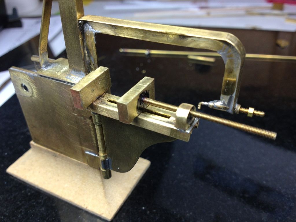

« Reply #40 on: November 27, 2012, 03:55:11 PM »
Nothing earth shattering but did manage to finish the vice.
Works like it should, of course  Grin
More complex to solder up than I expected.
Now on to the handle!
Posts: 2517
« Reply #41 on: November 27, 2012, 04:00:27 PM »
What do you use for soldering? torch, iron etc.
« Reply #42 on: November 27, 2012, 05:26:31 PM »
Chuck,
I usually "tin" with a gun then use a micro torch
to do the final joint.
I also have a pencil for finer work.
I really need to save up for a resistance rig (or build one)
but continue to make do.
Posts: 620
« Reply #43 on: November 27, 2012, 08:49:06 PM »
After seeing the latest Modeler's Annual, I want the dental spot welder used to make the V&T Passenger Car handrails.
You can make a resistance soldering center with a 12 volt car battery and a couple of carbon rods from the local welding shop.  I suspect I might be able to do the same with a couple of copper rods and a foot switch.
Maybe one of the mechanical wizards on the forum could lead the way.
We once "smoke tested" the controls on a friend's model railroad with a 12 volt car battery and burned up most of the cheap,yard sale push buttons he was using to control it's turnouts.  There is more then enough power in one to power a resistance unit or spot welder.
« Reply #44 on: December 02, 2012, 12:03:52 PM »
Construction is finished............sort of.
I see i forgot the bolts to hold it to the floor.
Also the pulley has been bothering me since I started.
I hope to find the right size raw material to make a new one in brass.
I'm thinking a 3/4" compression ferrule would be a good start.
BTW; working on the big a$$ walls but going a lot slower.
Mj
