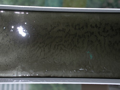

Hi Peter,
I have used polyester resin...On top of a Plexiglas/perspex base I added layers of resin (be aware that it shrinks a little as it cures) with powdered pigments in the lowest layers because I was modeling dirty canal water. I blew a fan over the curing surface to make ripples and it worked like a dream. I used Future floor polish as a top coat and it looks great at first, but after a year it developed a heavy cracking pattern. I removed the Future with alcohol and cotton wool and applied Golden acrylic medium and everything as been fine since. I used a thicker more viscous Golden acrylics to fill the space between the water and the wall.  I use polyester at work all the time and it can be shaped and polished easily.
Here are some images FYI
This is a top down view of the dirty "water" i.e. the initial layer of polyester and pigments

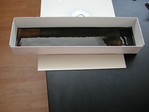

How I prepared the "water" separately from the rest of the base. This meant I could cut it to shape and remove the unwanted meniscus at the edge

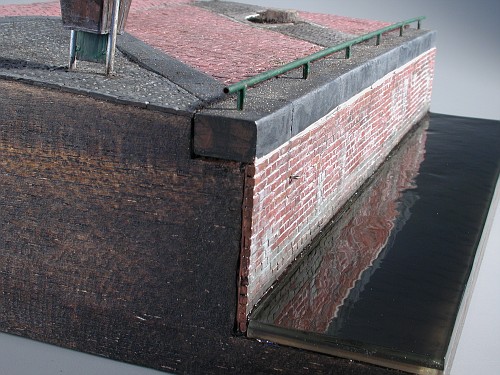

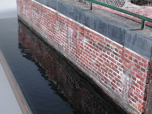

after installation
I hope that helps.

Bill, I think my layer of Future was too thick, and its this that led to the cracking.

very nice water great bricks

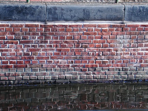

First, thank you all for your assistance in this topic. Searching for information on the internet leads to the conclusion, that either of the methods have their advantages and disadvantages.  But my specific case with very shallow water interspersed with lumps of stone and debris at the river banks and river water buttercups (Ranunculus fluitans) rules out one or two approaches right from the start. That means, I have to poure necessarily some sort of liquid around and on top of those debris.
@Narayan
Love your canal and especially you brick wall very, very much. IMHO one of your best dioramas, and a convincing argument for polyester resin. The gently rippled surface is exactly what I am looking for! But ... unfortunately I can't do the water separately from the rest of the base for the reasons I mentioned before. Good to hear, that blowing air over the surface worked so well!
Here again the original:

Bottom line; that brick wall and river looks real to me!
