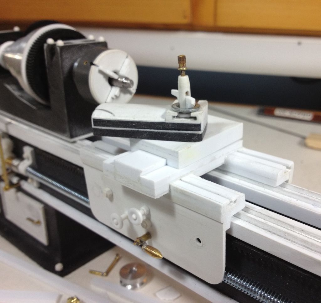

OK Marty you asked for it!
The carriage hand wheel is too small! I'd say about 1.5 to 2 times bigger would be about right. Plus it needs a knob on it.
A lot of older lathes didn't have a round wheel type, but used a similar style knob as the cross feed knob. See my pic attached. Pic is at Greenfield Village shop.
Also you will need the 4 jaw wrench and the wrench for the toolpost. Plus other junk like strap clamps for the faceplate and such.

Thanks Paul!
I am planning on the wrench for the chuck!
I had a (similar to the pic) crank but liked the handwheel better, I'll see what I can come up with!
As this is older may be I will go back to the cross bar crank, also easier to make! Grin
Also looks like I need some screws on the side of the tool post slide.
This is a great picture, wish I had seen it a month ago!  Wink

« Reply #65 on: October 08, 2012, 11:48:14 AM »
Great job but I suggest you really beef up the cross slide and compound.  If this were a real lathe it would chatter and probably break a lot of tool bits.  The cross slide should be much thicker and longer,  The compound should not sit on top of the tower but down on the cross slide.  The distance from bed to center should be taken up by combination of cross slide and compound thickness plus some of the tool post lantern as in Paul's last picture. This will be a nice looking lathe when finished and painted.  Keep up the good work.
Bill

« Reply #66 on: October 09, 2012, 09:51:15 AM »
Thanks guys, just wish I had known sooner my carriage was lacking.<bang head>
Currently in the process of beefing it up, I hope I dont have to start over......

« Reply #67 on: October 11, 2012, 03:31:31 PM »
Thanks to Paul and Bill I have made the necesary improvements to the cross slide.
Also the carriage feed ( not shown).
I appreciate the feedback. Hopefully I am near to paint now.

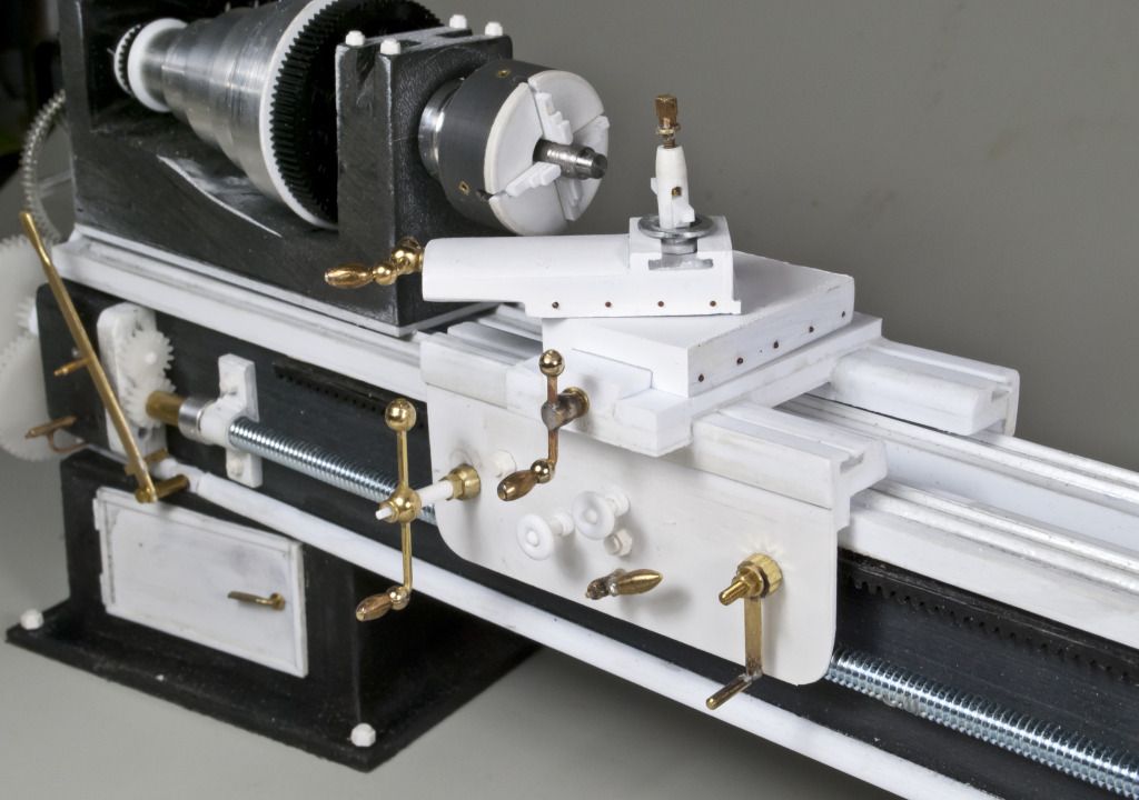

Posts: 2081
« Reply #74 on: October 18, 2012, 03:45:19 PM »
The "refined" carriage & cross slide.
Now (hopefully) I can get on to coloring..........
