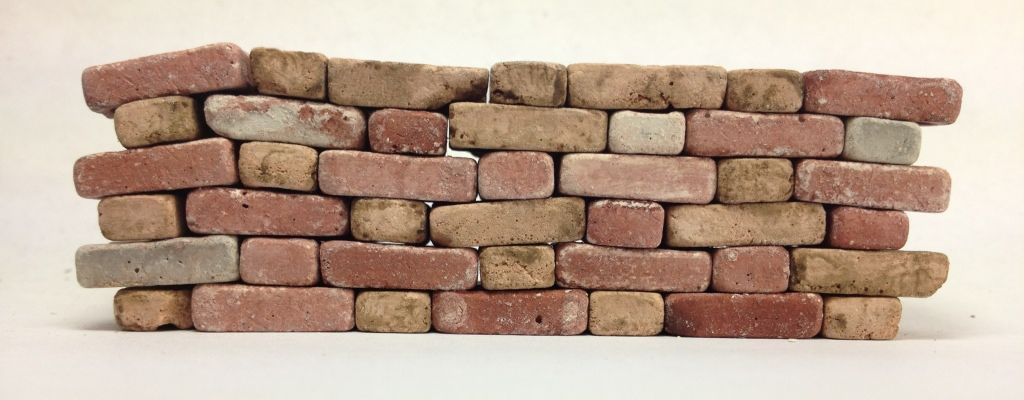

As noted elsewhere I ordered (July 29th) and received (Aug. 6th) the "German Standard size brick mold
from dioramadebris.
The mold is a light grey silicon mold with 36 cavities for bricks.
The mold is is approximately 4 1/2" by 2 5/8"
The bricks are;
.592" long ( 9.472 scale inches)
.289" wide ( 4.624 scale inches)
.169" tall   ( 2.704 scale inches)
I hope to obtain some concrete coloring stuff to do them the right color form the beginning
like NickO does.
After they dried I put them in a container with some screws to beat them up a bit.
Then they were "stained" with thined craft paint.
No spacer for the mortar just laid out.
I'm hoping there will be no bubbles when I spray the mold properly; my atomizer disappeared Angry

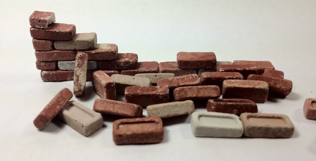

The wall here is 1" tall and about 3 1/2" long
Here you can see the recess under each one (I'm assuming) like real bricks?
I dont know squat about bricks so I am hoping NickO will educate me.
Hope this is of use to others.
I'll post more when I can find some "colorant".
I will not be doing entire walls of individual bricks in 1/16 no matter what you guys call me!!!!!

   The recesses in the bricks are called " frogs" (don't ask me why , 'cos I don't know) .
    Don't try and knock the edges off to many bricks as it doesn't look right .

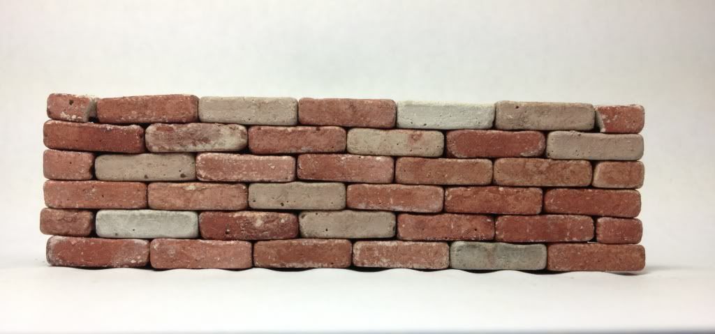

« Reply #8 on: August 08, 2012, 04:39:14 PM »

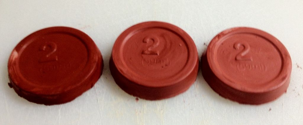

I swung by the local home center.
Picked up a one pound bag of red Sakrete cement color.
Here are the results mixed at a 1:16, 1:32 & 1:64 ratios
Concrete color to plaster by volume
And a Flemish bond (I hope) Huh Undecided
« Last Edit: August 09, 2012, 07:36:33 AM by lab-dad » Logged
Posts: 539
« Reply #9 on: August 08, 2012, 08:27:25 PM »
I like the colors now, a little grey and black and you’ll be close, these experiment colors are terracotta like?
