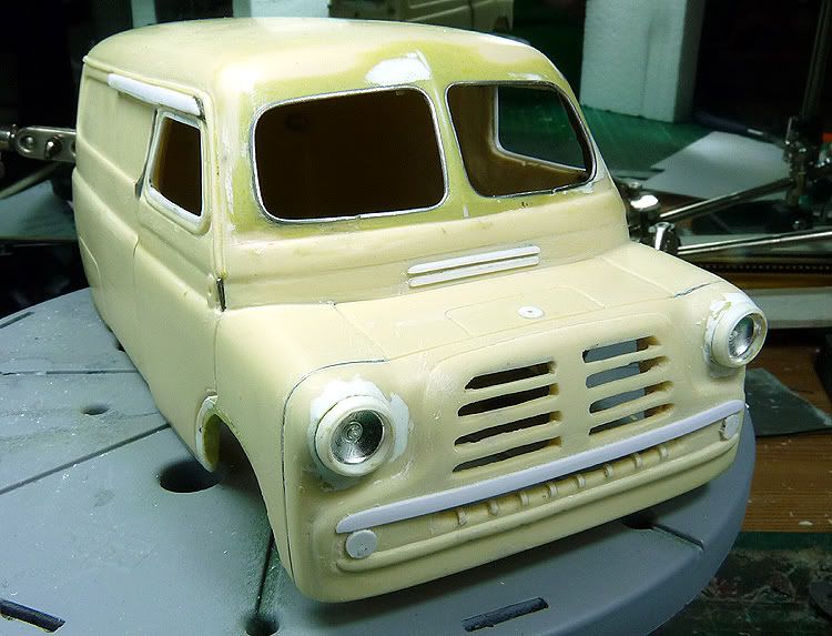

Right then after firckling around the back [!!!] I thought it time to move back to the front - and groan - now I remember why!!
Just look at those headlights??
Everything is just so soft and wrong, now I'm realistic in my abilities to repair these discrepancy's and even though I get frustrated at my struggles to achieve what it is I'm after ............... I just don't seem to be able to invoke the FI factor and simply move on!
 As a quick aside you might notice I just had to get rid of those louvres and replace them with something a bit more robust.
Also ...................Those resin bezels were taken off and I sourced a new pair from the spares box. These were offered up and bedded into a dollop of Green milliput - taking care to orientate and align them.
Once the bezels were removed it gave me a new set of headlight buckets with which to reshape the front of the wings - probably not picture perfect but a much more sympathetic shape considering the original. ......... [Even these just look better don't they, or is it just me]?
Once dry they're given a basic shape and then a topcoat of "white" putty [so I can see where I'm going/been]. Just smoothed at the mo' with a wet finger??
Bezels back in so I can finalise the shape of the wings.
And then with a large part of the shaping done. There'll be more obviously but absolute final licks will be done after some primer-filler coats so I can really see what I'm dealing with.
Might be worth noting that there is a new trim piece [upper lip] - this just makes the lower lip now look all bad - and I'm really resisting the temptation to rip out the grille and replace it with a new sheet one [groan].
It's starting to look better though isn't it ------- Isn't it?

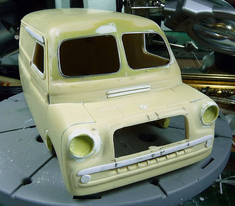

Well, I succumbed to my apparent need for self harm! - and decided I really couldn't live with the grill - truth be told I couldn't ignore how bad it was right from the get-go as they say. But I was hoping that I could "go blind" regards the problems.
However, having posted this about - I cross pollinate a couple or so of boards [apologies to those that are present on those boards also]. The general consensus was that I should give it a go or live with the regret - and I think that's what swung me......... knowing that I didn't do it when I could of.
Anyway, here's how it started........................
This is what I'd arrived at - and in hindsight it was even worse than I'd remembered - it's no wonder I was a bit downcast by it!!
And this gives us a little insight into the less obvious problem!!

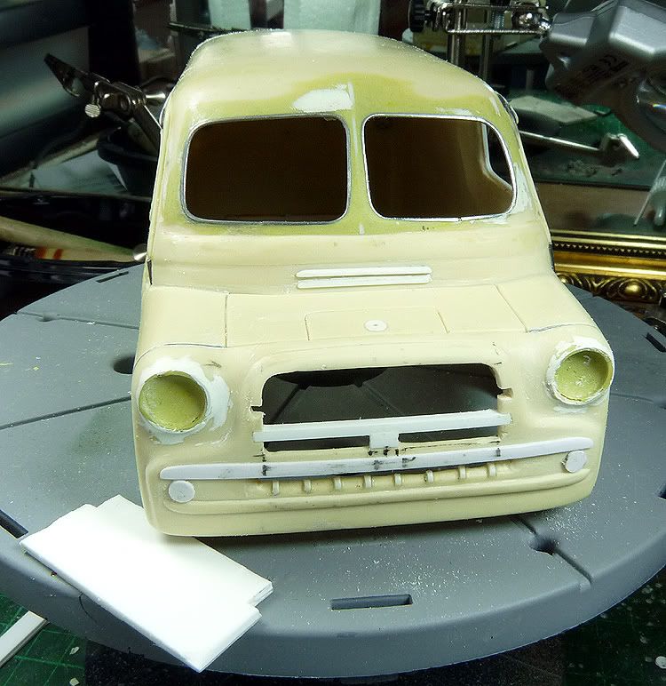

Once the grille is marked up on the vehicle you can see how the kit grill is pyramidal in its nature - the actual grille is if fact parallel with just two nostrils above............ you'll see at the end - and what a difference it makes subconsciously.
Open wide!!! .............. this was harder than it looks than just cutting the hole into the model. I spent quite some time working out the spacing and just what I had to work with in order to make it look right - there's a bit of fudging going on over the assembly but it came out better than it was - I think/hope?

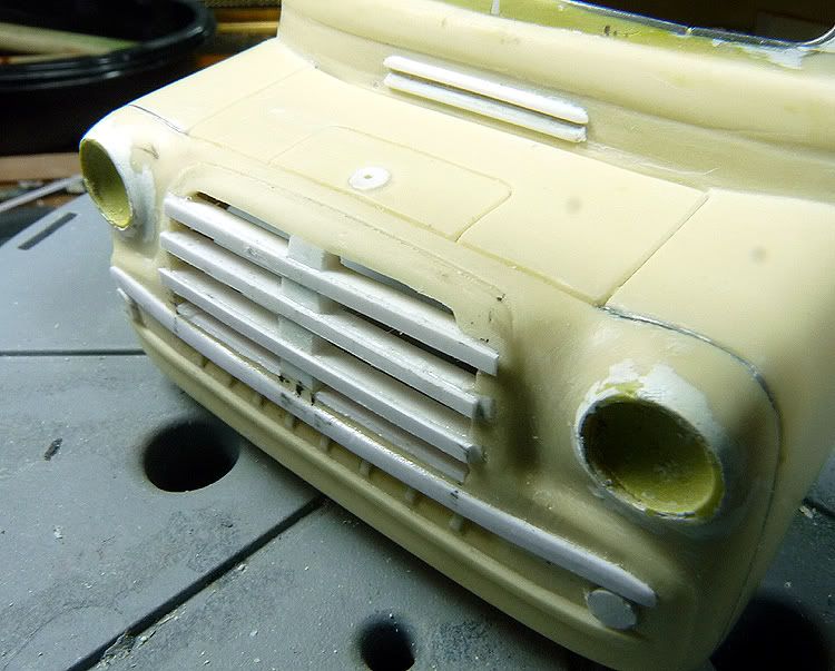

And speaking of assembly this is how it happened - basically cutting over wide strips these were "notched" into the grille opening and then a spacer placed below and than above to give support and provide the basis for the central wide bar that appears in the original.
Bottom left you can see the little tool that I made up in order to make sure the next "notch" above was both accurate and level for the next bar.
This was frustrating - I was so wrapped up in getting the spacing right I'd completely overlooked the depth element of the grille. and there is a marked "proudness" to the centre of the grille leaving a decidedly unflattering "flat" look to it. Thus I ended up "skinning" the grille bars in order to give me the necessary depth to sand back into; and I was quite annoyed with myself too as I know from experience the more you introduce and fuss at something the more opportunities you find for buggering it up.

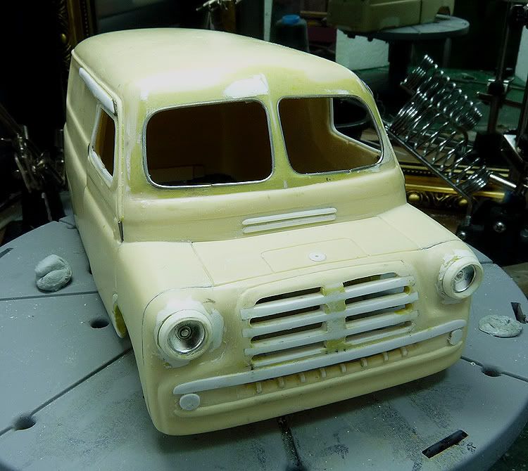

BUT - after much fiddling, filing, filling and sanding - we arrive at something akin to the original grille, the radiused ends were just filled with a bit of Milliput and then "swizzled" with a  wet drill shank - once cleaned up I think it worked remarkably well?
It's much neater now, both the height and depth of the bars - and see what I mean about the parallel nature of the grilles - much better - huh?
I'm close to the point where I have to put it into primer [eek] which will no doubt make some of it look better for pulling it together - and worse because it'll highlight those many flaws I know I'll find.
You could of course probably pick this to pieces as it is - but I'm calling it done - and so you don't have to scroll back up and back down here's the starting point again....................
