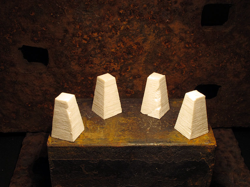

G'evening all,
after having successfully completed another attempt ...  Wink ... I have a (different) result too ...
... but I think it is still in need for improvement (that's the part me asking you for feedback  Grin) ...
One thing that really keeps annoying me are the tiny cavities you get while treating the Hydrocal with a wire brush ... you can drench the whole item with thinned colour ... and still there are some cavities shining bright white!  Tongue Not quite shure yet, if it is a question of adherence ... or if the colour simply does not even reach particular cavities ... Huh ... the latter opportunity is hard to believe, because the items did get several layers of colour!

Those last pieces look quite fine!  Before you make yourself crazy examining them ... try sitting them against some sort of finished building or into a bit of modeled scenery ... just to see how they look "in context" (surrounded by other things).  -- Dallas

Gerald, you said
>>One thing that really keeps annoying me are the tiny cavities you get while treating the Hydrocal with a wire brush ... you can drench the whole item with thinned colour ... and still there are some cavities shining bright white<<
Am I right in assuming the hydrocal is a powder?
if so perhaps you could try a little dilute grey acrylic in the water when mixing
I now dont mix powder fillers without it , unless I WANT white  finish

... if so perhaps you could try a little dilute grey acrylic in the water when mixing
... spot on ... I'll do so the next time ... I suspect it's kinda question of "surface tension" with the Hydrocal - common plaster seems to provide a better absorption of the water colour or acrylic colour respectively ...

« Reply #36 on: May 11, 2012, 04:35:23 PM »
Some fairly good luck eliminating those pesky white spots by diluting chalk powders in alcohol. One needs to keep the chalk in suspension (stir) but it does seem to seep into every pore (poor pour).
Posts: 1544
« Reply #37 on: May 11, 2012, 04:57:52 PM »
Try mixing some acrylic color into water ... then use that colored water to mix your plaster.  It might take a couple of tries to figure out how much color you need in the water, but that would allow you to get it mixed in and have color inside the plaster even when it chips.  -- Dallas
