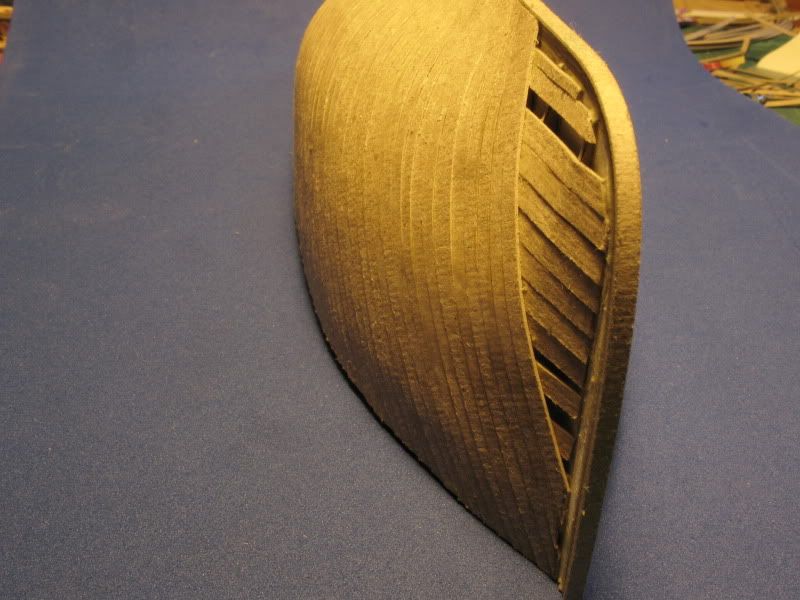

Learned a bit about the grain in the card today. I cut a few more strips on the cutter, and noticed how they curled. This can be a benefit or not. To get the strip straight I pulled them through my fingers a few times as you would a piece of wire to either straighten or impart a curve.
Then glued on three strips to increase the size of the keel, Gordon had mentioned adding to the keel in an earlier post.
I then added a wider strip to create an edge, this allowed the diagonal planking something to butt up against at the keel.

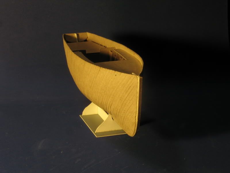

That last shot Michael would make a great little slip way scene of a cutter under repair.

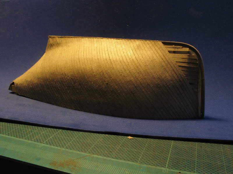

to that end I did complete the diagonal planking at least in one direction this afternoon.
The process was a bit of a meditation, glue, place, hold, then repeat for the opposite side. I did notice that one side was getting a bit further ahead than the other , so I cut some tapered strips to play catch up.
Eventually I finished up the planking.

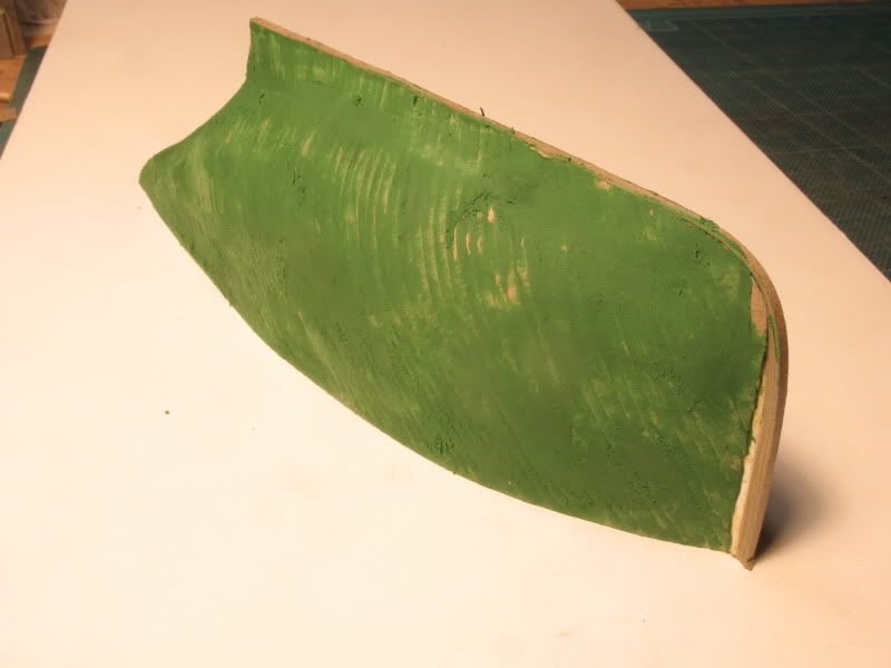

Next I smothered the hull with some Green Squadron putty,
After the hull gets faired, I will paint it white and then proceed to ad the final planks. formed from the 2 ply Bristol board.

Gordon, I am not familiar with the issue of Marc's favourite putty, so cannot comment however I don't want to upset anyone so I have switched to my favourite filler red bondo spot and glaze putty.
In retrospect it would have been wise to have used a penetration sealer on the card before using the putty. Another lesson learned.
After I sanded the putty down there were all sorts of fuzzy sections. this was then painted with some latex paint., left to dry long enough to sand, (I use the reduced hours and minutes that all impatient guys use)
then covered the hull with the red spot putty. very thin and spread with a scrap of card.
Re-sanded the hull, the thing i like about the red glaze is how fast it dries.
Then gave it another coat of white latex paint.
when this dries I will sand and reglaze.
