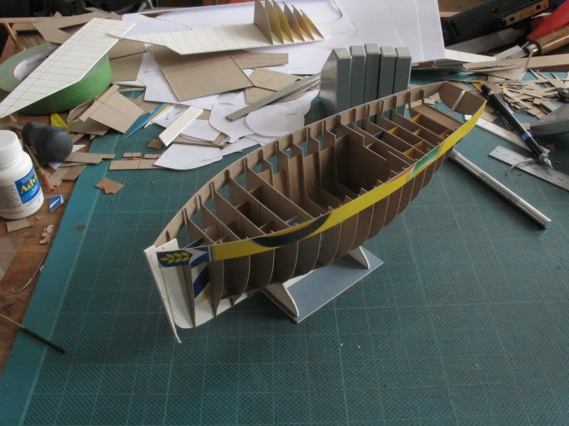

Ok being  glutton for punishment, I am continuing the steep learning curve. it is a good thing that i have all sorts of tools to butcher with! Some wine helps!!
I had to scare this chap away this afternoon as he thought it would be a good thing to eat the Boxwood tree that I planted on my little garden railway.
There was also a wild turkey rummaging around Oh the joys of living in the country.
back to the boat.

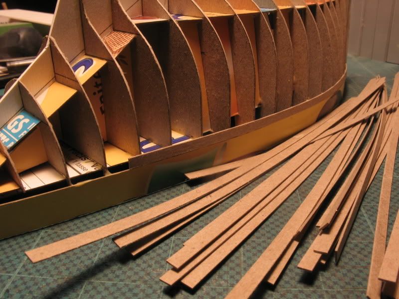

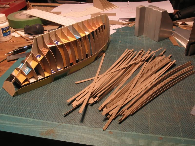

Using my incredible IDEAL http://www.ideal.de/component/option,com_idealproducts/cat,159/Itemid,100159/lang,en/ paper cutter that I found at the "Take it or Leave it" at my local recycling depot This tool is absolutely awesome!
I cut some planks from a gift box card.
and started to glue them up.
A lot of time holding the planks in place with my fingers,( greatest clamps in the world for small stuff) fingers that is.

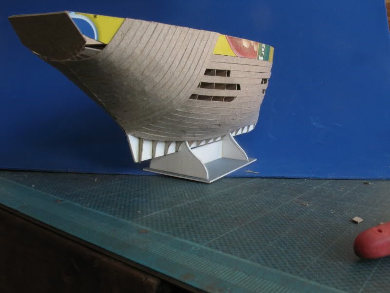

Posts: 339

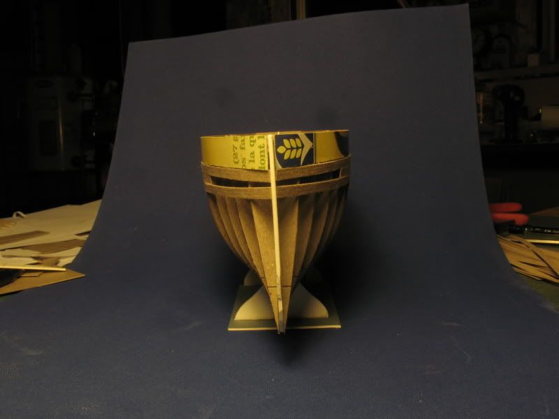

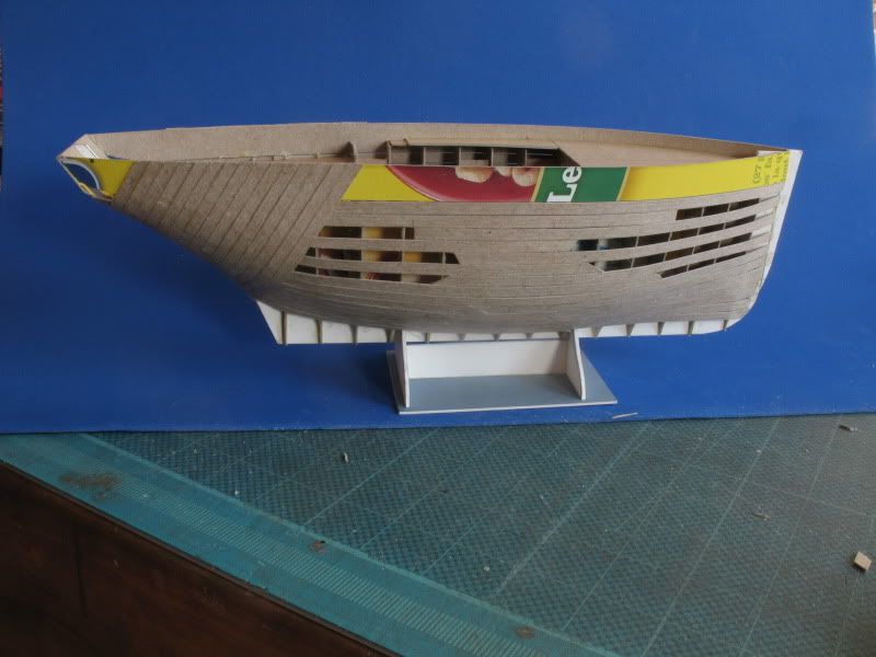

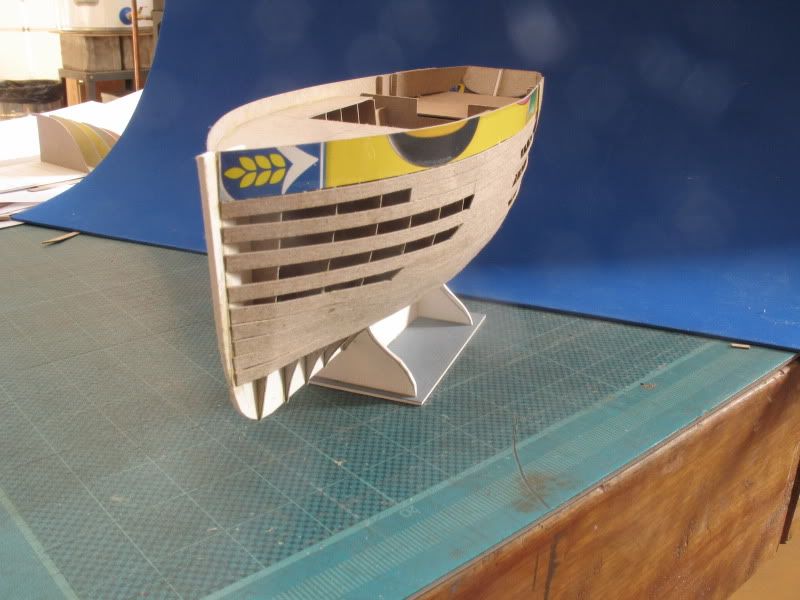

« Reply #23 on: March 01, 2012, 05:58:35 PM »
Managed a bit more planking,
At this point I decided that some diagonal planking would make the stern much stronger.
and from the bow
The diagonal planking is making the model very sturdy.

Gordon, yes there is some detail on the small low deck house nothing on the interior , there is lots on the web though.
Russ, I was thinking along those lines initially, but I am thinking that after O have finished the sub planking I will fair the hull and paint it white then I will draw the lines of the planking and shape them to fit so that the planks have the correct shape. On some small craft you can see those oakum calking lines and they show. Once the hall is smooth it will be easier to place the thinner bristle board planks. I have noticed that the soft gift box card can be shaped reasonable well. On a smaller model like this, I would cut narrower planks in the future. I see this model as a way to learn what my limits are and what to do better in the future. I am going to see how far I can push the card, including the mast and spars.
The biggest lesson so far is regarding the shapes of the stations. It would be important to use some thin card strips to check them before gluing every one in place, The first station on this model is a bit out and would have been better if I had reshaped it early on. At the midsections they are very similar and the planks seem to fit pretty well, at the bow and sterns are where they get tricky. I can also see now why the early boat builders used sectional half models to confirm the lines, it is tough to confirm 3d compound shapes on 2d flat paper drawings.
