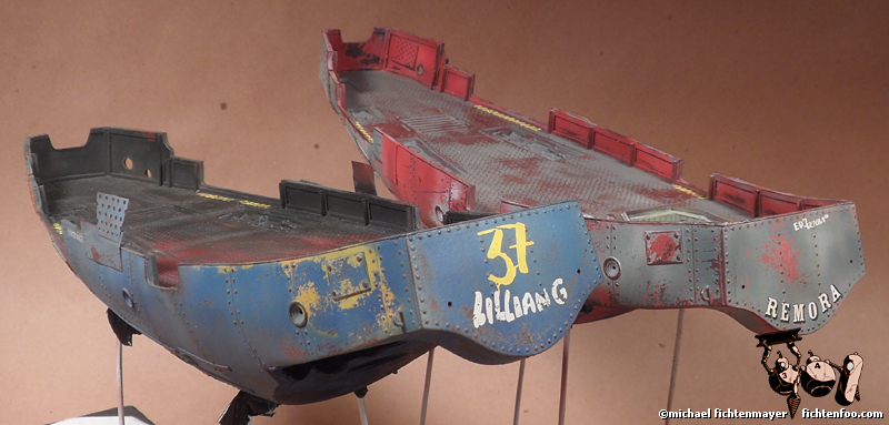

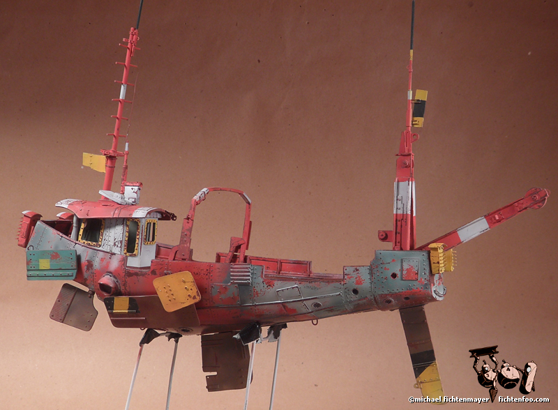

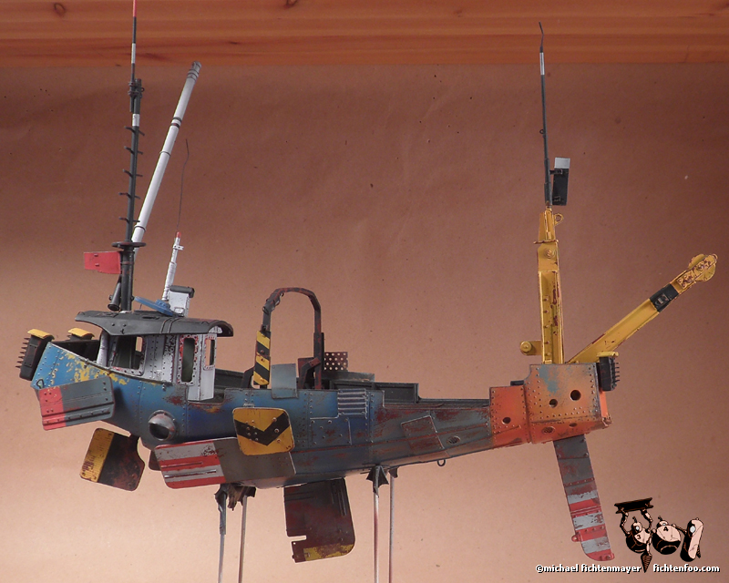

Thanks guys! More progress pics for the 'Remora' and 'Lillian G' as they're named. Finished the paint and chipping, added decals, and started filters.

Michael ,
   I am really impressed how your Remora/Lillians are coming along and only hope I am able to do justice to your excellent kit . So far I have primed and rusted everything and have started to topcoat paint  some of the fins . I shall be taking it slowly so that I stand a better chance of not mucking mine up .
   I regret attaching the central light gantry as it makes things harder to paint in that area but I'm sure I'll cope . I think mine will have more red and white on it than other colours , trying to keep it simple .Although I know I am bound to be influenced by what you have done and will probably copy some of the details . I must admit looking at yours reminds me of a mediaeval jousting competition with all the knights hanging their shields onto the sides of the boats !
  The really great thing about building something like this is that you are not constrained by prototype colours . The military modellers , and to a lesser degree railway modellers , have a pretty limited palette of colours they can chose from , so it is very refreshing to be able to go wild and paint the model in any colour you want and there is no one who can tell you that it is wrong .
  I have a question . You like many other modellers use Future Floor acrylic as a sealer coat , can you tell me why you use this in preference to any other product , such as a matt varnish ? Can I get by with using something else or will my model be ruined if I don't use Future ? I know the formula has been changed fairly recently , is the new stuff as good as the old ?  Sorry , that's three questions .
  I am beginning to work out in my head how I hope to display my model . Originally I was going to have it tied up to just part of a floating island , but now I have decided that I need to build the whole island . It will only be a small island , maybe 12-15 inches in diameter , but it will have evidence of previous human occupation . It will have broken away from the mainland and will show evidence of underground workings . I hope I can make this work and also get it done by mid-March . The reason for this is that there is a competition on another forum that closes then and I hope to submit it for consideration . The joke is that it is the Railroad Line Forum and all the other entries will either be kits of buildings or rolling stock . No doubt now that I have let the cat out of the bag here news will filter back to that forum and I will be drummed out of the contest . But , what the heck .
   Keep posting those updates as I need constant inspiration ,
