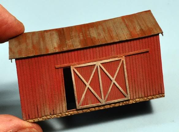

Big thumbs up to Mig oils and pre mixed oil washes!  Got a box of goodies a few days ago, been experimenting with it, works as advertised.  All sorts of interesting effects possible.  I'm very happy with these, as they are priced about the same as art store oils & thinners, but work better as washes and the colors are pre mixed for weathering.
This 1/160 scale leaning barn is base coated in craft store acrylic, then washed in various Mig oils to highlight the stones and individual planks.  All the weathering and rusting effects on the roof is Mig oil.   Seriously, the weathering effects here took a total of no more than 10 mins of work, not counting drying time.   Stuff works great!!
Thanks for the recommendations!

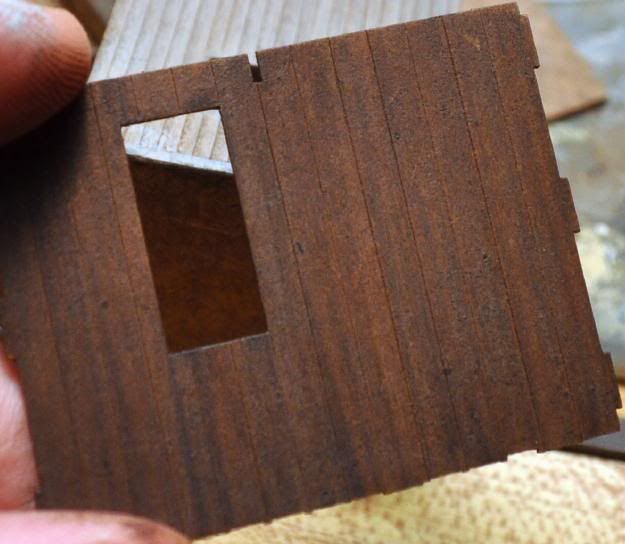

Here is a scale wood grain effect I got by brushing streaks of thinned out Mig shadow brown over craft store acrylic brown.  The material is scribed cardstock.
These Mig paints flow like watercolors when thinned with the Mig thinner.  My other oils do not behave this way, they clump.

You probably could pass that off as wood and nobody would bat an eye. -- Russ
Have stayed away from "pre-mixed" washes and such ... but will have to give these a try now ... thanks for the reports WITH photos!  (Neat stuff)  -- Dallas

Yeah Dallas, I resisted buying them too, pre-mixed anything seems like admitting failure.   Grin   But there really is no good reason not to capitalize on the R&D behind these products, they are first rate and the price is fair.  Heck, the price is cheap.
Russ, yeah it really does look like wood, especially in person, because I've gone over it with a scratch brush so it has a very fine texture which didnt show in the photo.   The nice thing about painting card to look like wood, instead of using real wood, is the grain is not 87x too big.   Also better control of color.  A&I stained wood looks pretty good but it gets monotonous in miniature, real weathered wood in real world is a range of colors.
