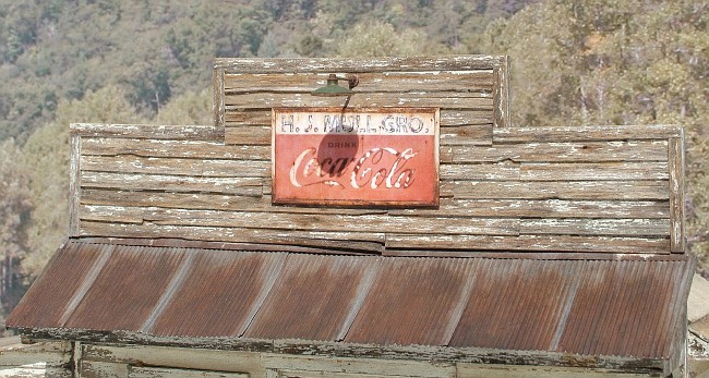

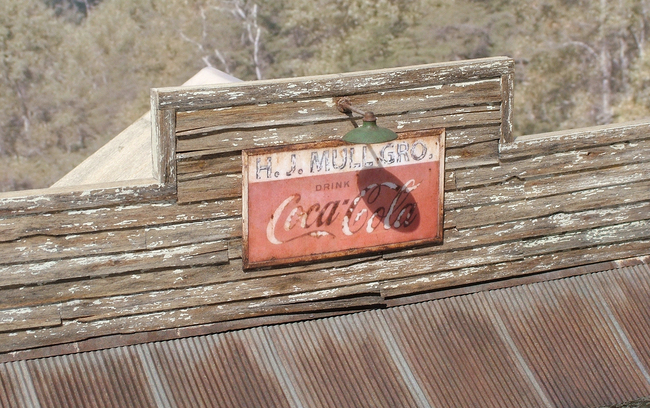

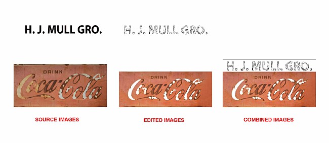

I added a light and the front sign for my store. I found a nice large weathered straight on view of a Coke sign on the internet and imported it into Photoshop Elements to resize it and brighten and clean it up a bit. I then opened a Word document and found a nice type font for the name and typed it out. I saved the document as a PDF and then saved that to a JPEG. I imported the name image into PSE and weathered it with brush strokes to simulate a faded brush-painted sign. I then combined the two edited images (name and Coke) in a Word document and did the PDF to JPEG thing to create a single unified image. I cropped the final sign image and imported it into Word, sized it for my sign (5/8” x 1 ¼”) and printed it onto Epsom presentation paper.

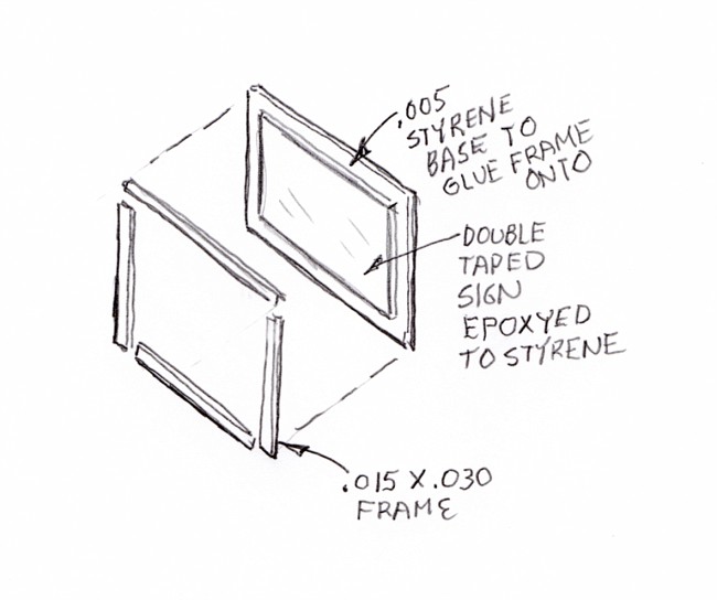

I took the printed sign and burnished Scotch Magic tape over both sides, and then trimmed it to final size around its edges. I epoxied it to .005 styrene and soda blasted it to dull the surface of the tape. I then added additional fading and weathering with gouache and Bragdon powders. I carefully butted .015 x .030 styrene strips up to the image edge and attached them to the .005 styrene sheet with Testor’s cement to create the “metal” frame. I then trimmed around the frame to finish the sign. I sanded the face of the frame smooth and weathered it with powders N gouache.  A final light soda blasting unified the weathering.
I made full page width images in Word so the shrunk down image would be crisp. Of course this requires a large source image which I fortunately had. I used an Epsom dot matrix printer, best photo setting, presentation paper setting, and I turned off the high speed setting to get the best printed image. For weathering reference, both Flickr and E-bay were good sources for old Coke sign pics.

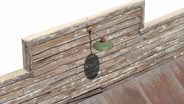

The light shade is a brass stamping from the scrap box. I turned a cap and a mounting bracket from styrene and attached them with .02 wire. The brass was blackened and then painted with thinned Polly scale white (underside) and green gouache and weathered with powders. The mounting post was weathered to represent an old galvanized finish.

Well, sh*t ... there I was enjoying that nifty, realistic, clever new sign ... then I get to the last photo and see that some bugger has already stolen it.  Nice while it lasted!  Grin  -- Dallas

If you had Photoshop you could have chosen the Type tool, picked your font from the drop down list, and added it to the image (after enlarging the "canvas" size). It would have been unnecessary to go to Word, save the text first as a PDF, and then to re-save it as an image file.
Note to everyone: Never save an original image as a JPEG. That format is only for use on the Internet. It is destructive; it adds artifacts and removes important image data. Save as a TIFF or BMP or any other uncompressed format. Then, if you must have a JPEG for some reason, save a copy of the TIFF image as a JPEG.
Similarly, you could have sized the final sign and printed it directly from Photoshop (with much more control over the printed image) instead of importing it to Word for that step.
I've never used it but maybe Photoshop Elements would allow you to do one or two of those things.

Thanks All! Yes Russ I am still a bit of a caveman with image stuff. Thanks for the information. I suspect PSE can do a lot of this; I am still learning it and the Word process is quick though apparently destructive. I also print a bunch on a sheet so I can choose the best one that prints.
