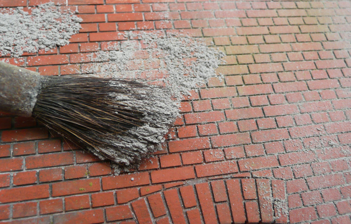

For this I sprinkled some edges that were the "rain" exposed to a mixture of greenish vegetation remnants powder. Then a gray tile mortar from the hardware store came to use. For one, he fills the gaps better than the color pigments, on the other hand it is dusty and beautiful covers the stones with a milky - grayish layer.
Alter_Lagerschuppen_198 (fspg2)
Alter_Lagerschuppen_199 (fspg2)
As the stone surface is not abrasive at the moment, the appearance can be easily variieret by using kitchen paper or fingers (use rubber gloves).
Finally, I sprayed everything with a varnish that does not darken the original color after drying.
If I don´t like it, a new layer comes...

The best experience I have done with dry dusting. Finally, I give a mixture of "landscape construction adhesive"  vanish with a small flower-vaporizer. A mix in 1:12 - to 1:15 with water is sufficient.
This glue is here available. It has the advantage that it doesn´t becomes darker after drying (in opposite with mix of wood glue + water + dish soap) . Moreover, it can still subsequently be treated with stains, because it does not seal the surfaces.
