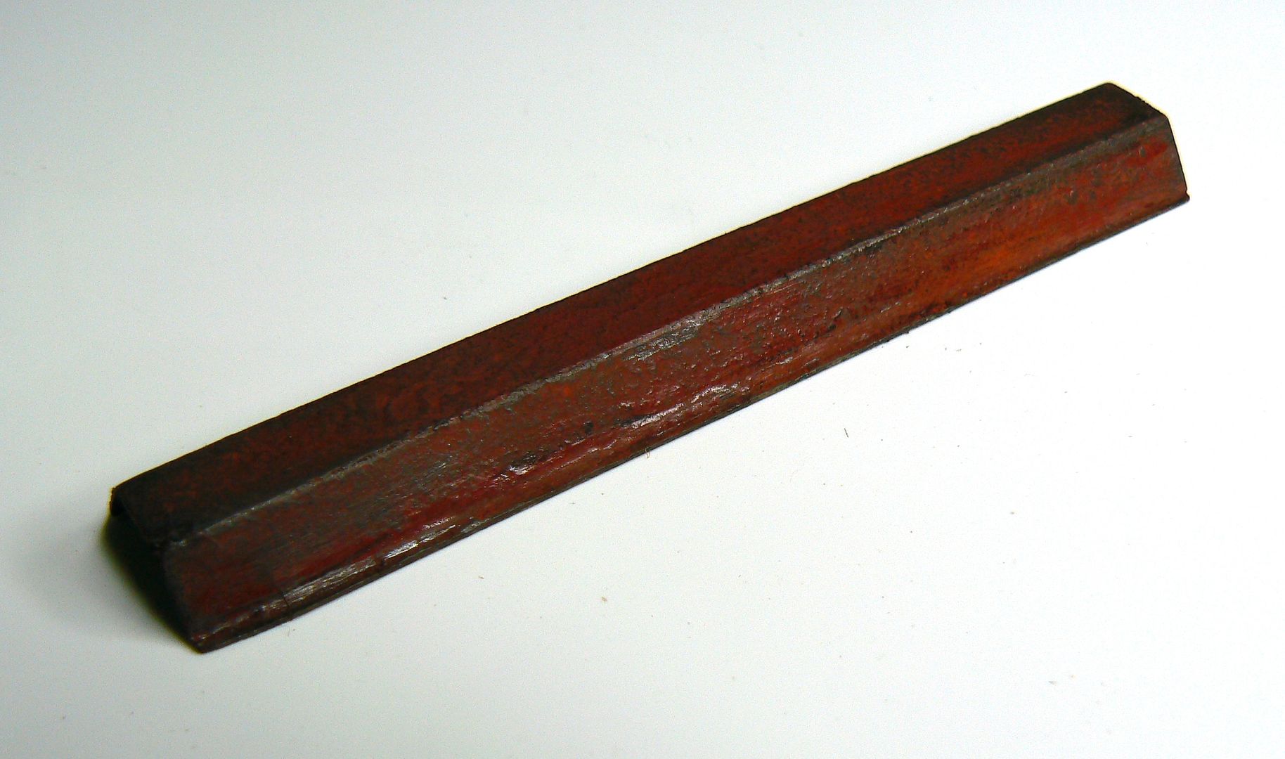

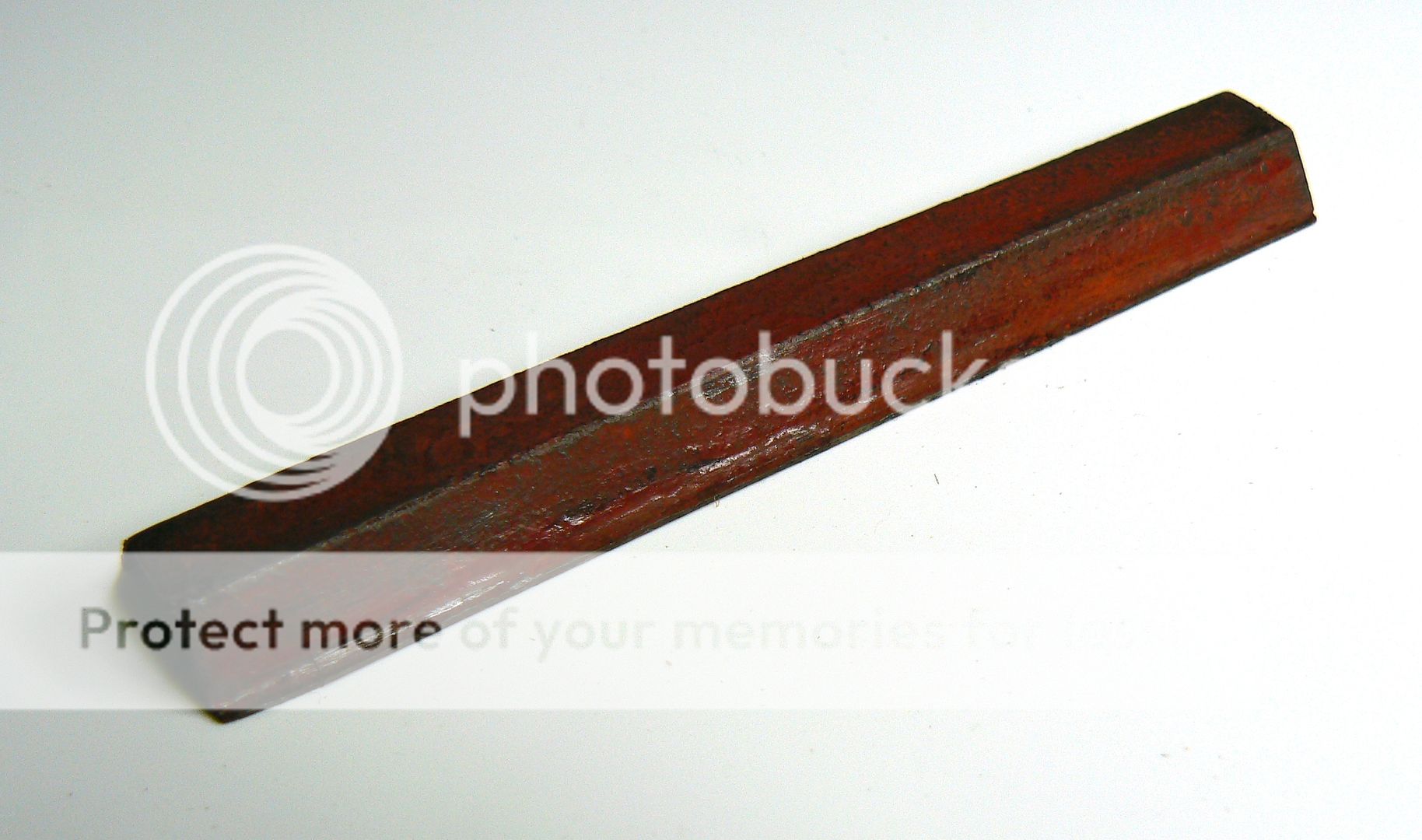

« Reply #51 on: May 29, 2011, 03:47:35 AM »
Gordon...who me!?...sarcastic!??.....actually it was just a CYA (Cover Your A**), in order to pre-empt your question as to why there was green stuff on them Wink Grin
So, the guys in the shop felt sorry for you, and decided to go against my instructions, and went and did a short gutter test piece....as I understand it it was made from some unobtanium....which turned out to be Clearprint 1020H Drafting Velumn,.......that was formed around a .156" styrene rod (this comes out to be a 5-1/2" half round gutter with 1/2" beading), then hardened with a light coat of ACC on both sides. Painting done with Vallejo acrylics, pigments and guache.
Top view:
Underside:
I still need to mess with the approach and shaping a bit and take more care when handling, so the beading doesn't seperate like it did here (though I have seen this rust out like that on an old gutter Grin ) This one is also a bit over-weathered/rusted.
BTW: the guys have been sent to a re-education camp, to see where their loyalty and commitment lie.
« Last Edit: May 29, 2011, 03:56:16 AM by marc_reusser » Logged

OK still being a pain in the A.... the beading I'm guessing you put on separately , micro-strip ?  ..... sorry just realised it must be paper for the comp.
I played around with a similar concept few months ago when making pressed steel sleepers
Sorry forget to say.......... great guttering, I like the texture the paper has given them
« Last Edit: May 29, 2011, 02:26:56 PM by gfadvance » Logged

« Reply #57 on: May 29, 2011, 02:14:15 PM »
I like the way the beading separated and, until I read your comment, thought you had done it on purpose. I also think the finish you achieved is outstanding and the couple of leaves you dropped into the gutter are a nice touch. Nothing in the photos suggests you used paper.
Once in a while I still detect a slight anti-paper bias and suspect that, no matter how superbly a model or diorama turns out, someone will think another material could have produced better results. My rather extensive research suggests that might occur when someone tries to pass off stained paper as stained wood but very rarely in other applications. I say that not just from my own experiments but from years of studying the world's best paper models.
If, on the other hand, someone were to argue that paper might not be the easiest or most efficient material to use for achieving a given result I might agree.
As I understand the purpose of this experiment, it is to prove paper can equal wood, plaster, clay, plastic, and metal for representing all kinds of textures at contest winning levels. My guess is that it will.
« Reply #58 on: May 29, 2011, 08:16:19 PM »
Barney:Thanks for the kind workd, and special thanks for those wonderful pics. So much to see in them. I probably will have to stick to simple strap-anchors for the rainwater leades...Luckily the prototype i am looking at used an interesting strap hanger system for the gutters as well...so it saves me having to do something decorative or doing center hung ones. Grin
Chester:
Yes, you are correct, they were ment to be galvanized or bonderized finish, and the outside should have weathered a bit lighter....was having issues thith getting a proper light galvanized look under the old rust...I need to go and read Chucks technique.
Gordon:
I hate to fess up, but the model will likely be 99.98% paper, as I need to use some brass rod in a few areas....the beading being one of those. The beading is appled and then blended .012 brass rod. this helps keep the formed paper from distorting/bowing too much. I figured it wasn't really cheating, as most of the part was from paper. Grin
Russ:
I wasn't  necessarily shooting for contest level, but rather just to prove to myself that I can make paper look as good as a decent quality model built from the usual variety of materials....and to disprove the general notion/opinion that one can readily tell if a model is made of paper. The wood doors will definitely be the crux, but I have some ideas on how to work around this by adapting the design and detailin. I am finding that a large part of working with this material is picking your details carefully, and knowing how to address parts that are difficult to represent, without sacrificing overall appearance. (IE. instead of making/showing the split out door bottoms, maybe hiding the majority of that area with a steel/metal kick-plate...possibly chipping rusty sheet metal, or part of an old advertising sign...something that still gets the mood across, but will not reveal the shortcomings of the material [or my skill]. ).
