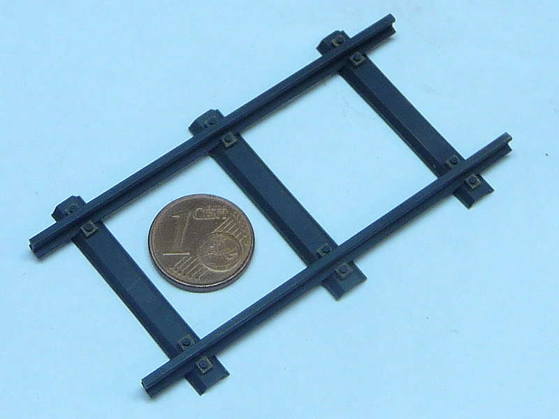

Meanwhile, I've been tinkering and would like to present the results here.

Even on my boots so I Wascher busy with roof sleepers.
Etched as part of the roof threshold
Connection via terminal plate with screws and nuts M 0.6, of course electrically isolated.
Roof sleeper track from below.
Roof sleeper track with coin for size comparison.

Posts: 4114
« Reply #42 on: August 25, 2011, 12:12:09 PM »
Wow, that track is put together just like the real thing!
