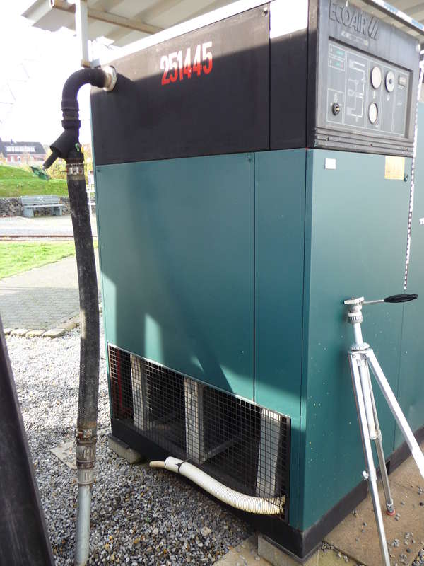

Here, the compressor station next to the shaft can be seen, and as it will be also on my model.
Here is another recent picture of the now displaced, modified compressor station.

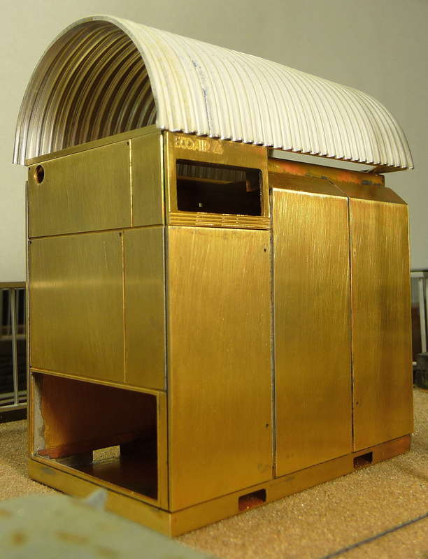

So I resorted to the tried and tested for my material metal back and already with some cutting and bending, I could solder the station with the help of some brass scrap strip the model together.
The roof was made of an aluminum offset printing plate.

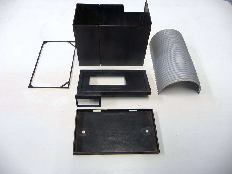

Here is a photo of the items.
By separating in assemblies of different colors, it is now easier to perform the paint job.

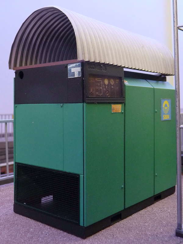

Meanwhile, the compressor has received the first color.

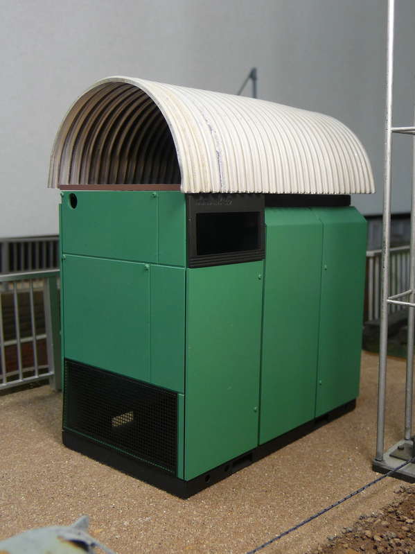

Meanwhile, other small parts are as signs u.s.w. added.
Watching are actually not all, since they are later on the back of the viewer.
Helmut, You may have started modeling the compressor in plastic, then changed to brass, but your work looks like solid gold to me. Not only do your models look good and accurate and highly detailed, they are also sturdily constructed.

Holy cats, that sure looks great! Hard to tell it's not full-size.
The brass model is gorgeous!!!!
