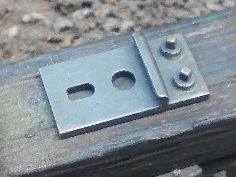

Hello,
I have long ceased to report from my mine ..
But I wanted to do with my railings on.
For this I needed such a mounting bracket as handrail support.
Thanks to the proven magnetic tapes taking measurements is not a problem.
In addition, a few sketches with dimensions and the Self is nothing to prevent more.
Here is the mounting bracket for fastening the rail stanchion.
Originated from 4 piece brass milled parts.
The length is 13.3 mm or 0.525 inch.
Otherwise, I've worked a long time on the electrics to fit the operation to IPad with DCC to.
« Last Edit: May 12, 2014, 11:20:09 PM by Design-HSB » Logged
