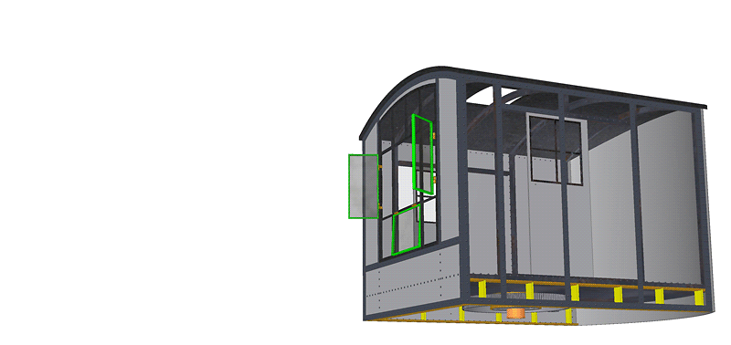

Yesterday my router has to work hard.
Thus, the hinges and the moving window frames made of 1.5 mm Ms58 were machined first.
Münzel-Kran_018(fspg2)
The crane has been modified a little bit. The lower U-profiles are no longer visible from outside. They are masked by the deep-drawn sheet metal.
Münzel-Kran_017(fspg2)
Since my 0.5 mm Ms58 material had gone to an end and I could not get new timely, instead German silver (Neusilberblech) was stuck with a wafer-thin double-sided tape on a MDF board and placed under the cutter.
Münzel-Kran_019(fspg2)
The German silver can not be milled as good as Ms58. So I had to adjust the feed rate much slower. Also was greased with a few drops of oil.
Münzel-Kran_020(fspg2)
0.15mm deep marks were placed with a small V-Cutter. So I could put the rivets very accurately with the embossing machine later.
After the vacuum cleaner and a little bit of crepe paper had removed all the dirt, I was able to lift the rivet bands with a thin cutter blade from the board and rub off the adhesive tape.
Some rivets had to be set from the back side directly into the walls (they have no external rivets band). In addition I have milled 1mm deep pockets in the MDF board. All milled walls of the crane house were placed with the outside face down in his pockets.
Münzel-Kran_021(fspg2)
Now the router could set the markers very easily.
In addition to the markers I used a rip fence, so as not in the heat of battle, the rivets can dance to it. Nothing is worse than when the last rivet is set incorrectly. Wink
Münzel-Kran_022(fspg2)
In the exterior walls of all the pages I have milled a deepening of 0.25 mm for the rivet bands, which are soldered in later.
Münzel-Kran_023(fspg2)

Just before the start of the new year I wanted to solder some parts for the crane.
Once again Pertinax serves as gage.
Münzel-Kran_026 (fspg2)
The result: a subframe for the front and side walls of the crane.
Münzel-Kran_027 (fspg2)
This allows me to pull off the walls like a shoe box from the bottom board in case of service. The whole mechanism will be on the baseboard at a later date.
Münzel-Kran_028 (fspg2)
A happy new year to all of you!
