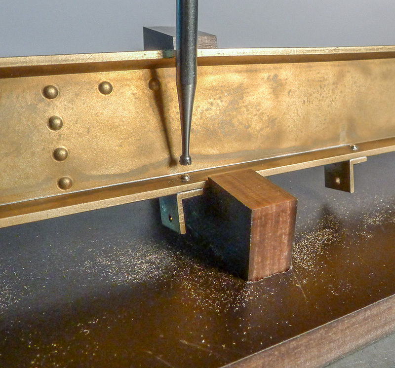

@ Russ, Ray, Allan, Bill  Thanks for your recognition
@Volker
Quote
Which speed did you chose with the cutter? I know they work well with hand tools but what not aware They fit for machining, too.

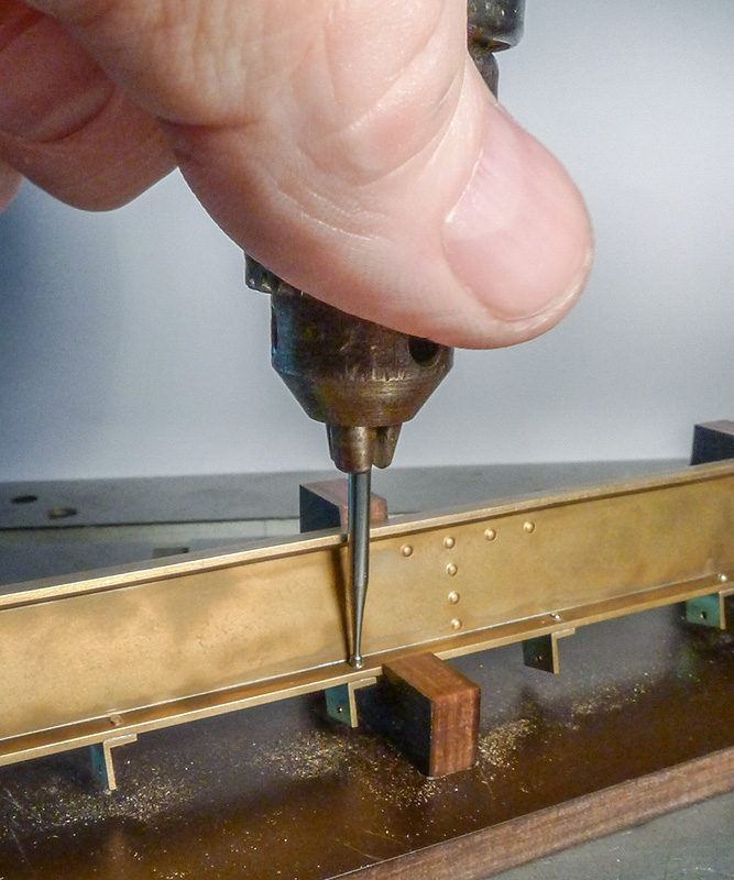

Yesterday I got new „Finier“cutter (TwinCut). Now the results are much more better.
The „Finier“cutter is described here .
recommended speed: 2500-7000 rpm
speed range: max. 20,000 rpm

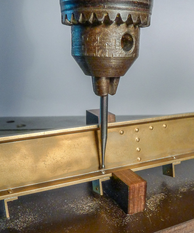

I used the drill stand and the Pertinax gauge only for vertical alignment. For accurately positioning I´m using a headband magnifier!
Halter_Finierfraeser_05 (fspg2)
The engine is not running - the chuck I rotate with my left hand - felt 10 RPM. With my right hand I can regulate the height varies slightly.
Halter_Finierfraeser_06 (fspg2)
Halter_Finierfraeser_07 (fspg2)
Halter_Finierfraeser_08 (fspg2)

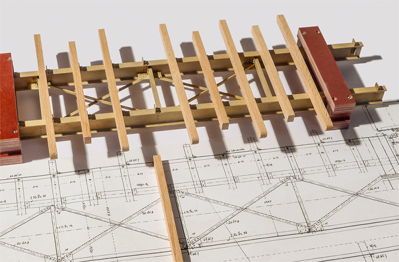

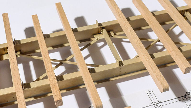

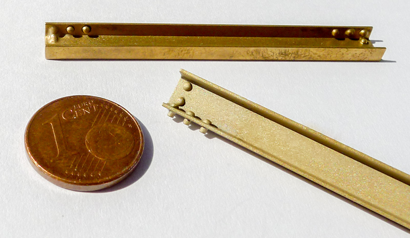

The 3x6mm U crossbeams had got 1mm holes already. My first attempt hard-soldering the rivets was not satisfactory. Although I used 0.5mm silver hard-solder wire sparingly, it was still too much.
Beng_Loetpaste_01 (fspg2)
left with 0.5mm silver solder wire  -  right with brazing paste
A friendly model builders gave me a great tip: brazing paste
So I put 1.5mm long rivets into the holes (a real game of nerves ... using 5 rivets .... 2 rivets landed somewhere around the room) ... and coated all with the brazing paste from the back. Then the flame fixed it in no time. The protruding shanks I separated at my small Böhler saw and I smoothed all surfaces on a sandpaper board..
Beng_Loetpaste_02 (fspg2)
above with 0.5mm silver solder wire  -  below with brazing paste

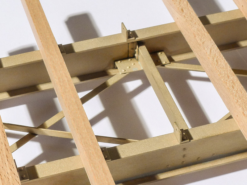

The first long beams were combined with the casted gusset plates and the small vertical angels of brass.
Knoten_A-Gussbaum-neu_010 (fspg2)

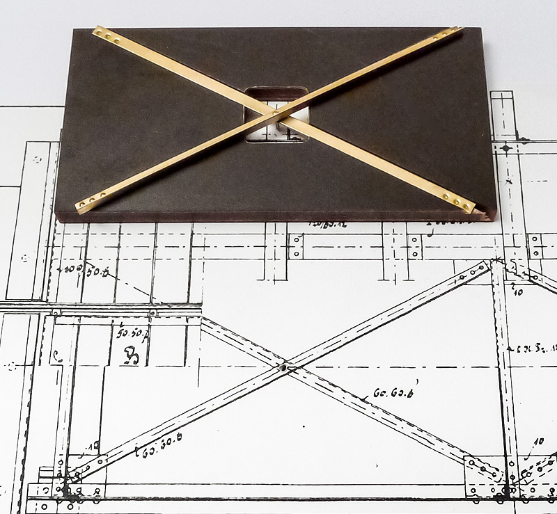

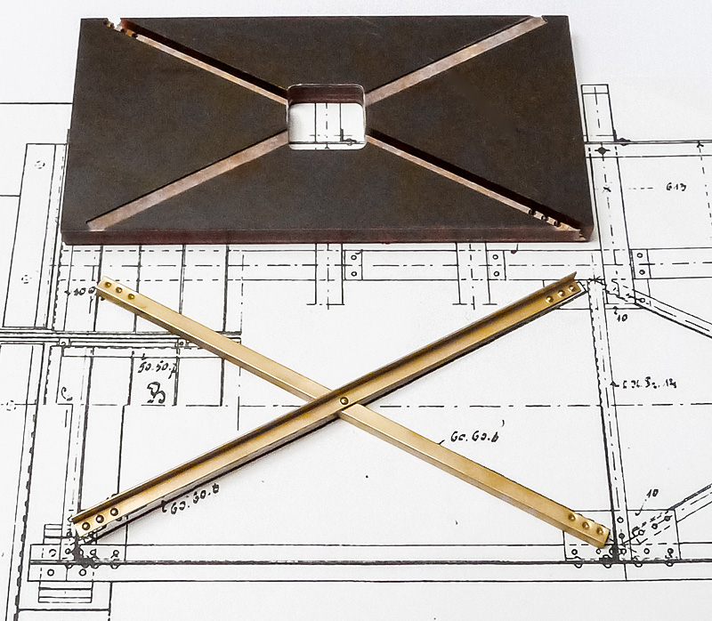

The diagonal braces were center marked in a small Pertinax gauge (similar here). So I can press the rivets positioned accurately.
Previously 3x3mm brass profiles were annealed with the flame. Thereby they were soft, otherwise the rivet heads could have been forced out.
At the first bridge I soldered four diagonal struts .... indeed, I need a third hand.
The solder tweezer came not as good to the right position. So I'm going to build new angled soldering tips.
Knoten_A-Gussbaum-neu_011 (fspg2)
Knoten_A-Gussbaum-neu_012 (fspg2)
Knoten_A-Gussbaum-neu_013 (fspg2)
Knoten_A-Gussbaum-neu_014_ (fspg2)
Ansicht von unten

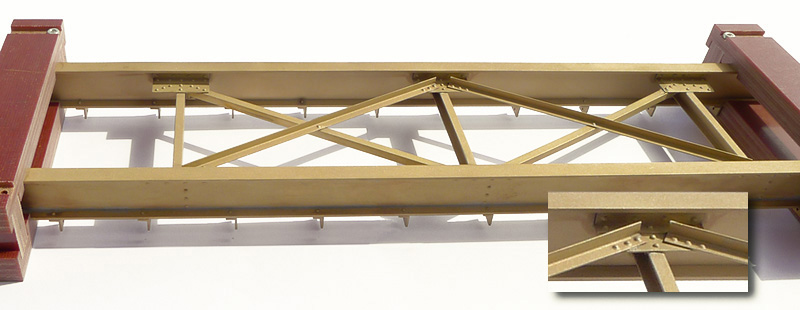

Coming a little bit faster to the target assembling the next 20 diagonal braces, I milled two small auxiliary gauges (again from pertinax).
The profiles got 1mm holes in the center.  It was soldered with an 1.3mm rivet (shaft 1mm) and an 0.4 mm shim . Now the profiles joint in an exact angle of 57.49 degrees.
Knoten_A-Gussbaum-neu_015 (fspg2)
Knoten_A-Gussbaum-neu_016 (fspg2)
diagonal braces view from bottom side

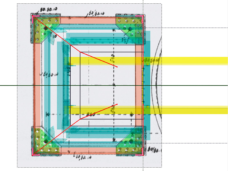

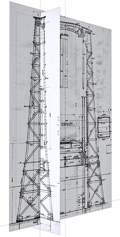

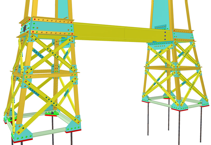

Up to now I was concerned with the 4 subbridges, but now the beams of the main bridge shall be prepared.
Traeger_Montage_20 (fspg2)

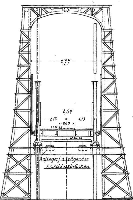

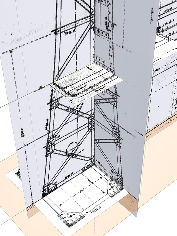

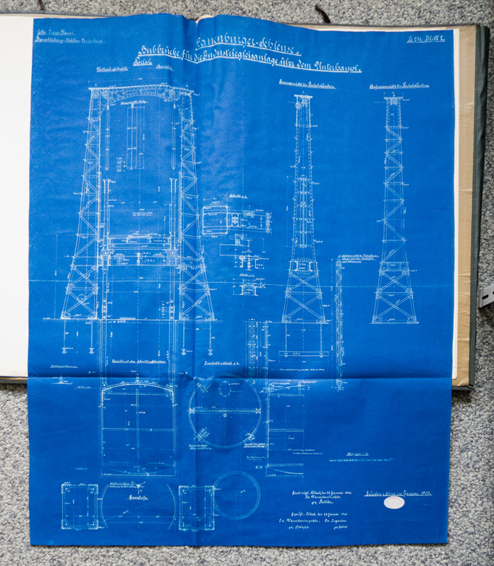

Since the original drawings were photographed very wavy, you can see mistakes especially at the top end.
Hubbruecke_Portal_1 (fspg2)
Copyright: WSA-Lauenburg/Elbe
Traeger_Montage_Grundskizze_frontal_1 (fspg2)

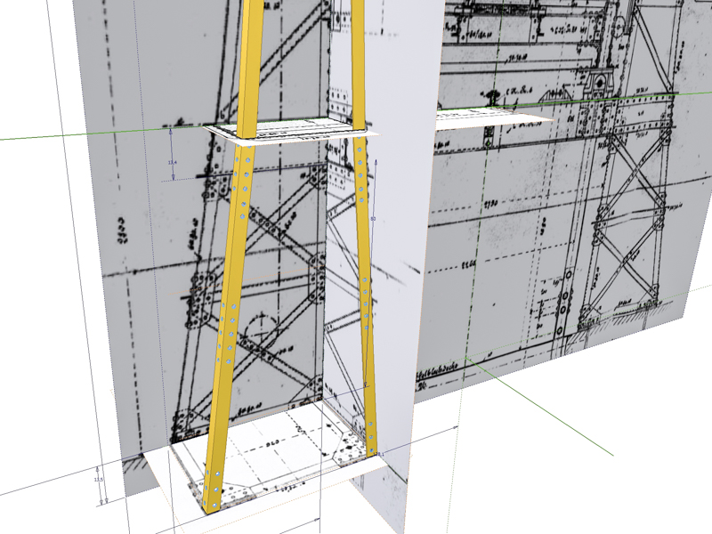

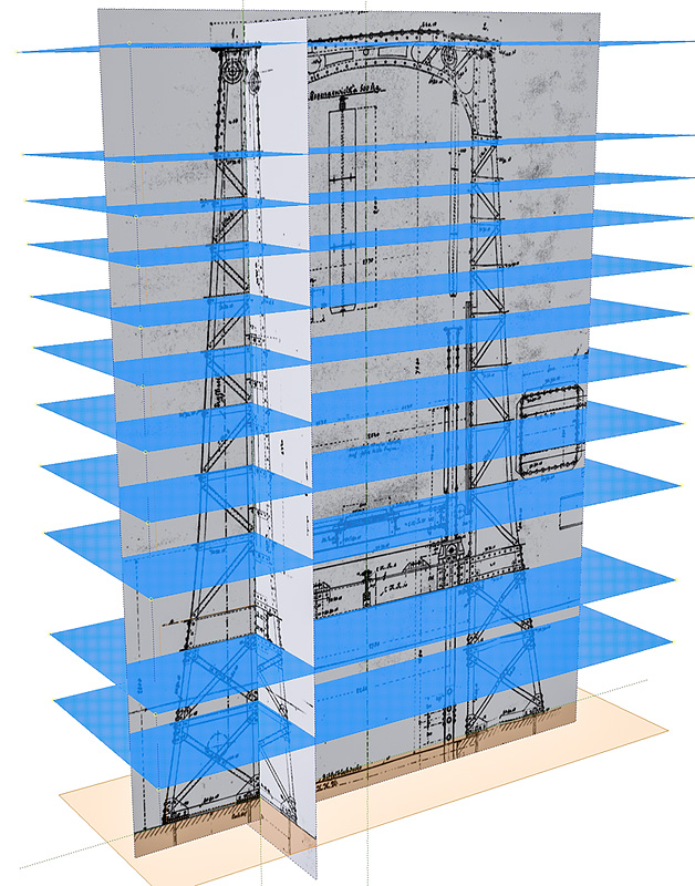

With Photoshop I could compensate some inaccuracies in the vertical and horizontal scaling individually. The original dimensions of the drawing have been converted to 1:22.5, then compared with the dimensions of the copy and adjusted if necessary .
In this way prepared I composed the drawings in 3 levels.
Traeger_Montage_Grundskizze_3D_01 (fspg2)
Traeger_Montage_Grundskizze_3D_06 (fspg2)
Traeger_Montage_Grundskizze_3D_05 (fspg2)
The blue intermediate layer characterize the position of each angle section.
Traeger_Montage_05 (fspg2)
The blue lines mark the location of the corner profiles.
Traeger_Montage_06 (fspg2)
In the following animation the procedure can be seen:
Traeger_Montage_00 (fspg2)
Traeger_Montage_15 (fspg2)
Traeger_Montage_17 (fspg2)

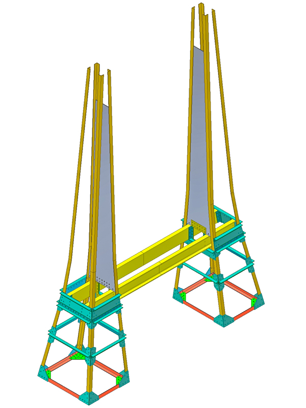

The holes in the sheets and profile angles will pick up rivets later. I think it will give more stability - even if I have a lot more effort.

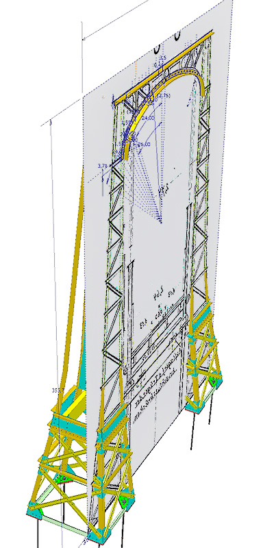

At the drawings I have read the dimensions of the ground and the upper edges of the two outer corner profile bends, also the height between the levels. Then I converted it to 1:22,5.
Traeger_Montage_21 (fspg2)
By the help of a 3D sketch I connected the respective vertices. The four corner angle (red) I extruded in the height.
Traeger_Montage_22 (fspg2)

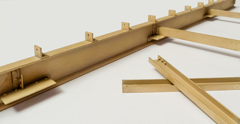

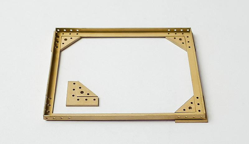

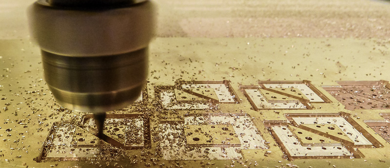

Although it is not really clear until now, how the angles of the corner profiles were made out with the prototype of 1900, I will use a milled and folded 0.4mm brass frame for the base. This ensures that all four sockets quickly obtain the same dimensions.
Bodenrahmen_01 (fspg2)
Brass MS58 can be milled better, but I have used MS63. Most dealers sells MS58plates from 0.5mm thickness only. MS63 is more soft and can be bent better. I milled with addition of cutting oil.
Bodenrahmen_02 (fspg2)
I annealed the sheets before bending. This ensures that the edges didn´t break (depending on the rolling direction).
Bodenrahmen_03 (fspg2)
In several steps the angle were bent. Thereby oblique grooves -  sawn in a beech wood slat - helps to bent the profiles.
From stage to stage the angle was inclined more and more until the result was reached. A brass block and a plastic mallet helped during bending.
Bodenrahmen_04 (fspg2)
Triangles made from 1.5mm brass MS58 serves as base feet.
Bodenrahmen_05 (fspg2)
Bodenrahmen_06 (fspg2)
This 16 feet and the four frames are only a small step until the completion of the bridge – As you know, the way is the goal . Certainly it will take a few years until I'm done .
